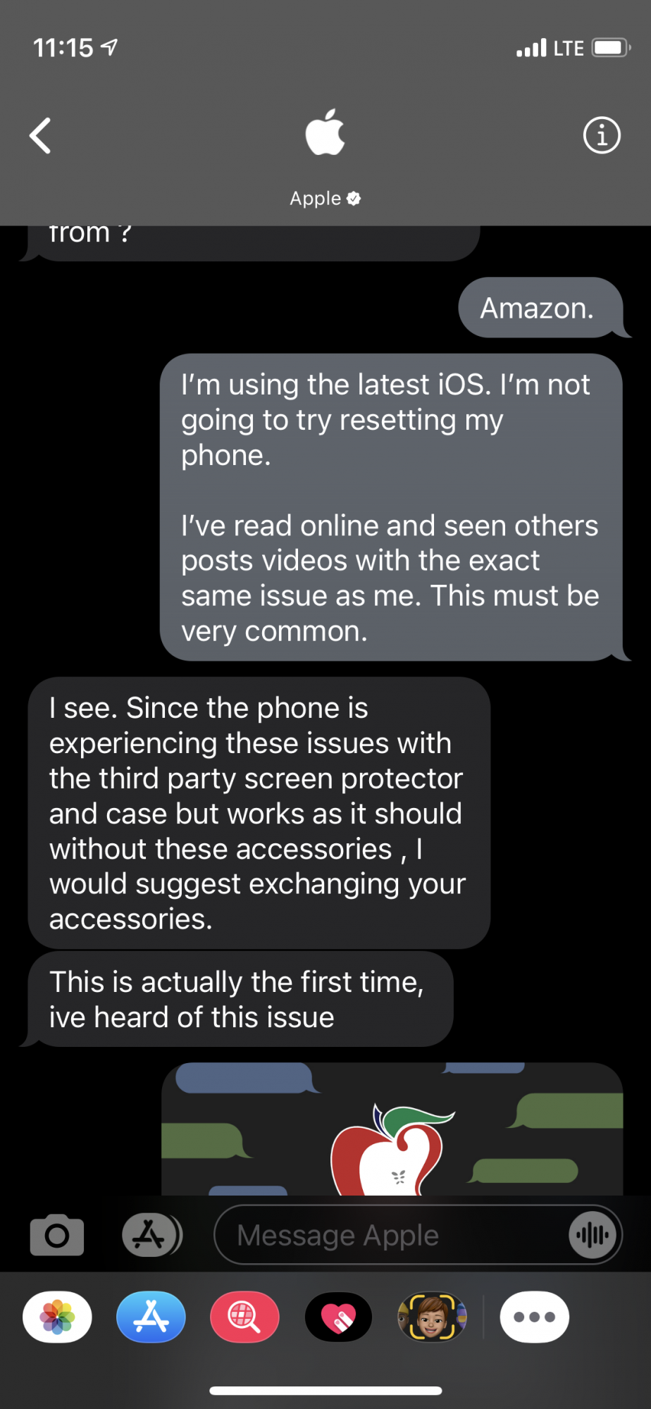

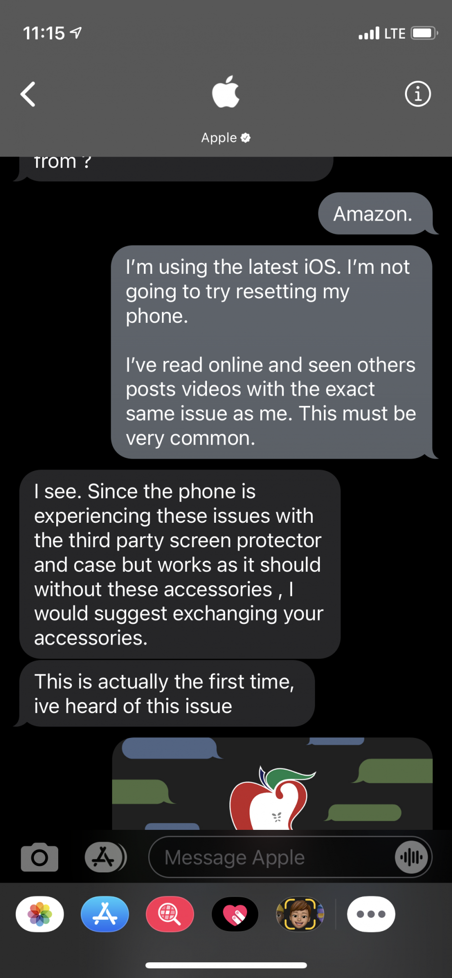

I just chatted with apple support. The rep told me that they had never heard about this. See my screenshot. I sent links forms and google searches. They told me to replace my phone. Nope. Not doing that. View attachment 1671030
According to what you just posted, the support rep suggestion replacing the third party cases, not the phone. And it is possible that specific rep has not seen or logged complaints related this problem.
