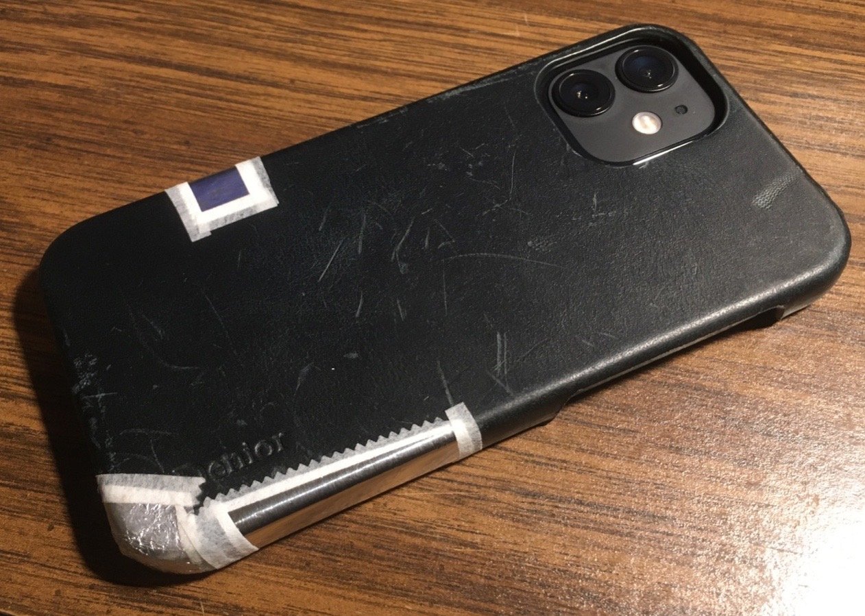

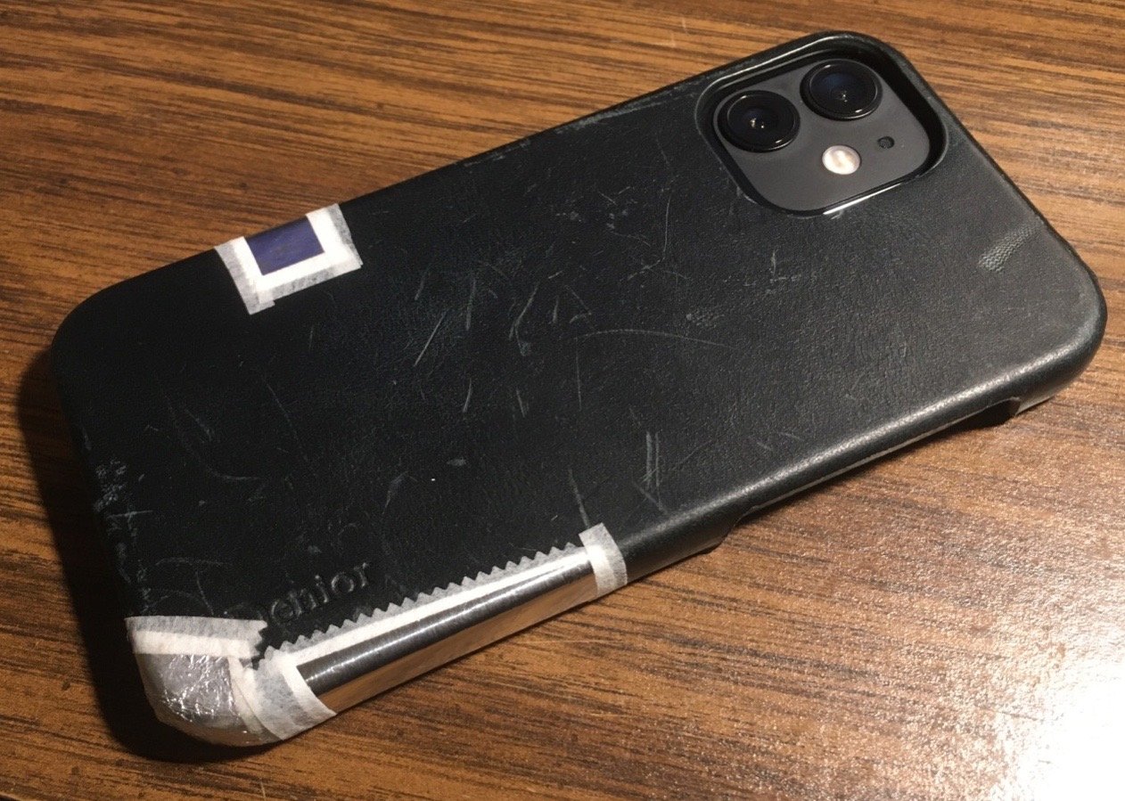

Aluminum foil gang. 100% fixed the problem.
I would advise that you not cover the mmWave port or the antenna gaps.
