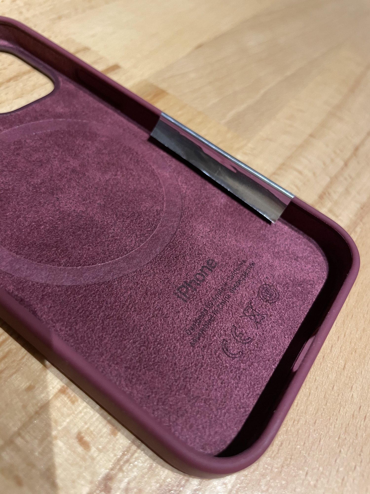

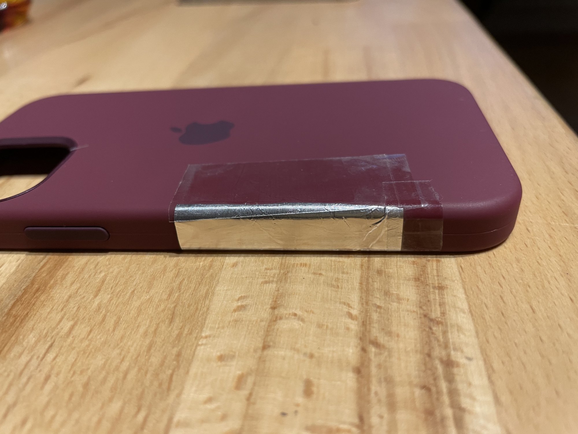

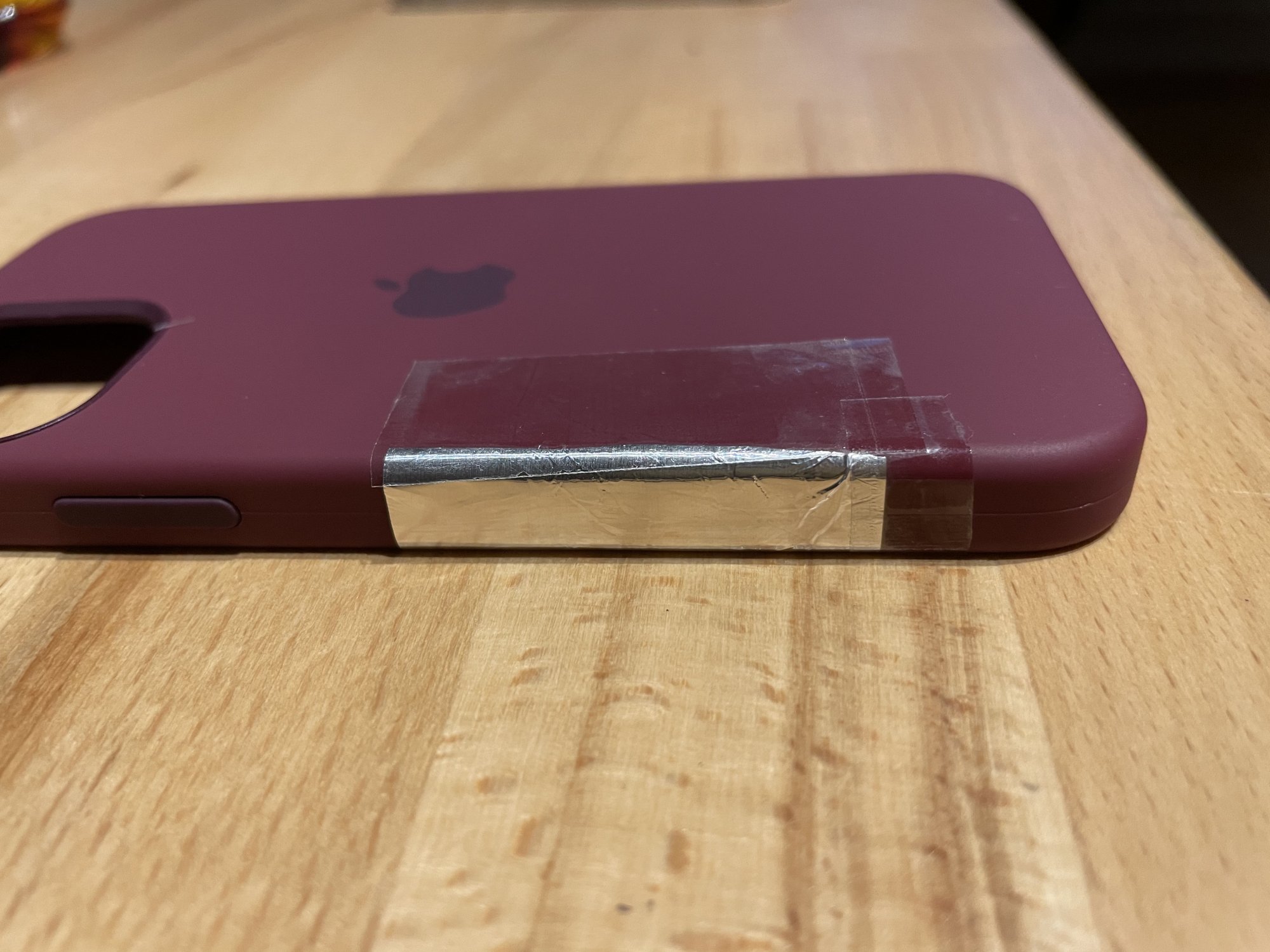

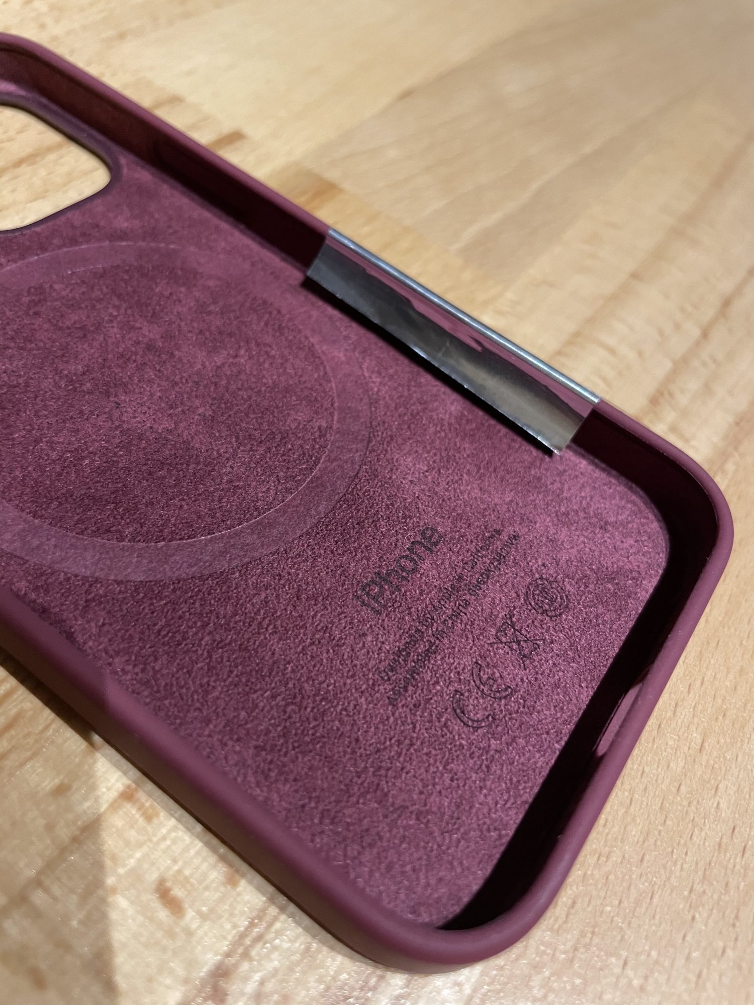

I did fix this issue for now (until Apple fixes the software) using a piece of tin foil and some tape.
Ugly, but it works!

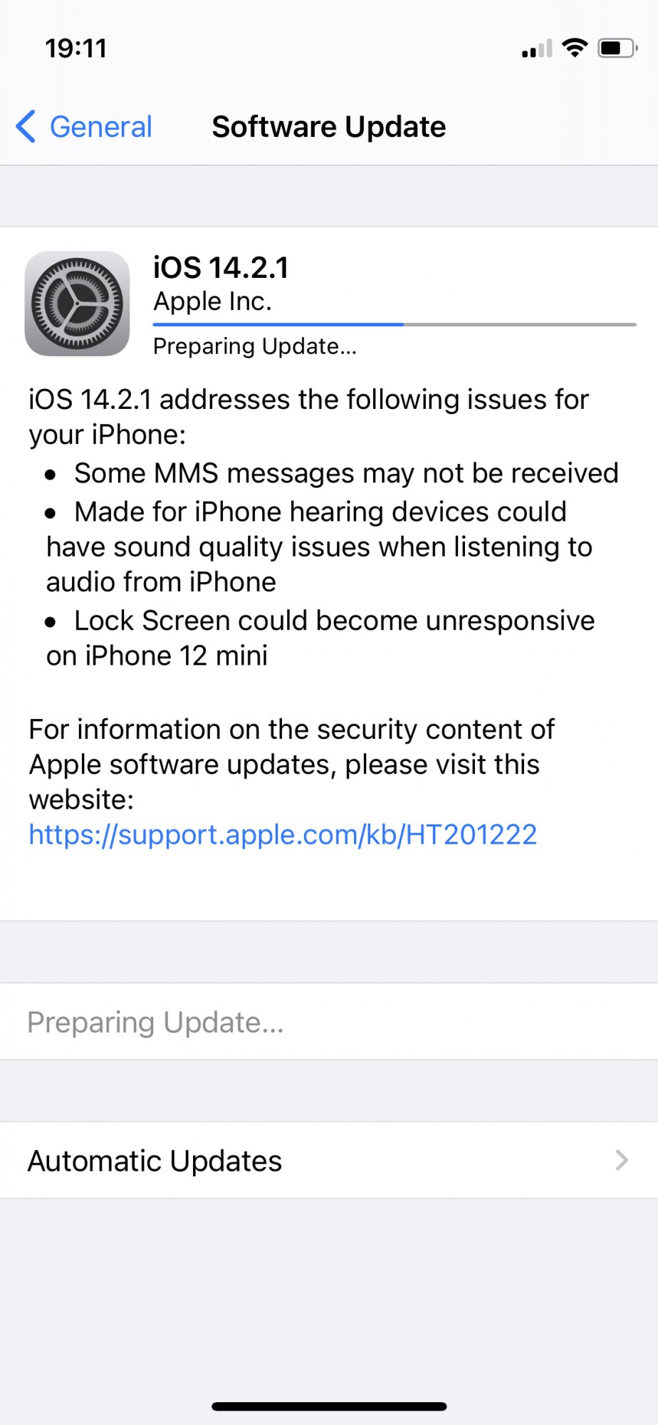

Just got here to check the forum and saw about 14.2.1. Love it when Apple justifies our trust. And it was a pretty quick fix too.
