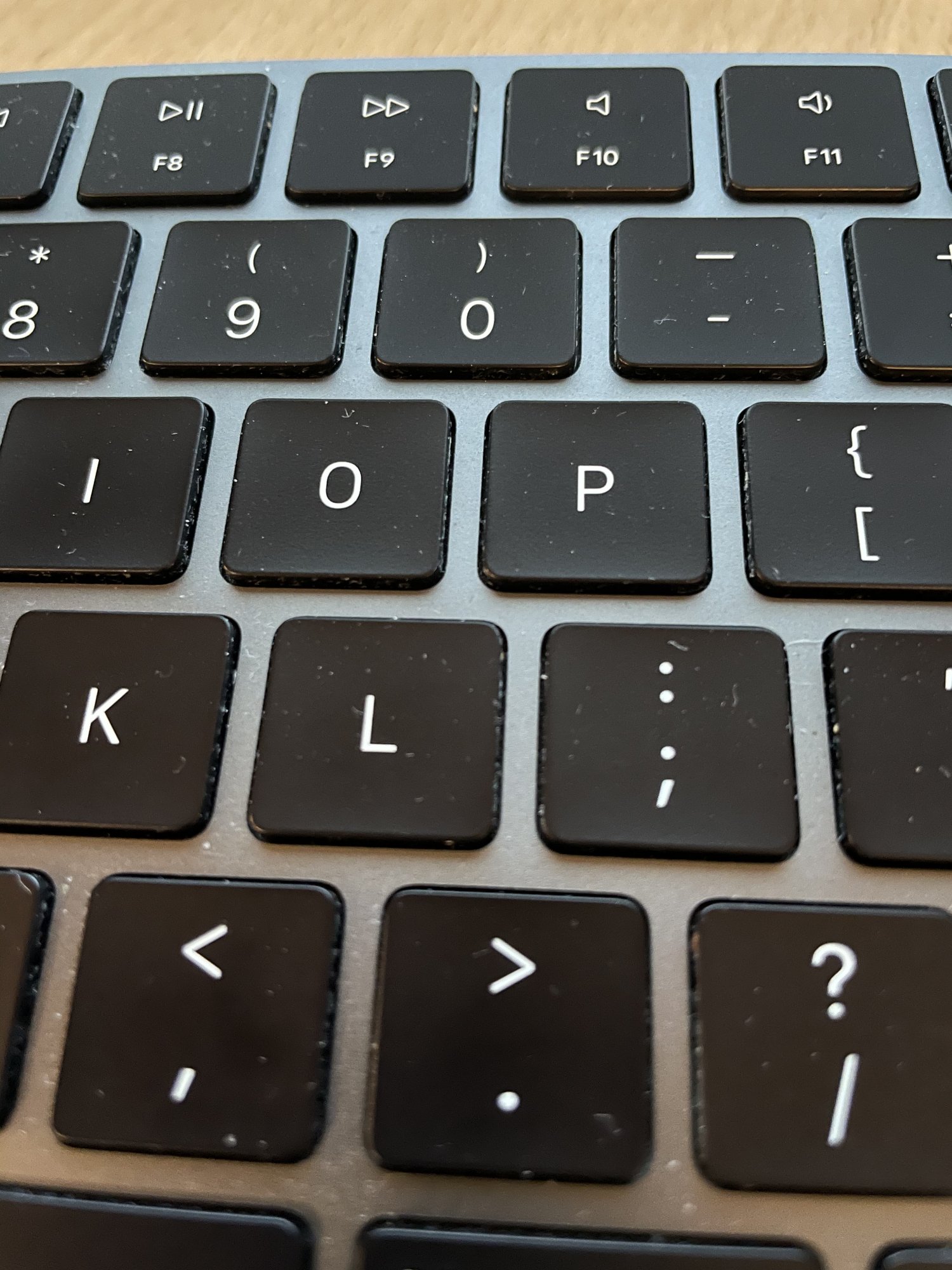

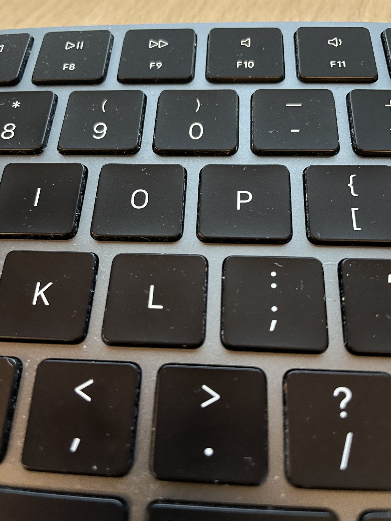

Hi, no problems on my 12 Pro, holding the phone 3 to 6cm distance to the keyboard...

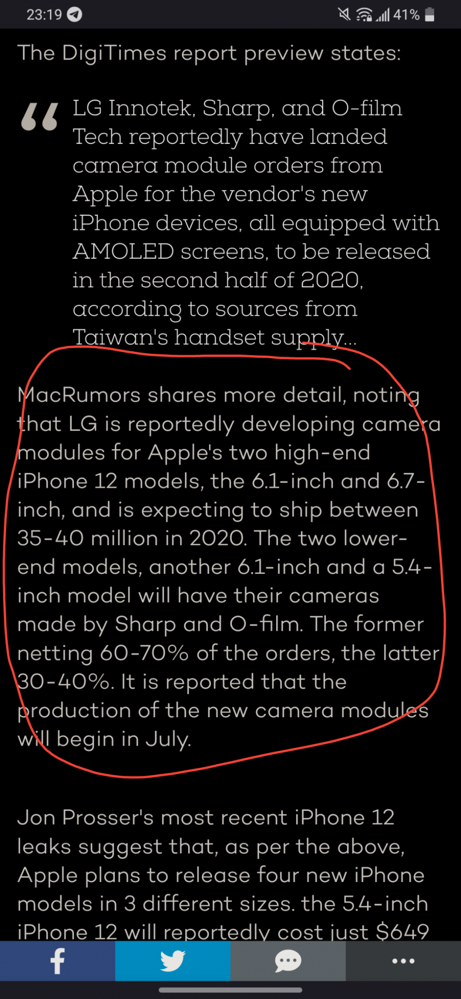

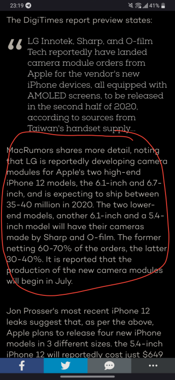

So after some research, LG makes the high end 12 pro max ones, wile o film and sharp makes the 12 and 12 mini ones. So this is a issue between these 3 suppliers, but I doubt it's LG. Maybe that o film... Anyway, there you have the camera lottery... 😂 😂 😂 😂
