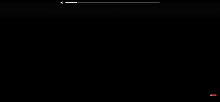

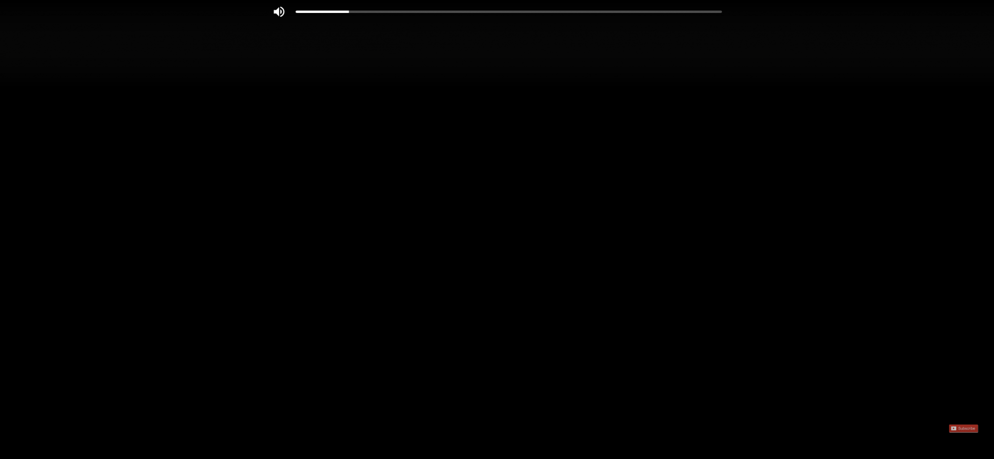

IMHO in youtube the green stripe when changing volume is a software bug, because you can take a screenshot of it.
