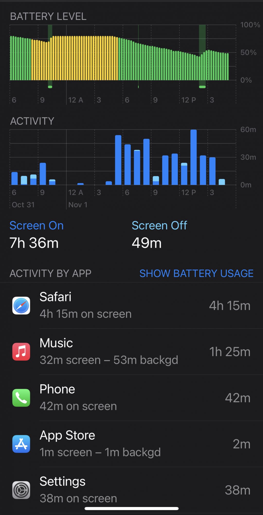

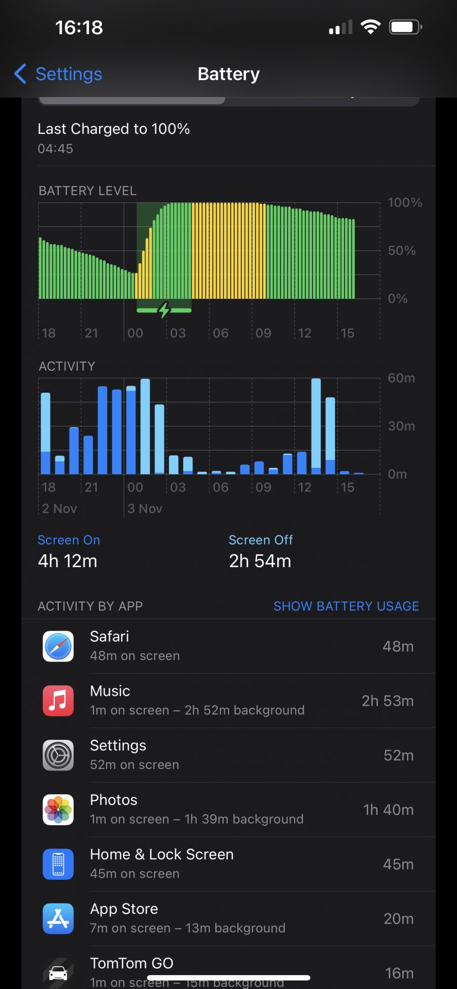

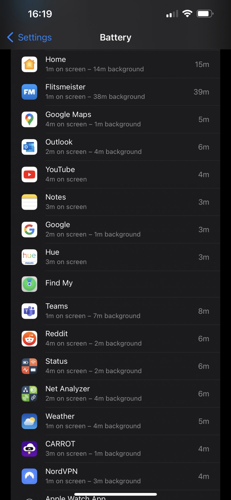

See my attached screenshot, one day I had 12 hours, but that was 6/7 background stuff so screen off. Usually most of the days before Saturday where with 50% screen off (Apple Music, Homekit activity, find my).
Also my phone is not getting hot or warm.
I do get a lot of notifications, but usually I leave my phone screen downwards so the screen doesn't lit up.
If anyone has another idea instead of starting scratch or contact Apple please do. Also I might need more patience and let it work it out after I did the reset all settings yesterday.

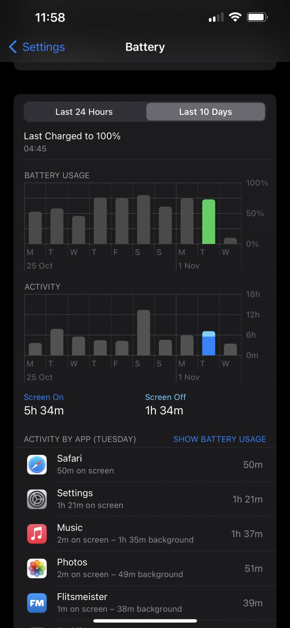

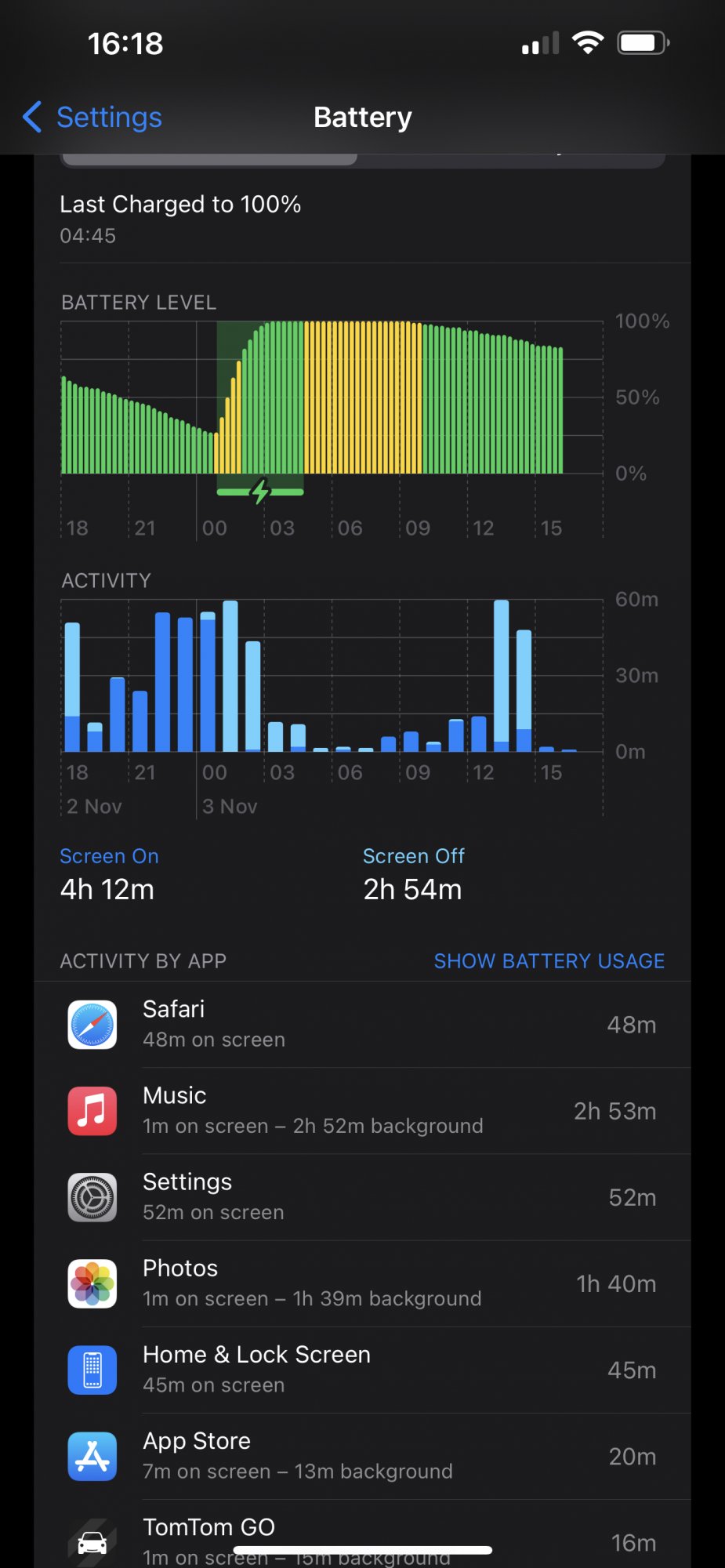

Post your 24 hour battery usage chart shoe the app times below with “SHOW ACTIVITY” selected. Want to see app times not percentage.

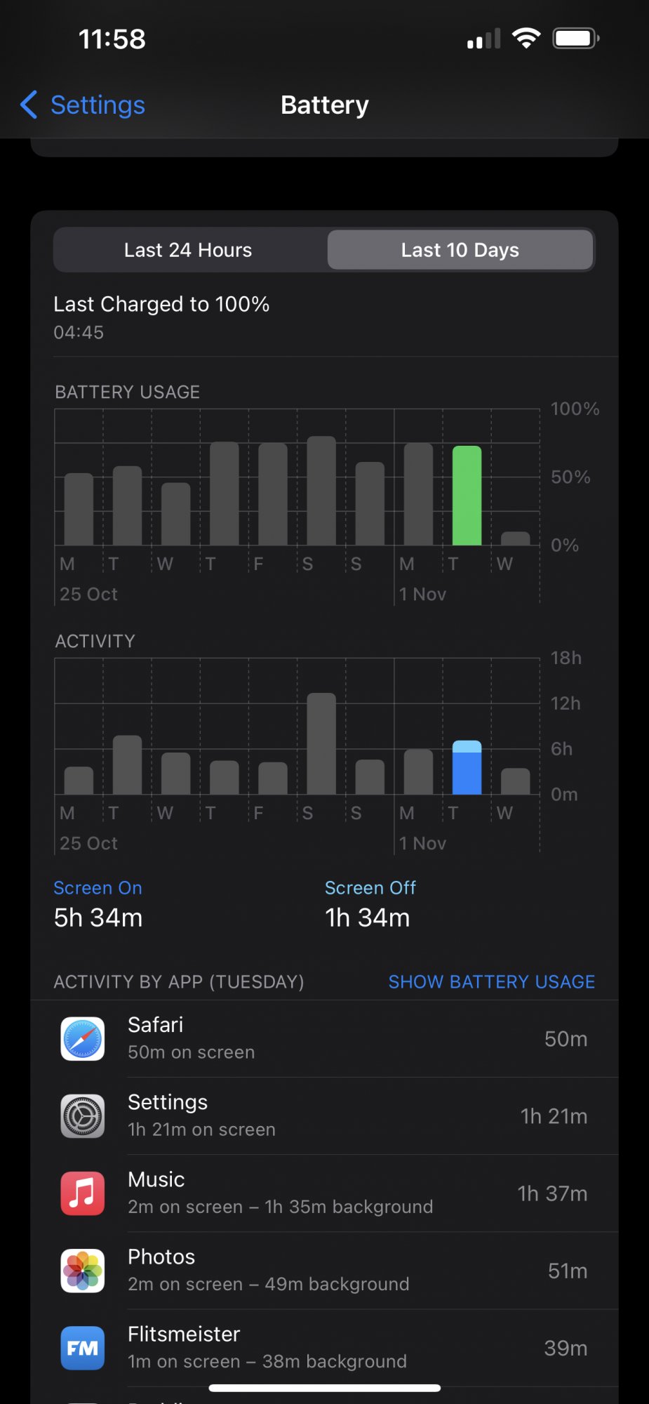

Will post my last 24h but today looks better, might that my changes yesterday and the full reset 1,5 day ago is working.. We'll see... I did speak with an Apple engineer, but his knowledge was less then mine and he only does a simple diagnostic which it passed. I do have an appointment with a store next week, thought it not the real Apple Store some authorized store not that fond of as they probably suggest to start from scratch. Just need someone who actually can analyse the analytics reports which I'm pretty sure they can't.

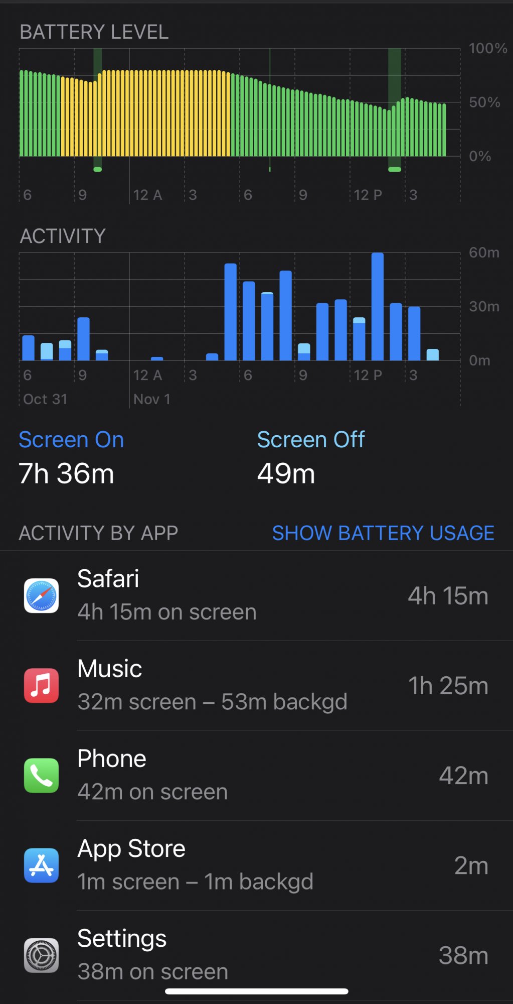

From the 24 hour battery chart, the first battery usage before you charged the phone, you got about 6:25 on 35% battery, estimate to 100% battery usage 18:20. The second battery usage after you charged your phone, 2:53 on 20% battery, estimate to 100% battery usage 14:25. This is insane battery life. If you last 24 hour is anything over 12 hours on 100% usage, I don't see an issue with your battery life.
Thanks, but for the first part I see only four hours. As for the second part 70 minutes SOT. But it seems to be improved after the reset all settings. I'm not a heavy user normally so I'll give it a few days now and see.
Did you add up the individual bars in the chart because that is what I estimated based on? If you are going by the screen-on and screen-off times, that includes on the charger and is a moving 3 hour window. And screen-off times need to be included as that also uses battery.
In standby you had about 10% drop in battery. And it looks like there is also big drops at other times as well. How long have you owed your 13 Pro?
