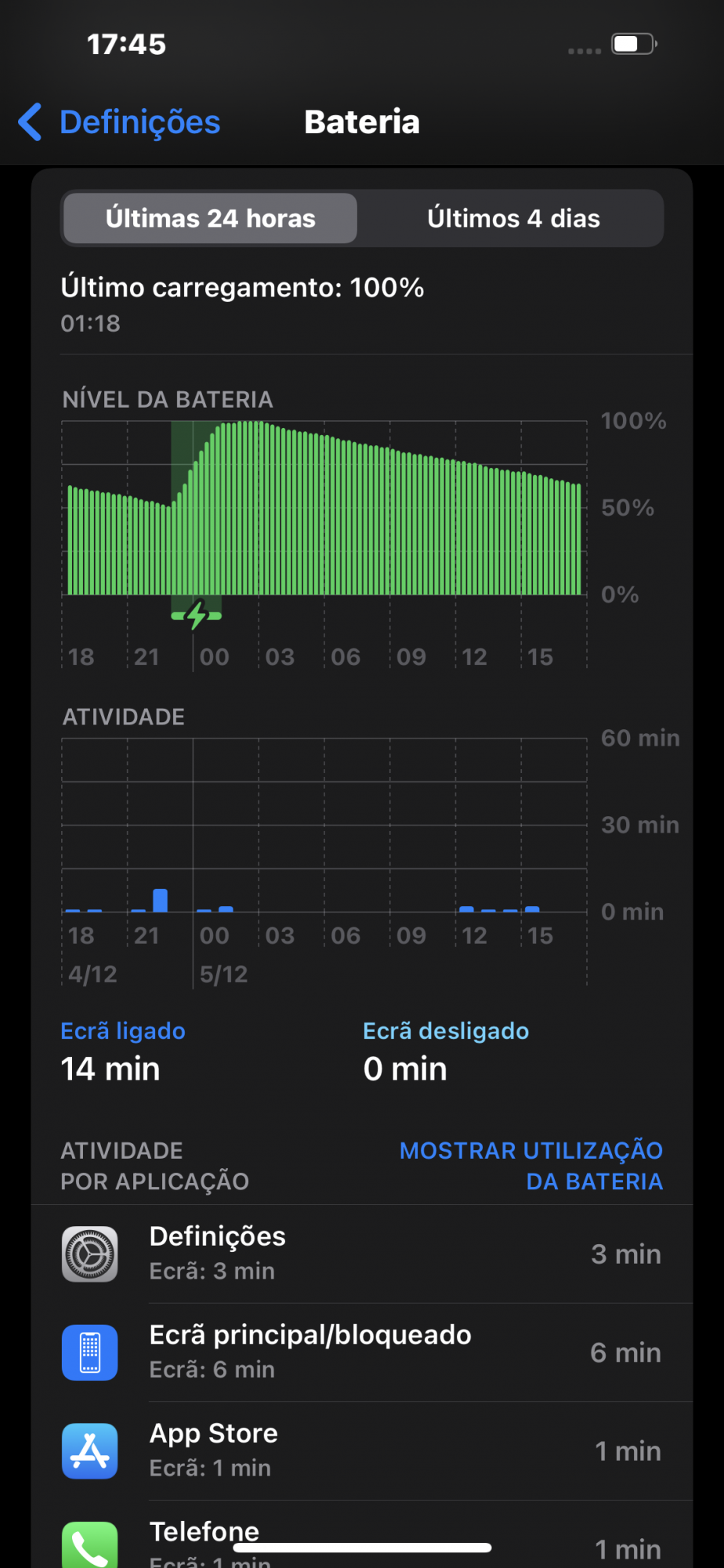

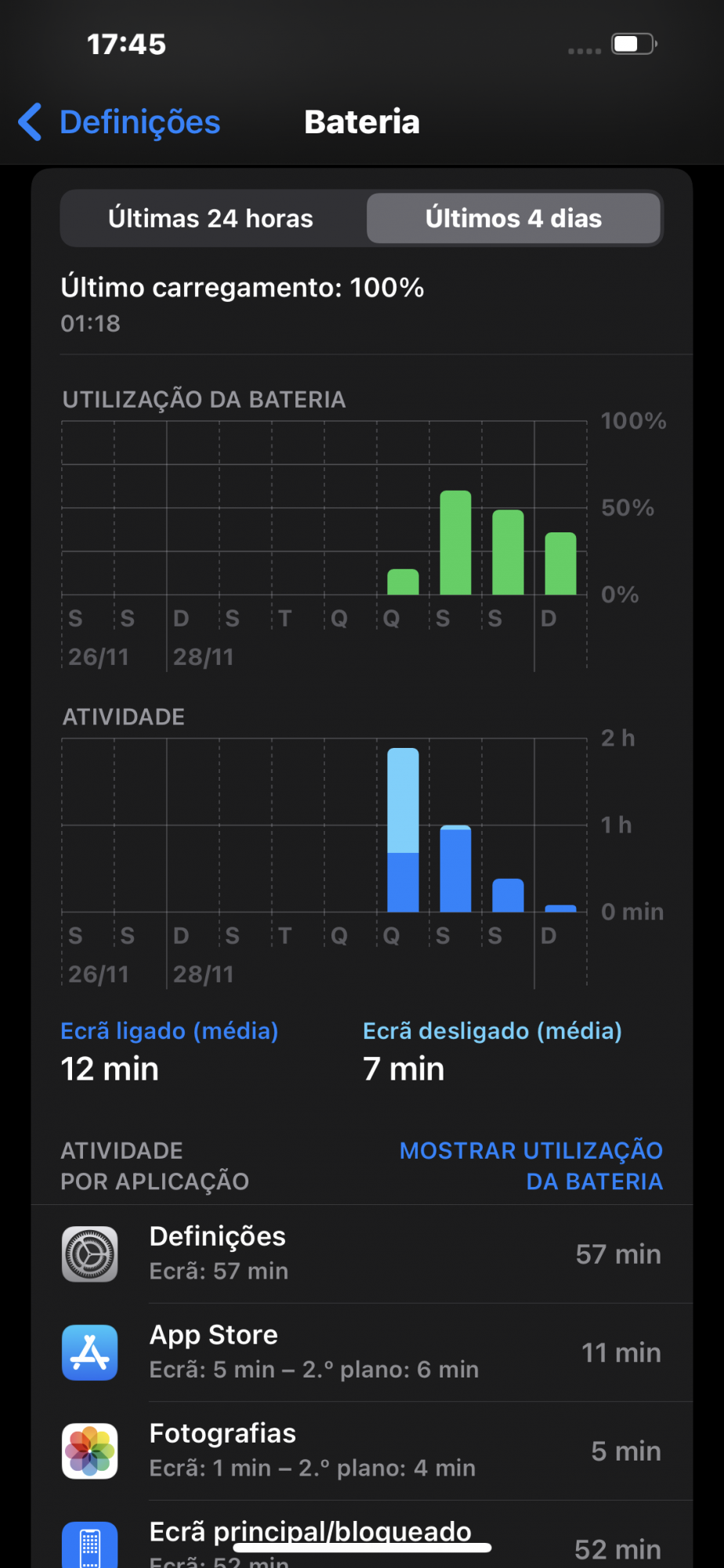

sem cartão da operadora e só aplicações originais nem estou a usa-lo para ver se consigo ver de onde ele perde bateria mas não consigo.

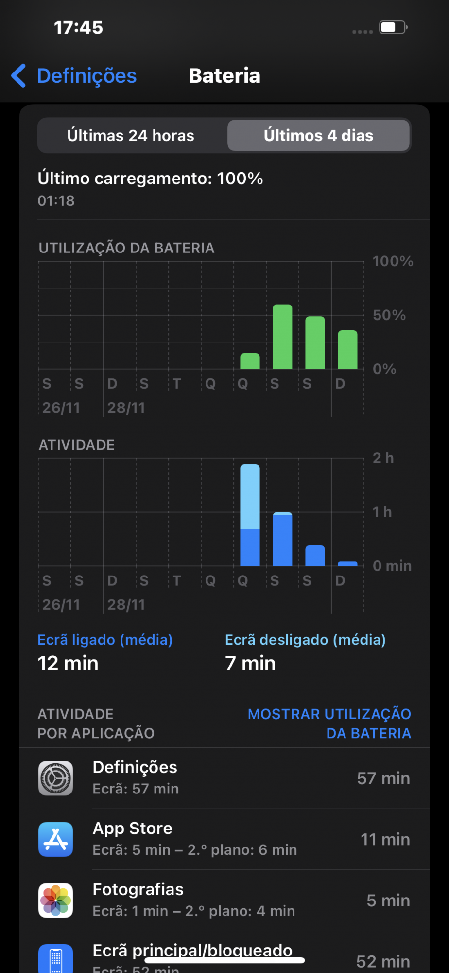

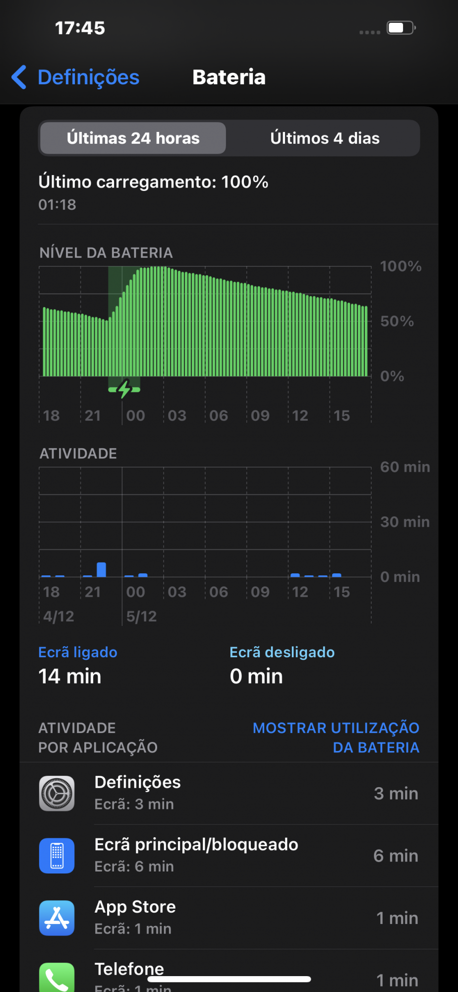

perda na media de 20% em stand bye e durante a noite sem nada aberto

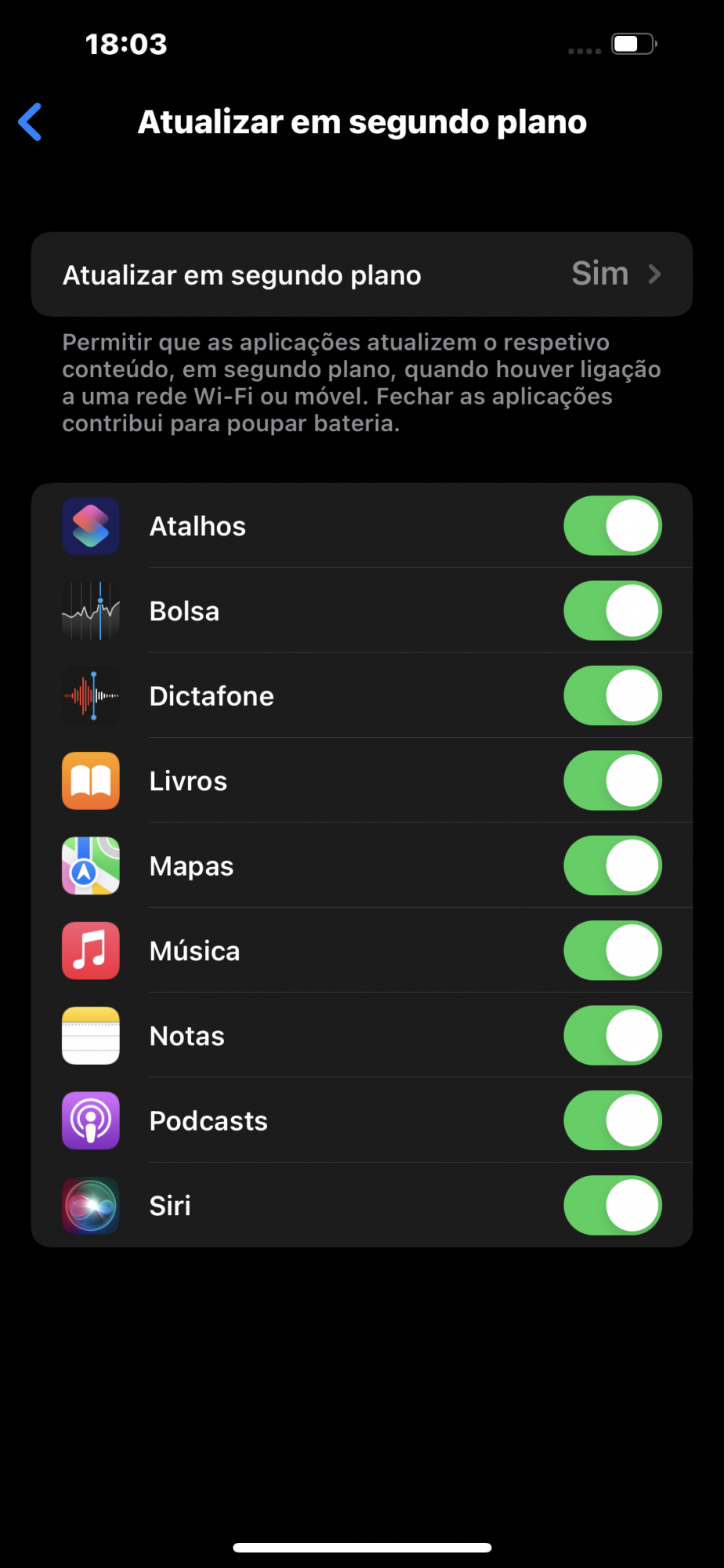

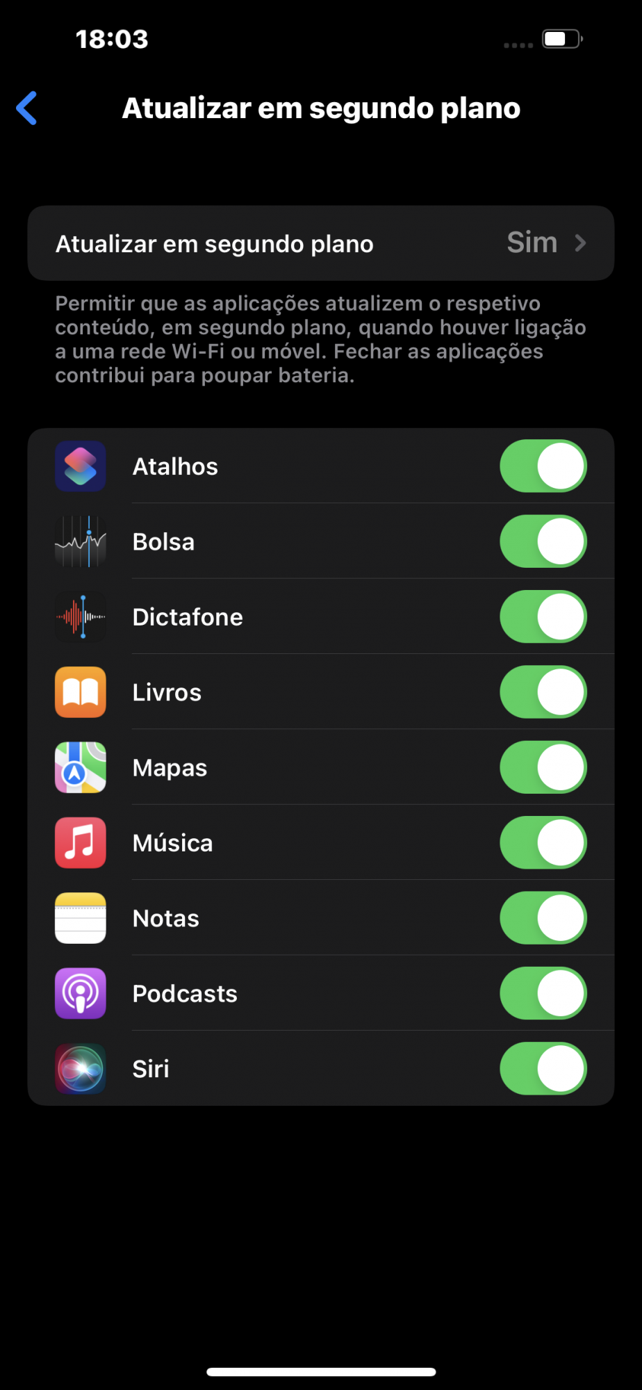

boas só tenho apps da Apple mas também já tive tudo desativado e perde na mesma ???
e com wifi off

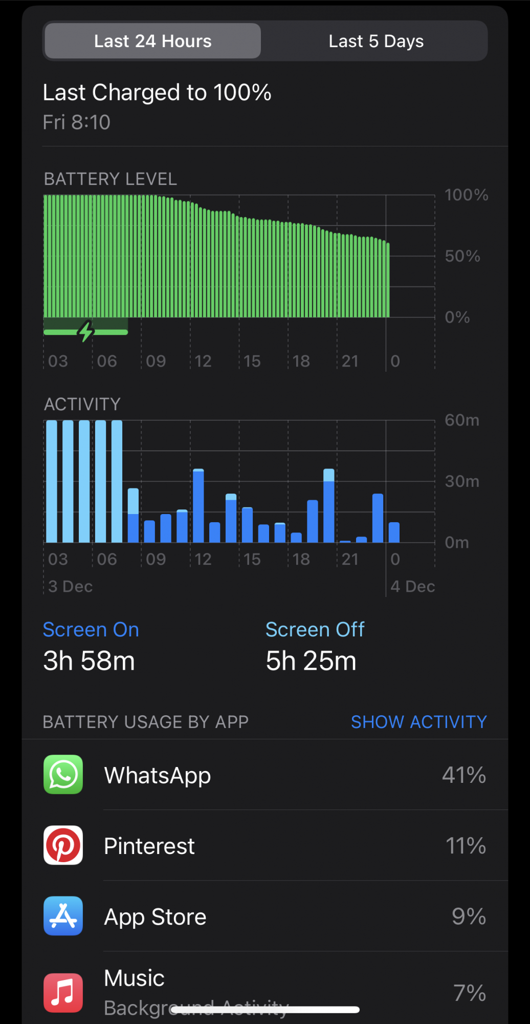

Rarely get more than 2.5-3 hr SOT per full charge with my 13 Pro. Any ideas of what to try apart from a complete restore?

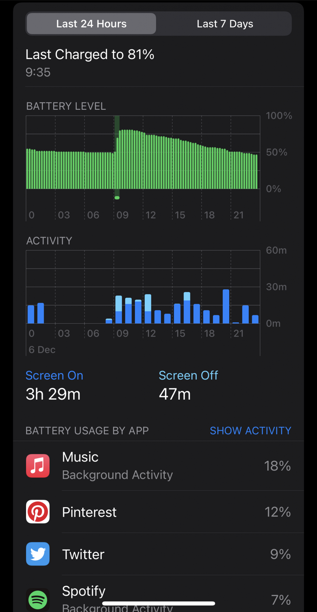

Its been two days since I charged my 13 Pro and I've got 7.5 hours screen on time and I'm sitting at 50% battery. Most used apps were Safari, Youtube, Reddit, Uno (game), and about 15 to 20mins of Mario Kart and Call of Duty each so not the most demanding stuff.

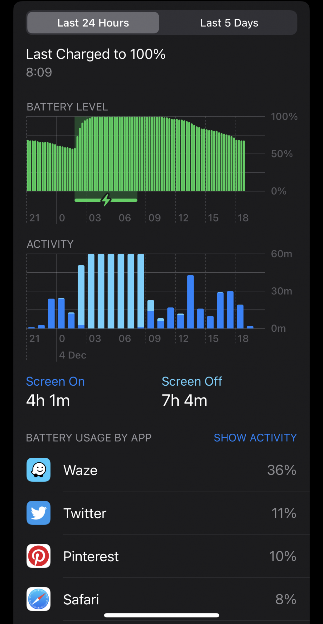

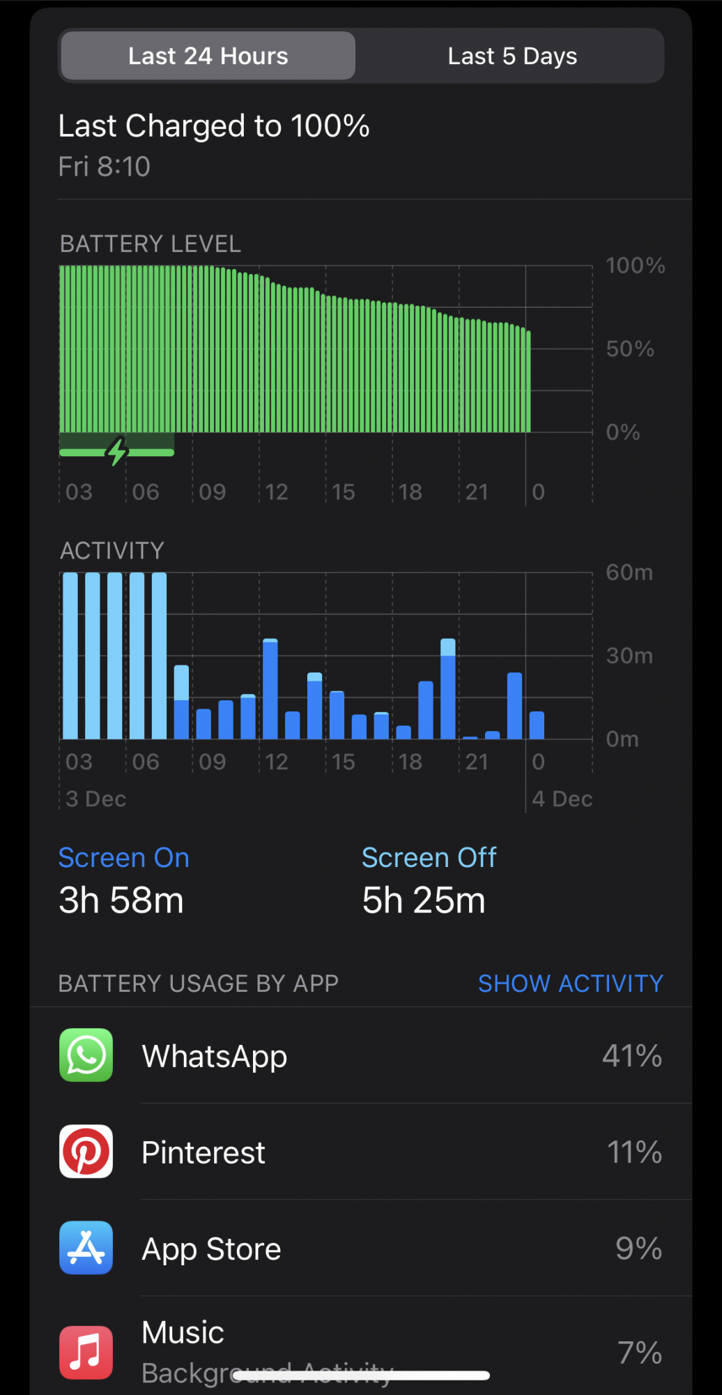

Yes I have an Apple Watch. The 24h graph isn't that useful as it was a very different usage pattern to normal, but here's the 10 day graph.
You have a lot of screen off time, that consumes battery too. This doesn't seem as bad as before

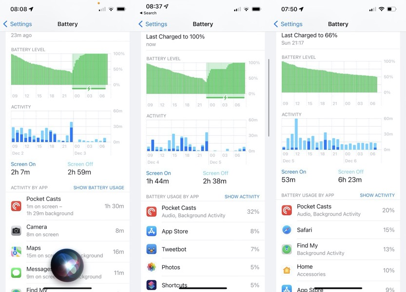

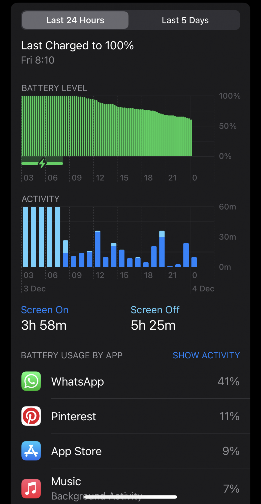

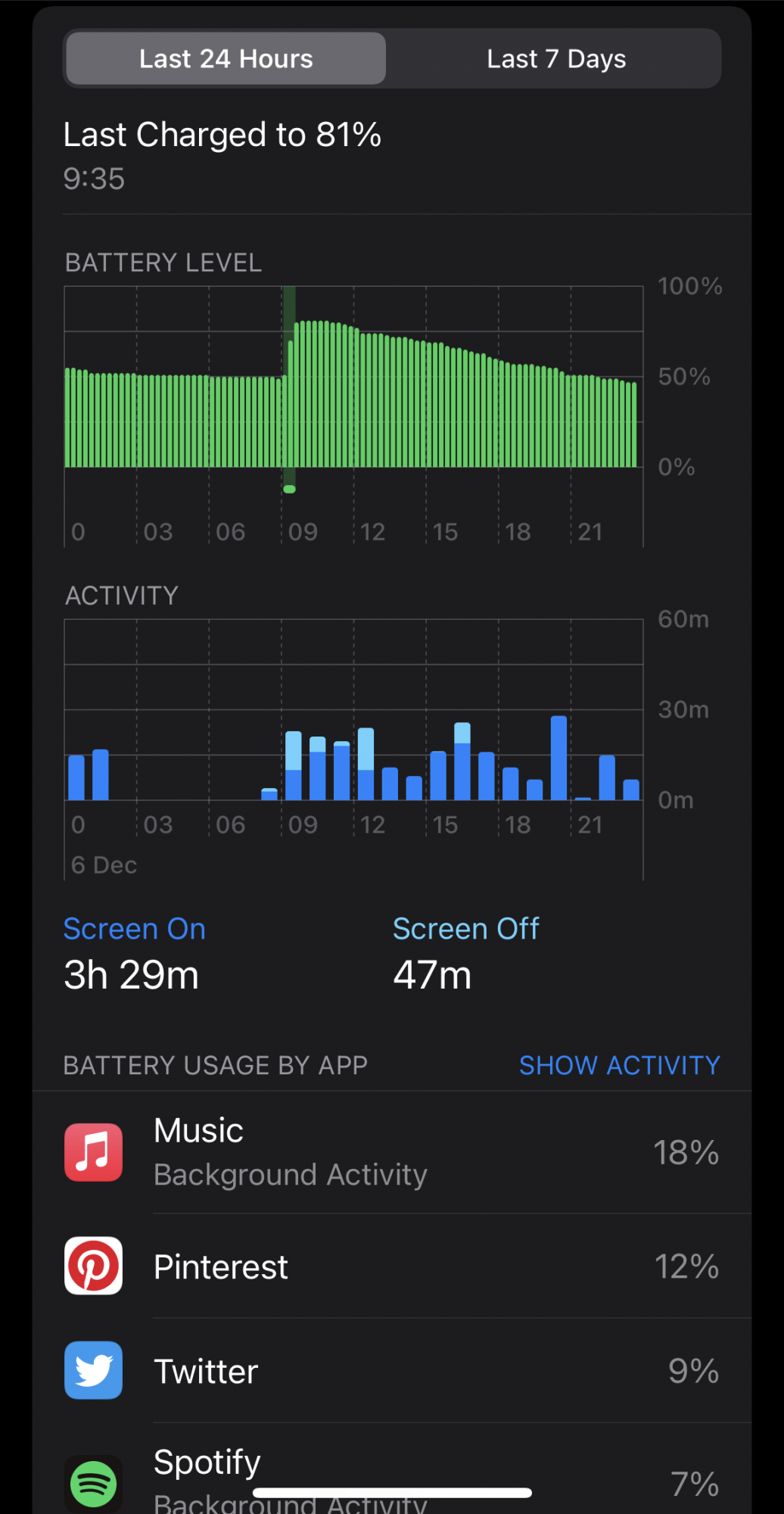

This is my experience too. Transferred from 11 Pro and Apple Watch. Subsequently did resets, restore from backup, unpair watch. Nothing helps. So many hours spent on this....

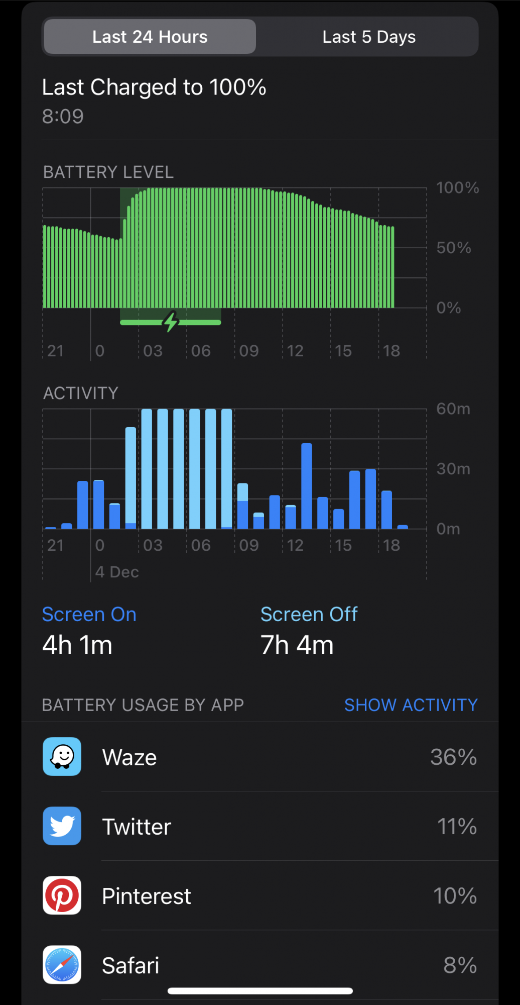

It really seems like there are two kinds of battery in iPhone 13 Pro. One gets 4-5-7 hours SOT with > 50% battery remaining; the other 1-3hrs SOT results in less than 50% battery. Crazy. These are 3 of my recent daily battery results. Unbelievable how much power PocketCasts is consuming, but all use seems to hit battery hard.
