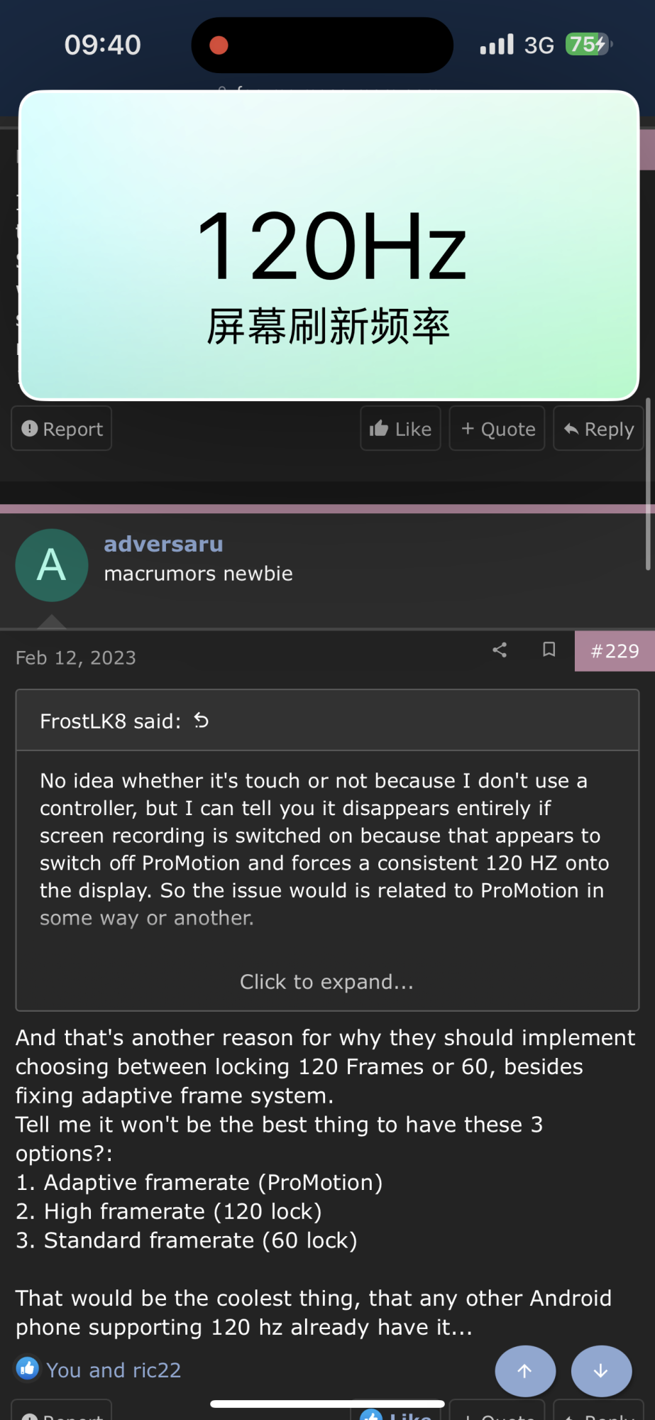

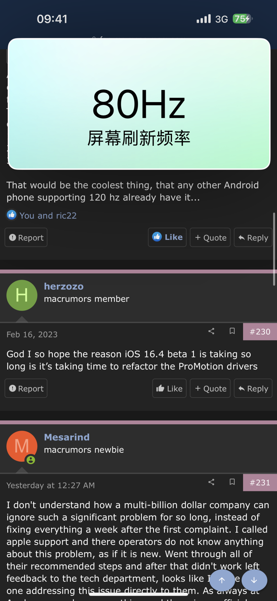

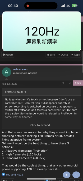

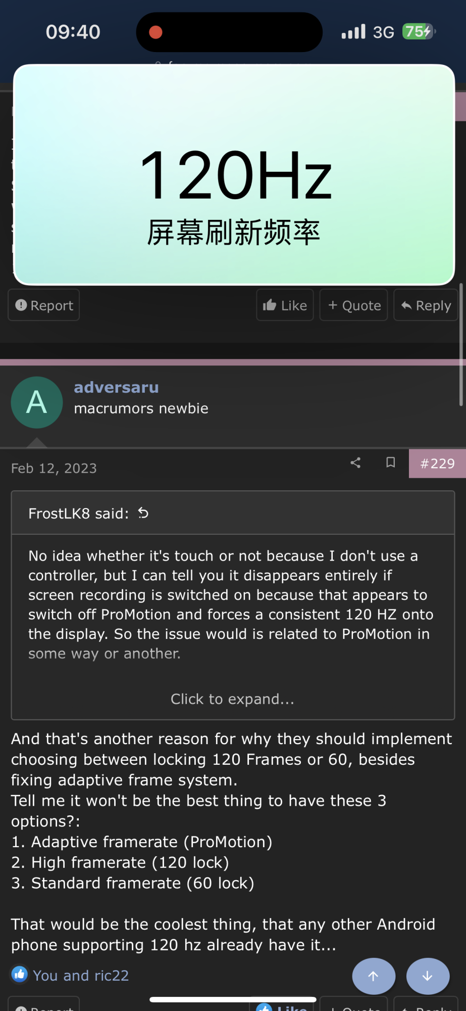

And that's another reason for why they should implement choosing between locking 120 Frames or 60, besides fixing adaptive frame system.
Tell me it won't be the best thing to have these 3 options?:
1. Adaptive framerate (ProMotion)
2. High framerate (120 lock)
3. Standard framerate (60 lock)
That would be the coolest thing, that any other Android phone supporting 120 hz already have it...
