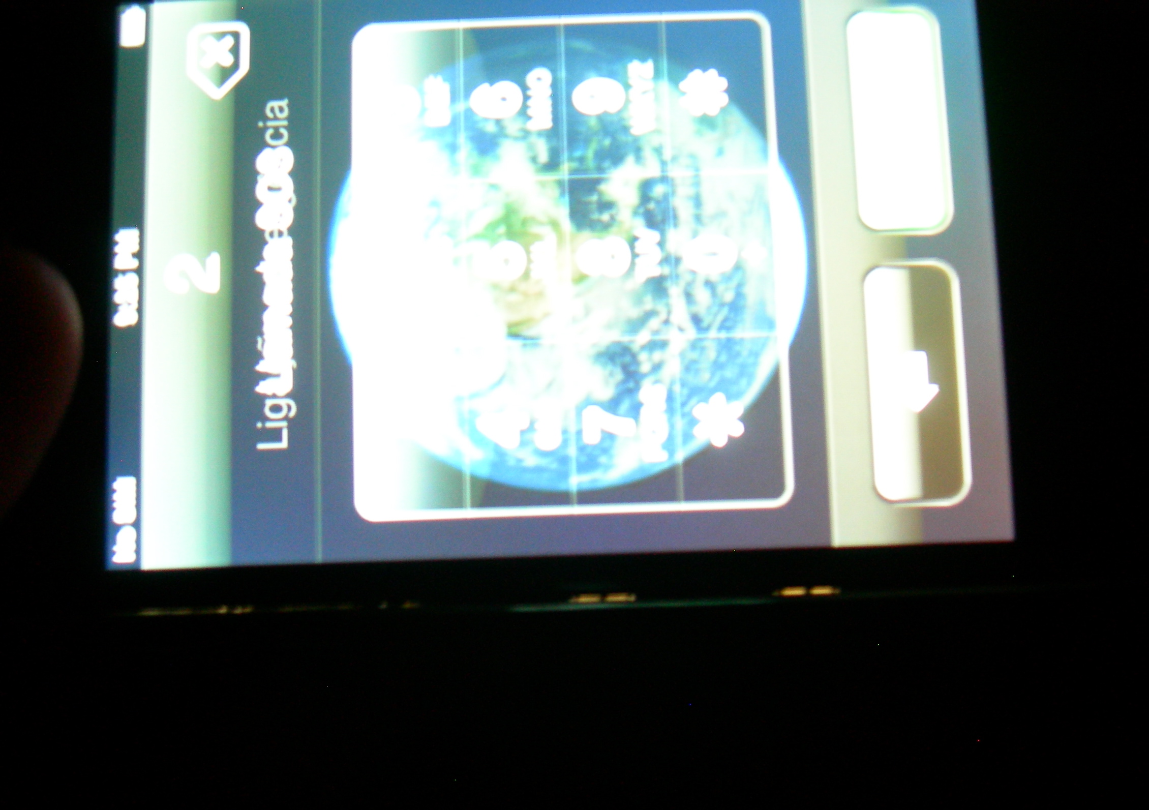

mine has this problem as well and i hope,being in Italy, that the Vodafone shop i bought it from will change it for me
Mine is about as bad as that except my light leaks are a bit thinner. But i have them all the way up the left side of the screen like you do.
You really need to get it replaced. I'm not sure how the exchange policy is overseas but here in the States if you complain enough they will exchange it for you.
