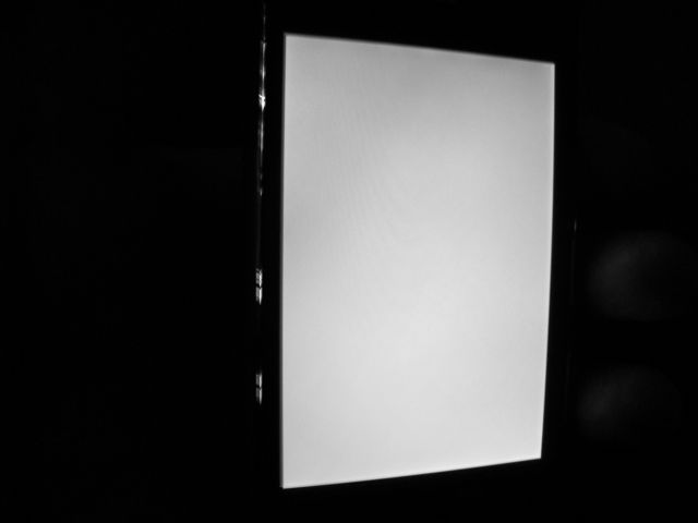

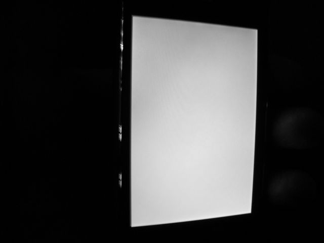

Oh that's a bad one! - but what's up with your screen superimposing images?
i'm not sure what you meant,do you mean the text being on top of other texts and such?it's probably just due to using a point and shoot and not using a flash in the dark,long exposition that is..the screen itself is satisfying, no dead pixels either.
as for dust under the glass, it's definitely possible cause of this bad "build" problem, and therefore the glass may also break a lot easier if bumped or dropped and malfunction may occur regarding the touchscreen,i guess

I'm having the same problem. All along the left side of the screen. I hope they'll replace it with a new one. Although it'd be a waste of my bodyguards and power support screen protector
Just returned from "genius bar"
Light is leaking through on the left side of my new 3G iPhone (see pic), so I scheduled an appointment at my local "genius bar."
I just got back from the appointment. The "genius" said three main things. First, he acknowledged the problem with my phone. Second, he said that Apple has not yet listed the light leak on 3G iPhones as a "known problem," and so (obviously) there is no "fix." Third -- and most importantly -- he said the "geniuses" in the store were well aware of the problem (other customers have come in to complain over the past 10 days), and he claimed they have not seen a 3G iPhone that does not exhibit the defect. That is, every phone they have looked at -- their phones, replacement phones, display phones -- has the problem to some degree.
He offered to swap the phone for me, but claimed I would have some light leak on the new phone -- possibly less, possibly more. He advised me to wait until Apple fixes the problem, before swapping, especially since I have no other problems (aside from the light leak, my iPhone is perfect).
He claimed that the defect is so widespread that it's only a matter of time before Apple takes some action to correct whatever is going wrong in the manufacturing process, adding that in all likelihood iPhones in stores at the end of the year will not be leaking light on the left-hand side.
He attached a service note to the serial number of my iPhone which says he observed the light leak and offered to swap the phone but I agreed to wait until Apple recognized the problem and fixed it at the manufacturing level.

Another thing to add is that many of my friends and co-workers never noticed the light leak until after I had looked at their phones. A lot of leaks are very hard to see even in the dark unless you tilt the screen to a certain angle. When the screen is titled at that specific angle you can see small slivers of light leaking all the way up the phone. I have yet to document a phone leaking from the right.
I assume that MANY MANY people have this issue and don't even realize it. For those of you who haven't inspected your phone closely I would suggest you turn the light off and tilt your phone every which way while looking at the left part of your screen where the metal meets the black border on your screen.
