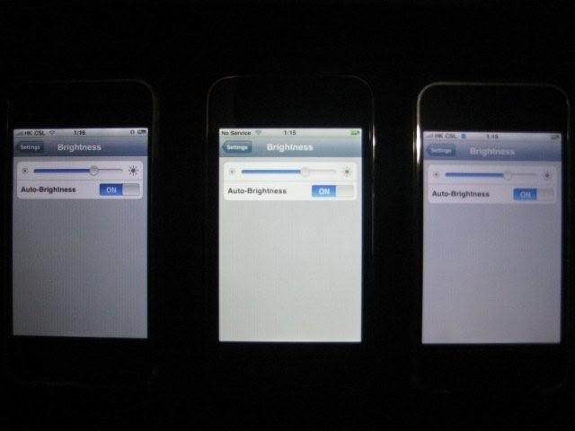

I think this may have something to do with the "auto brightness" feature, my screen looks very yellow in low light conditions but if I'm out side or put all the lights on it goes bright white.
I'm pretty sure this is not just a trick of the light, in good light the whites really come out white.
Very strange

Again, comparing your 3G iPhone to a 2G iPhone is a poor comparison unless you can guarantee that the 2G version has a screen that's properly calibrated, and not simply too blue. Maybe it was too blue, people got used to it, and are now using it as the standard for comparison. This doesn't mean the 3G iPhone's screen isn't yellow. Judging from the photos, it obviously is a little bit more yellow. It's just that the degree of yellow may not be as severe as people are making it out to be. 🙂
Furthermore, ACCURATE white balance depends on the source of light. On a partly cloudy day, your slightly yellow screen is going to look perfectly white. Same thing happens in photography, except your photos end up more blue on a cloudy (or partly cloudy) day. Many fluorescent lights are a bit bluish, so the iPhone will look good there too. There is no perfect WB for an LCD screen in every situation.
In other words, your screen will look different based on the type of lighting you're using your iPhone in. That is why screen calibrators (e.g.:Spyder, GretagMacbeth ones) all suggest that you calibrate your LCD in the same lighting conditions you normally work in. With any LCD, the colour will vary depending on the temperature of the light that surrounds you.

The comments about white balance of the room etc making screens look different colours - but there's still no denying that the colours of two screens side by side look different, so the screens must be different. Right?

I imported the picture into Photoshop, and check the actual colors. Now assuming that the digital camera used to take this picture has no color cast of its own:
The iPhone on the left has a blue bias, the iPhone on the right has a yellow bias. However, the left iPhone has MORE of a blue blas than the yellow bias on the right iPhone. So the right iPhone actually has a more accurete color.
But if you tend to prefer a bluish color, as if you are conditioned to the way the vast majority of computer monitors look leaving the factory nowadays, with color temperature around 9000K (way too blue as daylight is only 6500K), then you might consider the right iPhone as too yellow and the left iPhone to look more "correct".
QFT. The "problem" here is that the iPhone 3G looks different than the 2G iPhone does. Objectively looking, the 3G iPhone has screen that has more accurate colors than the 2G iPhone has, but people have gotten used to the screen on the 2G iPhone, with incorrect colors and all.
If the screen were reversed between 2G and 3G iPhones, we sould now have threads where people complain "the screen in my 3G iPhone has blue tint!"...

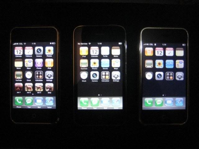

Have a look again at Spanky's picture at the beginning of this thread. Look at the background to the left of the yellow-screened iPhone on the left, and now look at the background to the bluish-screened iPhone on the right. Note the background on the left is more yellow than the background on the right. You can even do a comparison of each bit of background using the cmd-shift-4 trick we heard about earlier.
I'm not suggesting the photo is a fake, but the contrast between the two screens might well be amplified by a photographic aberration. Spanky, is this exactly how it looks in real life? It seems to be more extreme than other comparisons.

That first photo I posted is definitely what the difference was like, not a photographic anomaly. I'm lucky in that CPW managed to find another iPhone to replace it for me. I can't check to see if its any better yet because in the mean time the US iPhones went on sale and the activation server's crashed. I'll report back when I have it activated and will compare it again.

More than a 'bit' yellow
I have two 1G iPhones side by side with the iPhone 3g, and the 3G is more than a 'bit' yellow. It is bordering on green. Very ugly. The black is not even close to black either.
It is hard to tell in these low quality photos, but it is VERY noticible. I thought I was dellusional and showed my girlfriend and she said, "it is duller, and less sharp, but brighter." UH!
