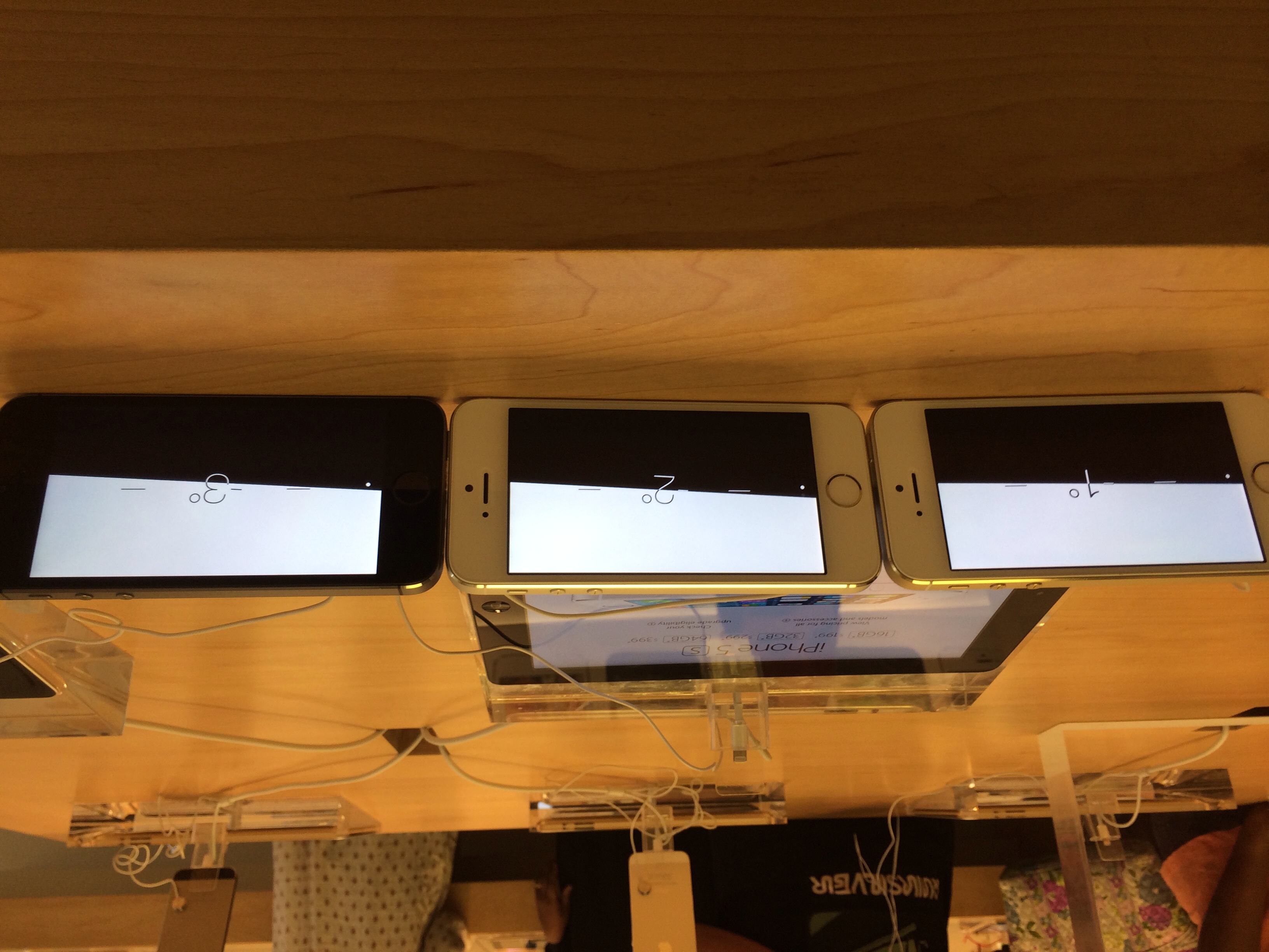

Just to add my story here as well: just got back from the Apple Store. No Genius Bar appointment, but I can confirm every single floor model iPhone 5s was miscalibrated. As if we needed more proof, I took a few photos (can only upload one for some reason, and no idea why it's inverted...it's not on my phone). Please don't mind the skewed angle if the images, they were taken with my 5s 😉
I then spoke with AppleCare support, and they escalated the issue and put in "a ticket". The support dude hadn't heard of the issue, tried to get me to do the 90 min reset, and finally just told me he would contact the higher ups and give me a personal call back on Wednesday at 1:30pm. No word on whether it's hardware or software, but he said we should have an answer by Wednesday.
News to come...

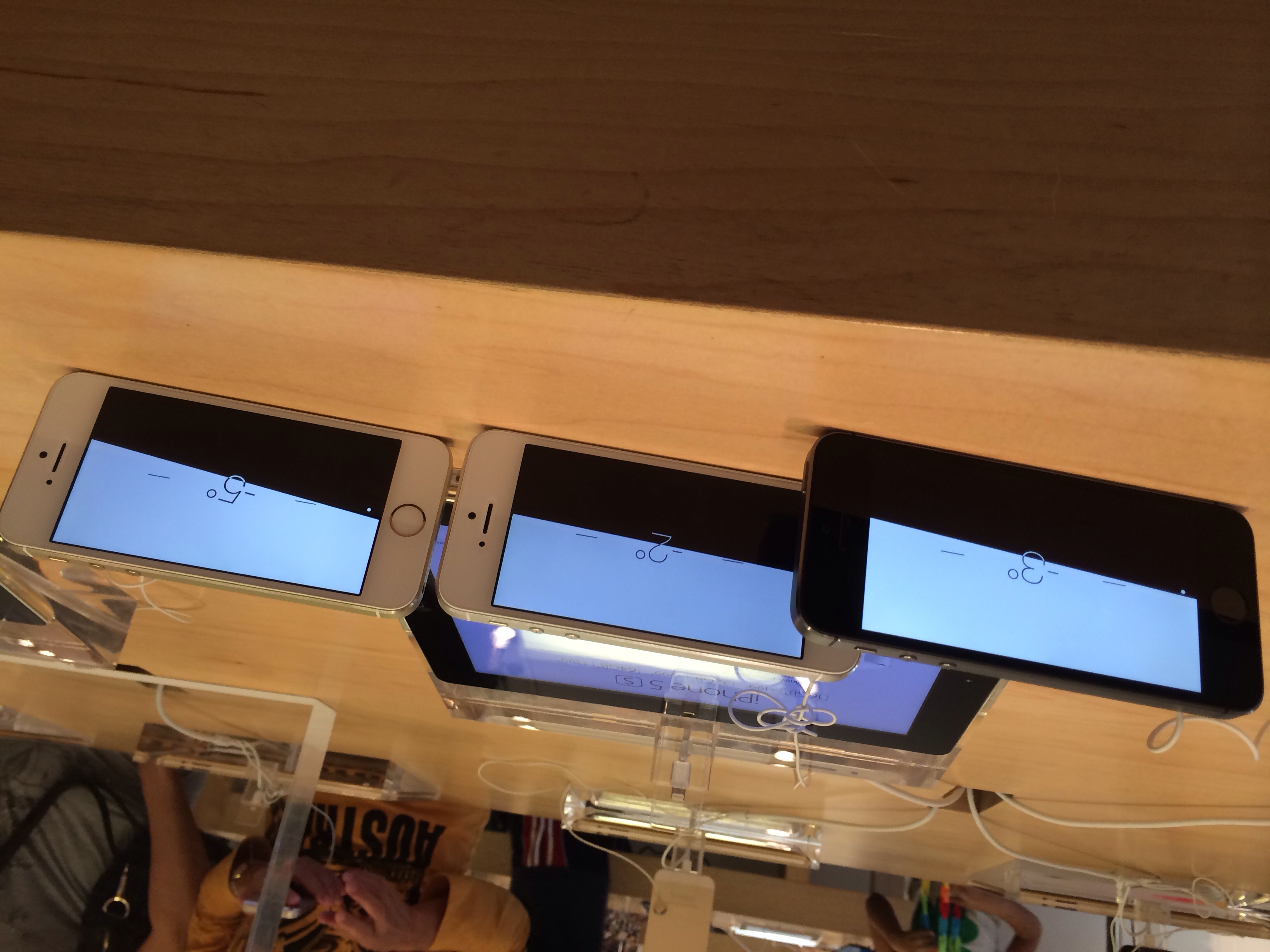

Another image
Yelp, these pictures prove nothing to me since I'm already totally aware of the issue but it may help some of those people that aren't aware of the issue or refuse to believe that Apple could make such a mistake. Thanks for the pictures and your time. We and mostly Apple, indeed does have a serious problem here. They should fix or take some action soon. We all paid big bucks for this so called "Smartphone of the year" and only a couple weeks ago at the WWDC Apple told us how great this M7 chip was going to be for games and other apps. Gosh, I can't even play a race car game without the car going off the road.
