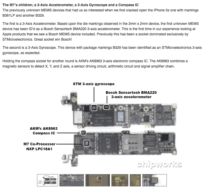

What do you think of this new Bosch designed chip that Apple presumably built into the iPhone 5s:
BMA 220
http://newsletter.spezial.de/home/article/146/digitale-beschleunigungs-sensoren
Could it be part of the problem or is really just a software issue.

a poster called gs28 before me said the iPhone 5/5C uses the the Bosch BMA180 -> to my knowledge that is not correct.
The iPhone 5 uses a chip from another manufacturer (forgot its name) but it had 16bit resolution.
But it is said that the 5s uses the Bosch BMA220 which is the cheapest chip on the link that I also posted here.
So the questions still stands if resolution could make this kind of a difference in the measurements ?!

Links to iPhone 5s "ingredients"
http://www.chipworks.com/en/technical-competitive-analysis/resources/blog/inside-the-iphone-5s/
here is an extract from the site:
of course I cannot garantuee these guys are right. ;)
