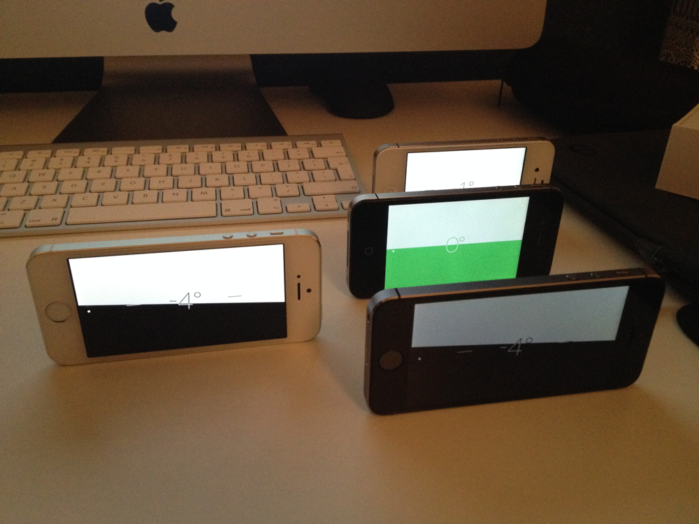

There's an article on Engadget stating that apple may be using a new supplier for the accelerometer with a larger tolerance than the older part in the 5. The new tolerance is around +/- 5° which people are seeing and the older part had a smaller tolerance of +/- 1° which somewhat explains the variations in the 5 and 5s. The article also states that apple could provide a software fix to adjust for the bias, but who knows if apple will ever patch this problem. I have already swapped out my phone once and although it is slightly better than my last I do not want to waste my time swapping phones. Since I am one of these peeps that swap out my phone every year I will just wait for the next iteration and hopefully larger iphone. Till then I can only hope apple will provide some kind of software calibration in the near future.
http://www.mactrast.com/2013/10/new-supplier-iphone-5s-accelerometer-causing-incorrect-compass-level-readings/
Here's our two drunk iPhones next to some older models...
There's an article on Engadget staying that apple may be using a new supplier for the accelerometer with a larger tolerance than the older part in the 5. The new tolerance is around -/+ 5° which people are seeing and the older part had a smaller tolerance of +/- 1° which somewhat explains the variations in the 5 and 5s. The article states that apple could provide a software fix to adjust for the bias, but who knows if apple will ever patch this problem. I have already swapped out my phone once and although it is slightly better than my last I do not want to waste my time swapping phones. Since I am one of these peeps that swap out my phone every year I will just wait for the next iteration and hopefully larger iphone. Till then I can only hope apple will provide some kind of software calibration in the near future.
http://www.mactrast.com/2013/10/new...ter-causing-incorrect-compass-level-readings/
Why did you swap it when there is no evidence that they changed anything in the hardware since the first one you got?
