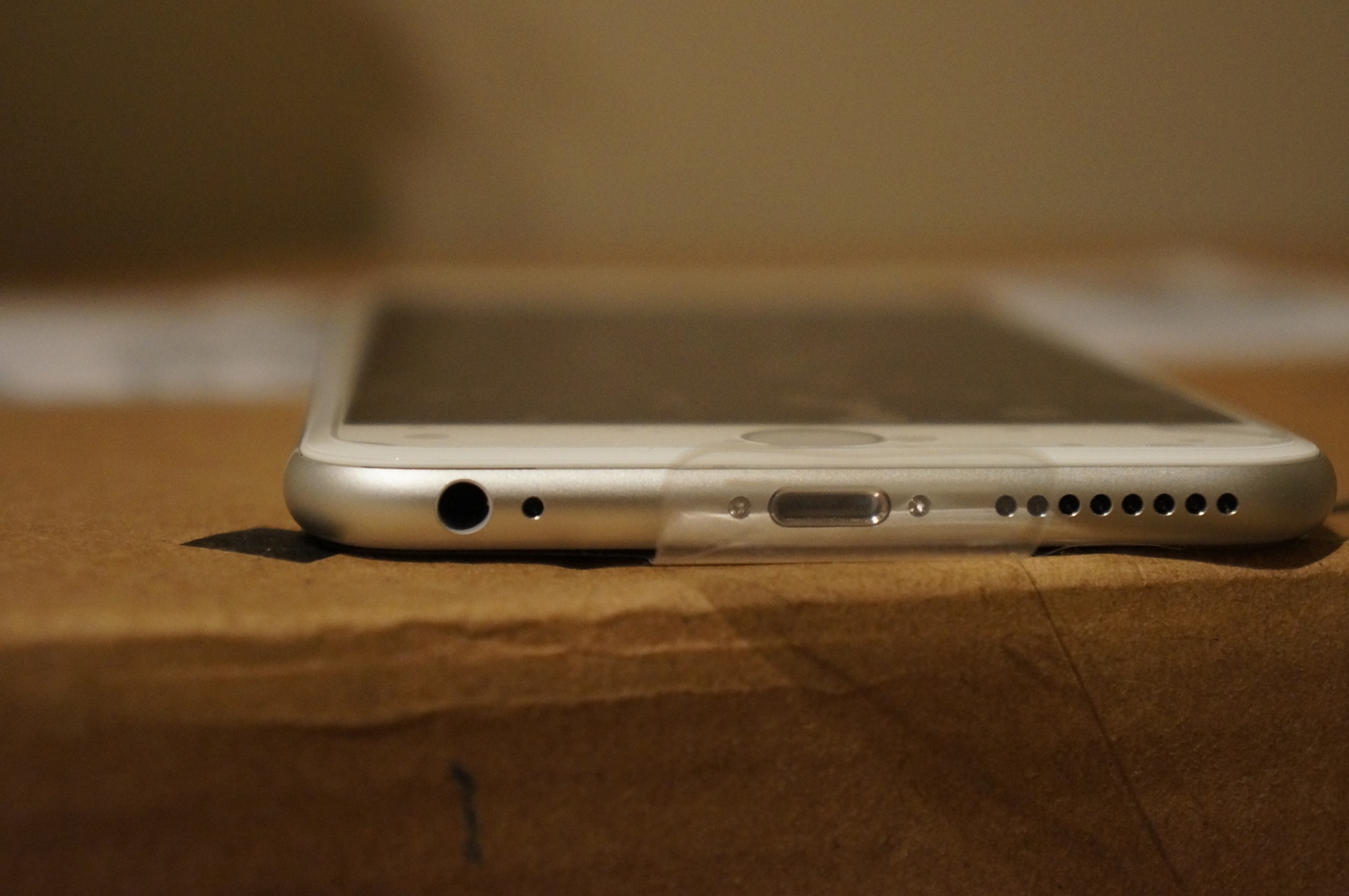

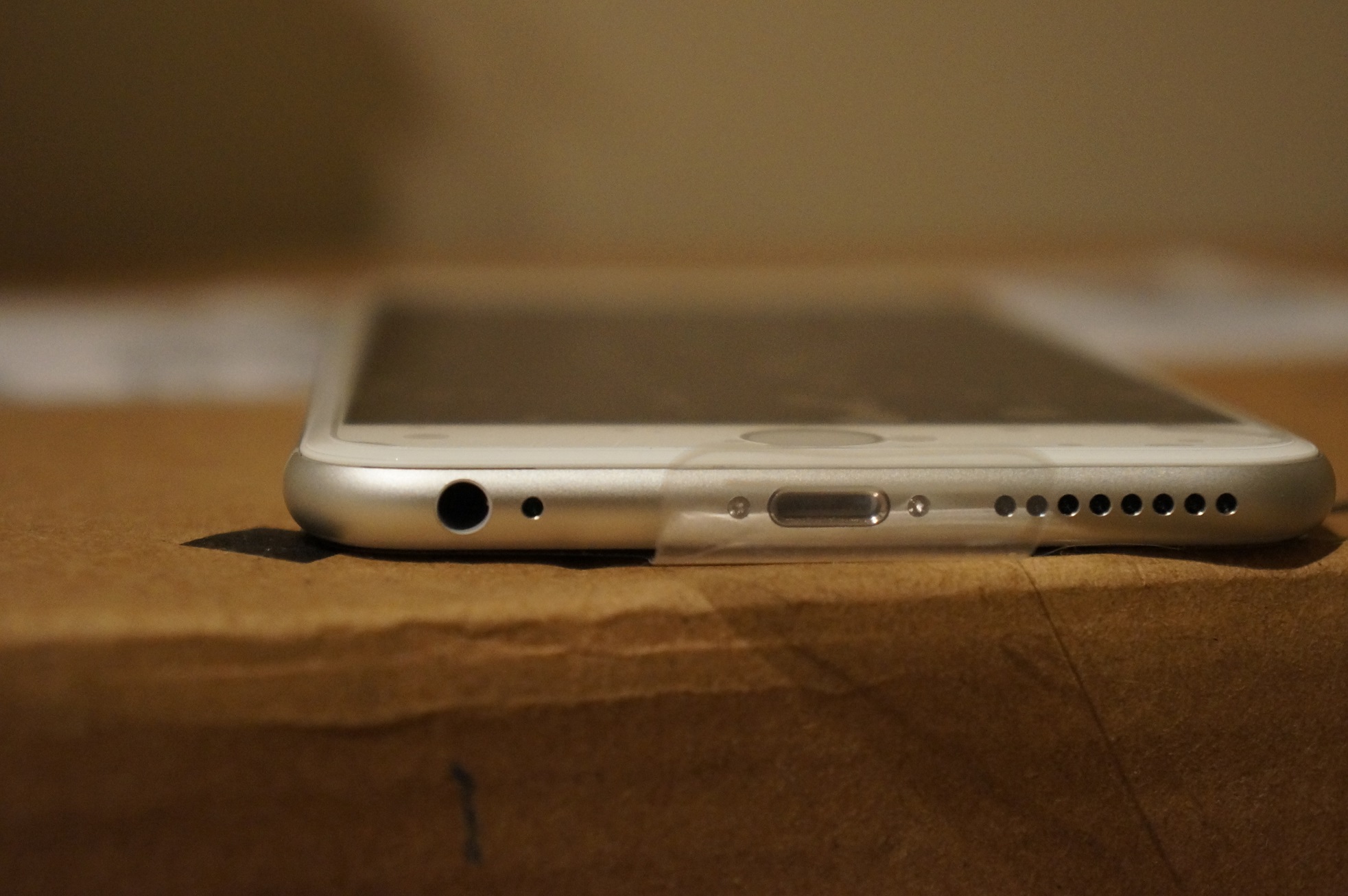

I have the issue of when I'm talking on a call and I put it on loudspeaker, the person on the other end can't hear me... There is nothing coving the bottom of the phone so all ports are free...
Anyone else have this problem and or know how to fix it??
I noticed this "problem", it seems that when it is on speaker mode...the phone uses the mic near the camera instead. So if the protective film is till on, your voice would not reach the other caller.
To test it while having the film on, gently tap on the mic near the camera while on speaker, the other caller should hear the tap. Else just remove the plastic film and speak normally.
With the speakerphone turned on, other person on the line can't hear me at all. Anyone else having this issue?
remove the plastic film if it is still there, the phone uses the mic near the camera when on speaker. Hope this helps
