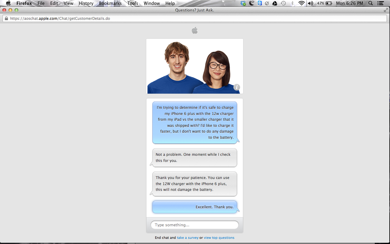

Not that this is really worth anything, but I chatted with an Apple rep online and asked the very same question.

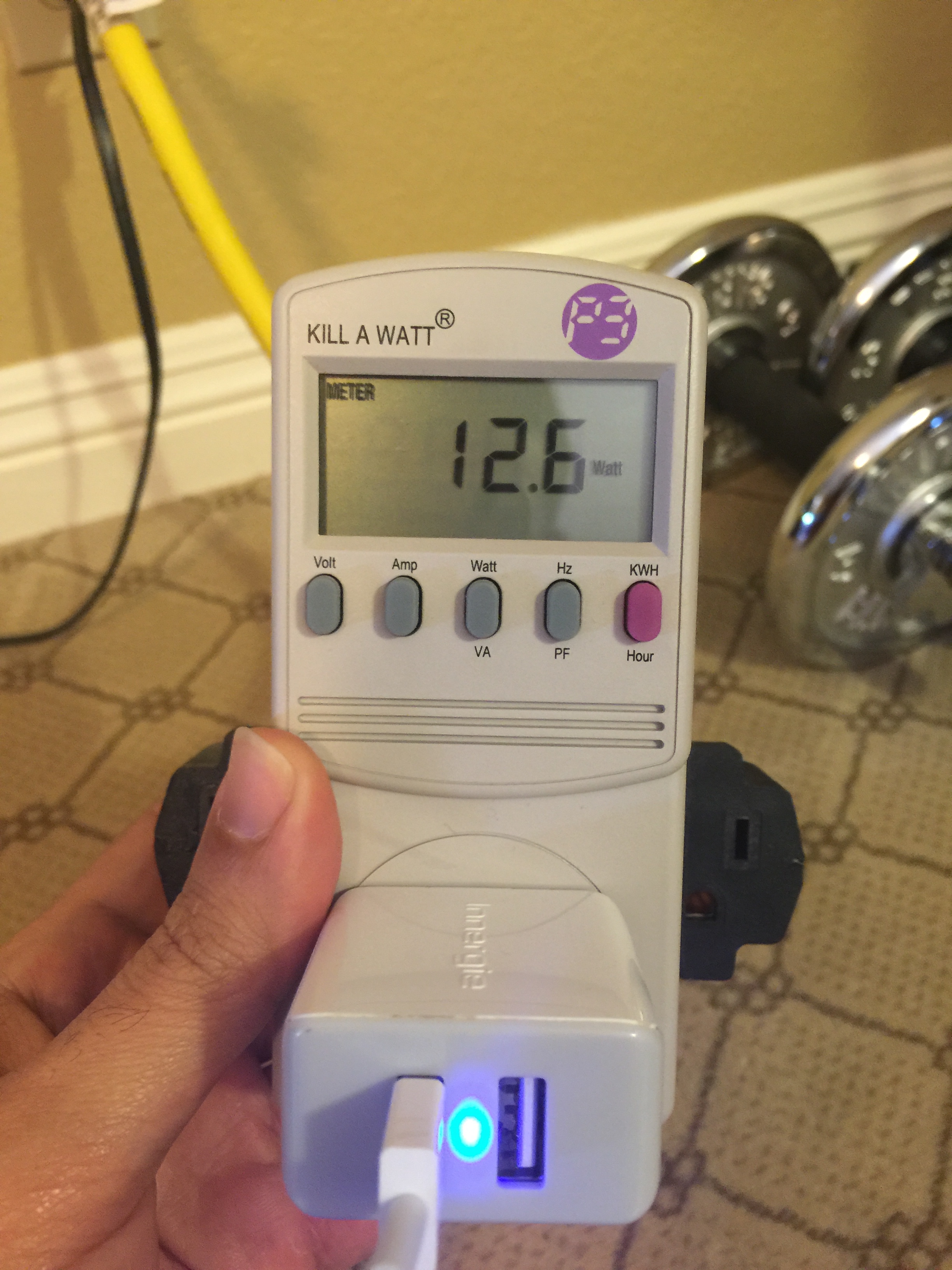

I have done some further testing with my iPhone 5s and 6.
I can confirm that the 5s does not draw more than 6w maximum even from the 12w charger, even with the screen on. This means both chargers treat the 5s exactly the same.
Here is the 5s charging on the 1a charger:
and on the 2.1a (12w) charger:
and the 6 on the 1a charger:
and the 6 on the 2.1a charger:
the 6+ (from:https://forums.macrumors.com/threads/1785460/)
attachment.php
To summarize, both the 6 and 6+ can make use of the 2.1a charger; the 6 seems to do so by using the additional headroom to power the screen and phone while still sending a full 6w into the battery, and the 6+ takes that further allowing up to ~13w total draw - although it's unclear what proportion of that is going into the battery and what to powering the device.
