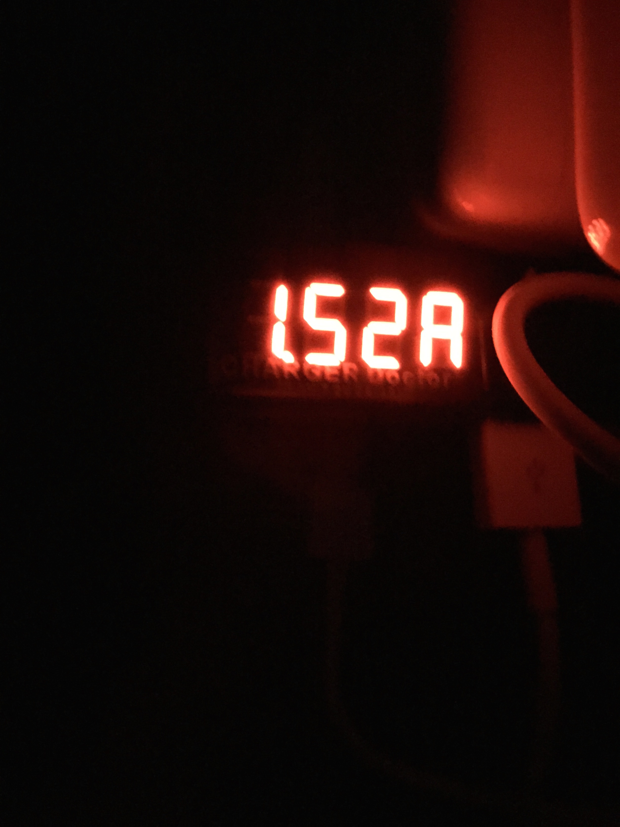

iPhone 6 charges at 1.5A. (measured at 23% battery left). You're welcome. See attachment.

That matches my results and conclusion, however it does appear that the 6+ is capable of charging at more than 6w.
And so is the iPhone 6 (Plus).
The iPhone 5s or earlier was not designed for that amperage therefore even if you charge with a 2.1A charger, it would be the same as charging with a 1A charger.
But now that the iPhone 6 (Plus) can charge faster with a 2.1A charger, this means that it was designed for that amperage.
If it was not, then it would be like the iPhone 5s or earlier who would not charge faster with a 2.1A charger.
