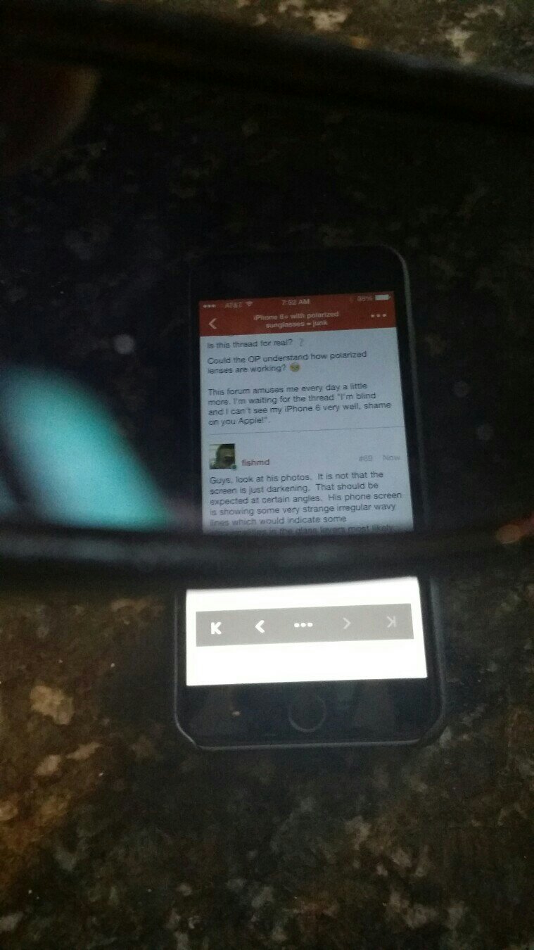

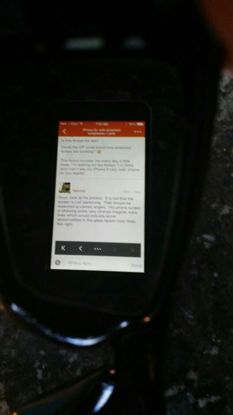

Anyone else seen this with polarized sunglasses. I have Oakley biking glasses and thought my screen was broken when I had them on. Found out it only looks like this with the sunglasses on.
I am not very happy at all about this. Going to Apple store and check demo units. This along with buggy IOS 8 does not make a happy camper right now. Battery life and screen without sunglasses is what I am most impressed with.
Look at pictures. I took without sunglasses and everything is normal. Then I put sunglasses over camera and this is what I am seeing when wearing my Oakley polarized sunglasses.
This device is almost $1000. This is unacceptable to me. We'll see if its just my phone or what Apple wants to do about it.
It is how LCD works, through the polarization of light. Your shades or any external polarizers will screw it up. If different phones have different effects like wrinkles... I would blame the phone... Especially if the 5 appeared OK. Weird.
That's completely normal. I first noticed this 30 some years ago in the hatchback of my car while wearing polarized sunglasses. The ripples are a normal artifact. It just shocks me that not only would this be new to someone, but that they think they are somehow seeing a defect with their "x-ray" specs.
It's normal to see a moire or rainbow pattern due to the interference pattern between the polarization grids of the screen and the glasses. It's also normal to have the display become brighter / dimmer (to the point of being completely obscured) depending on the relative angle of rotation between the polarization filters in the glasses and the screen -- that's the point of the polarization and how the glasses filter out light and how the LCD controls brightness of a pixel.

Guys, look at his photos. It is not that the screen is just darkening. That should be expected at certain angles. His phone screen is showing some very strange irregular wavy lines which would indicate some abnormalities in the glass layers most likely. Not right.

That article is about the polarizer filter of the display. What the OP is seeing is the combined effect of two filters: the display's and the sunglasses'.
You can't blame Apple on this issue.

Polarized glasses and LCD screens don't get along. This is nothing new and it has exactly nothing to do with iPhones beyond the fact that iPhones have LCD screens. Don't like it? Don't wear polarized sun glasses.
You can get polarized shades that are just as dark as non polarized ones. Personally I like polarization. Cuts down on glare and makes skies look more blue. But I take them off when I look at an LCD. Because they don't play nice with LCDs or other polarized things.

Wrong. The effect differs depending on how the two polarizations interact. If one has wider gaps between the lines for example or if one has less uniform polarization. There's really nothing unusual about what you're seeing here. LCDs and polarized lenses don't get along. Period. That's not a flaw with your phone.
