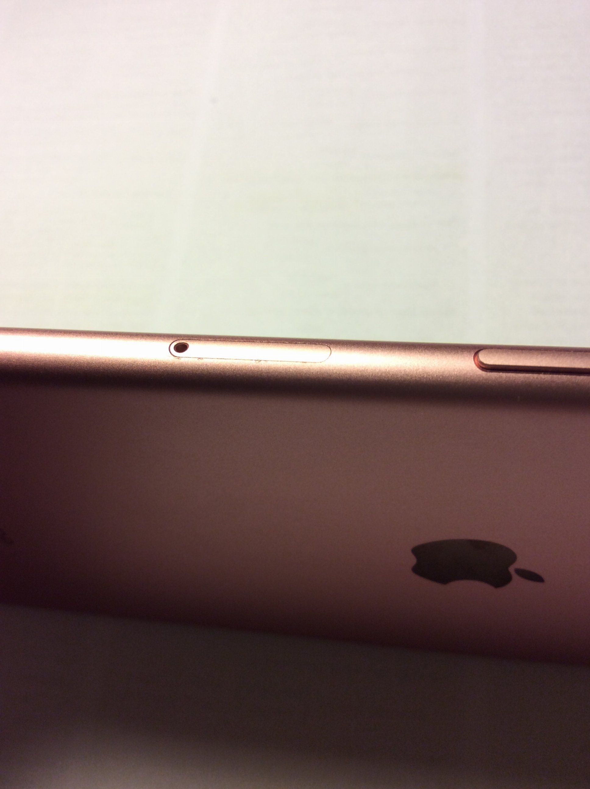

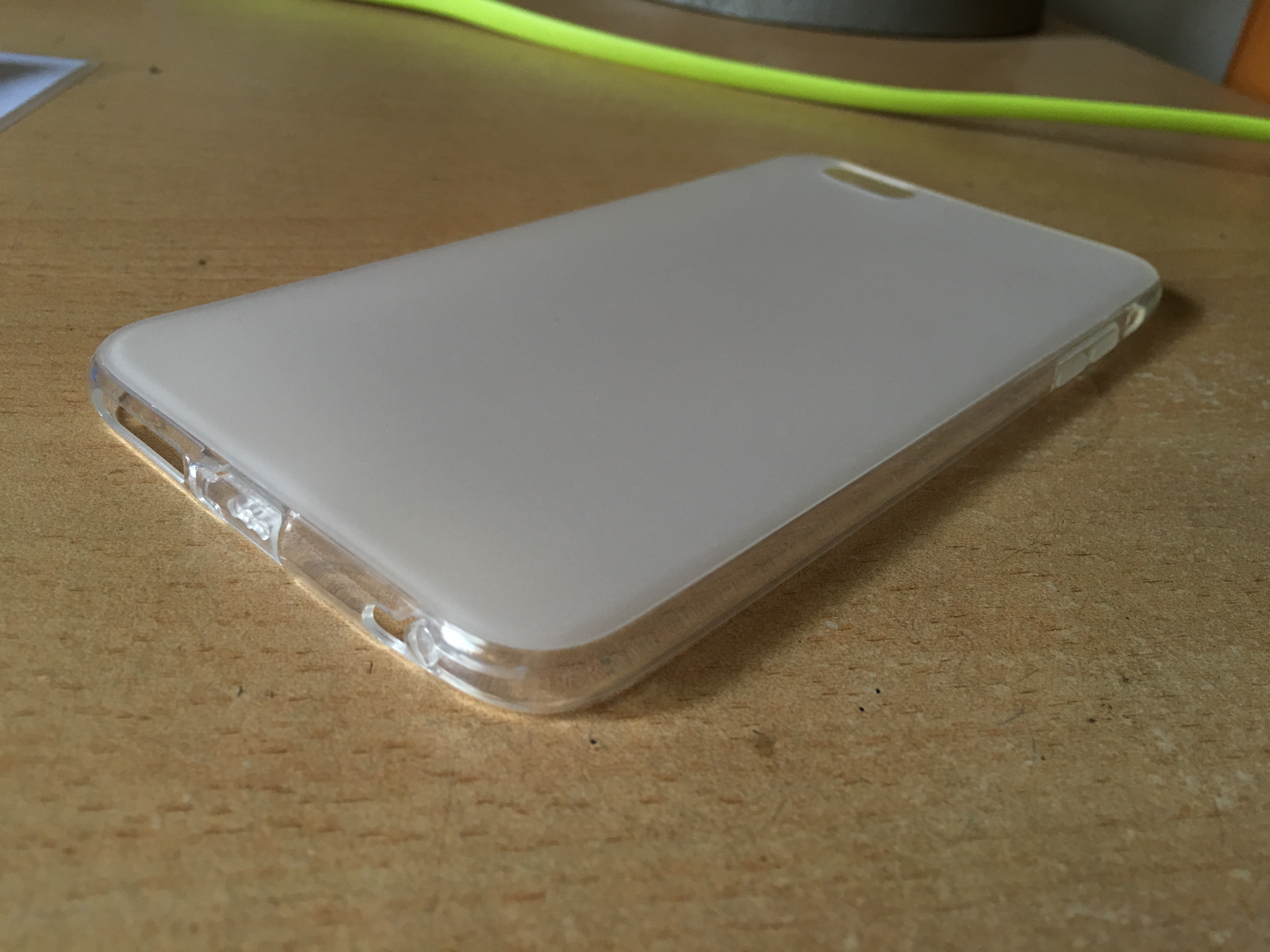

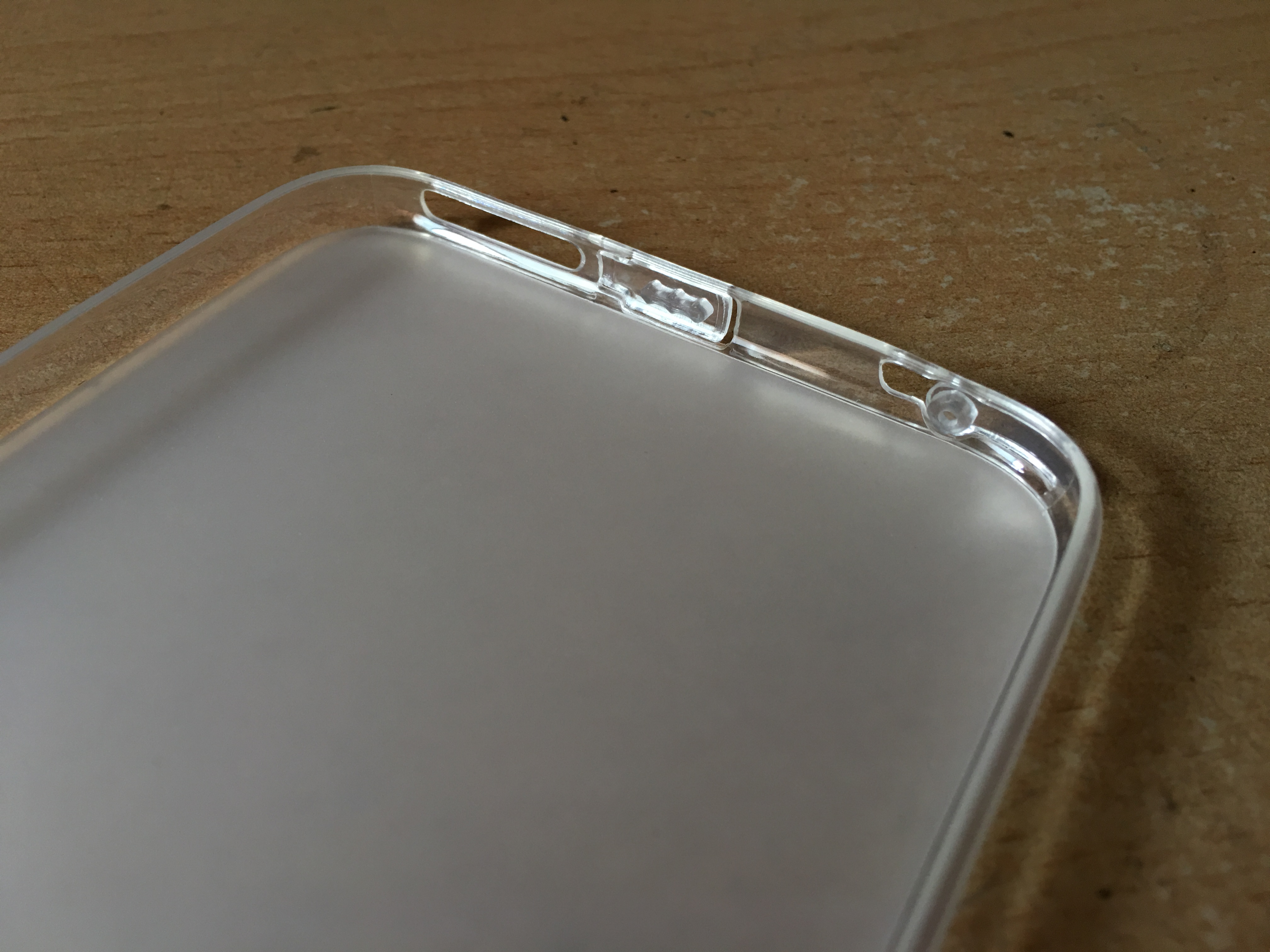

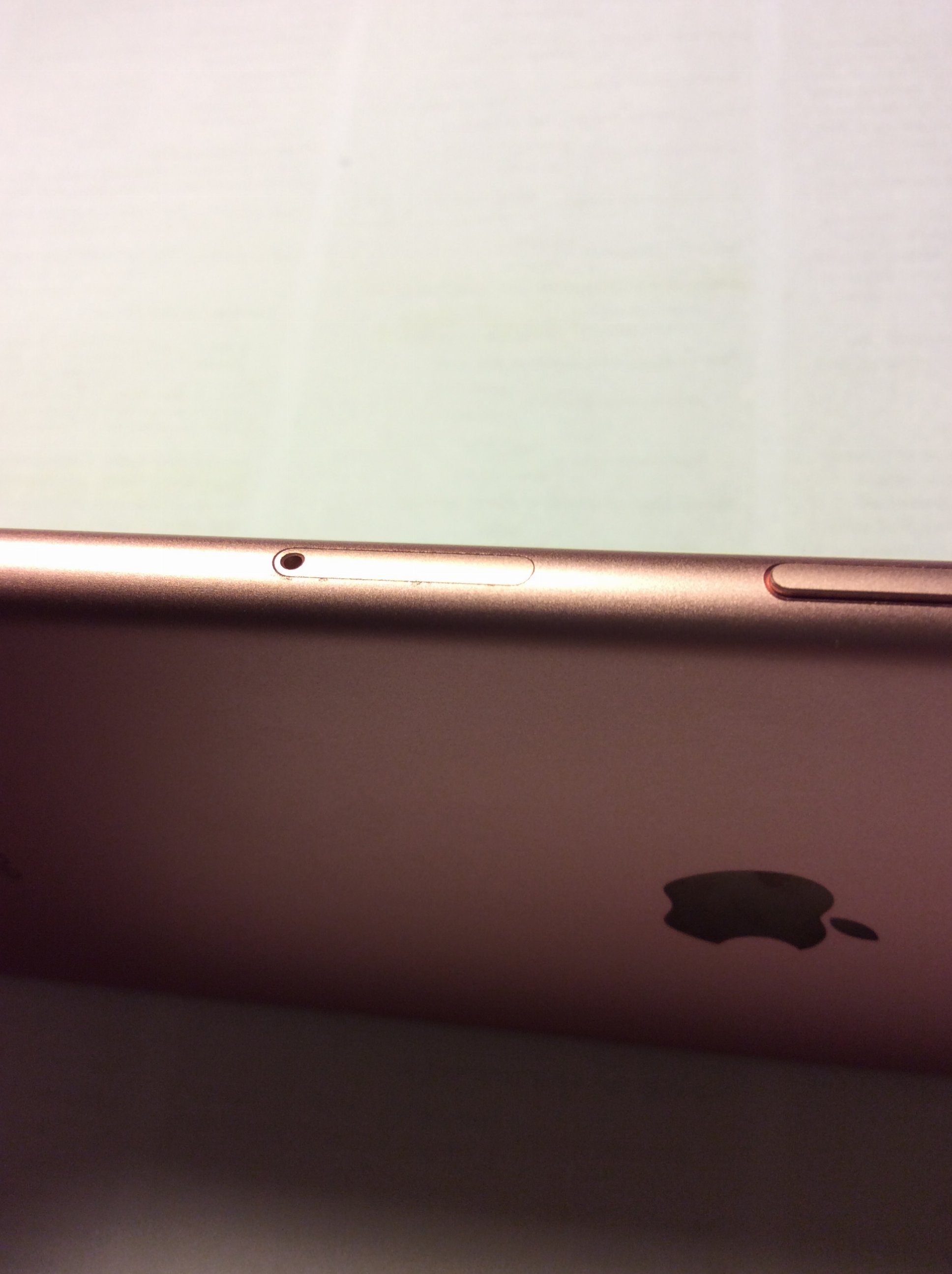

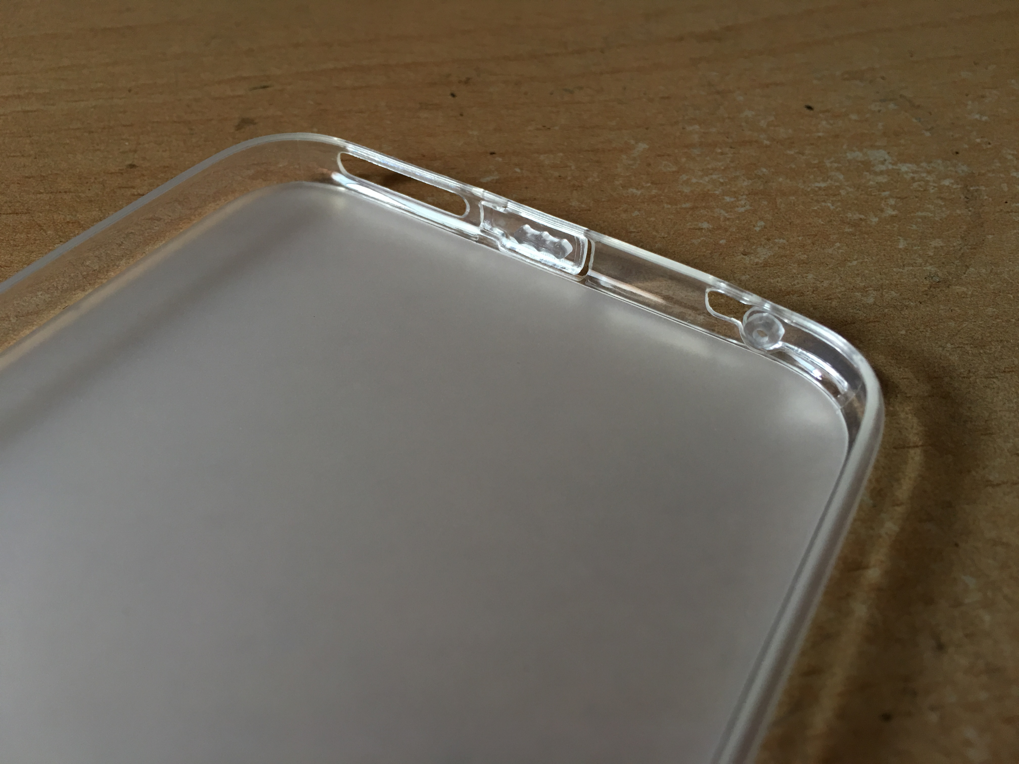

Can we see a pic of the case? Some detailed pics of the interior too.
Here you go

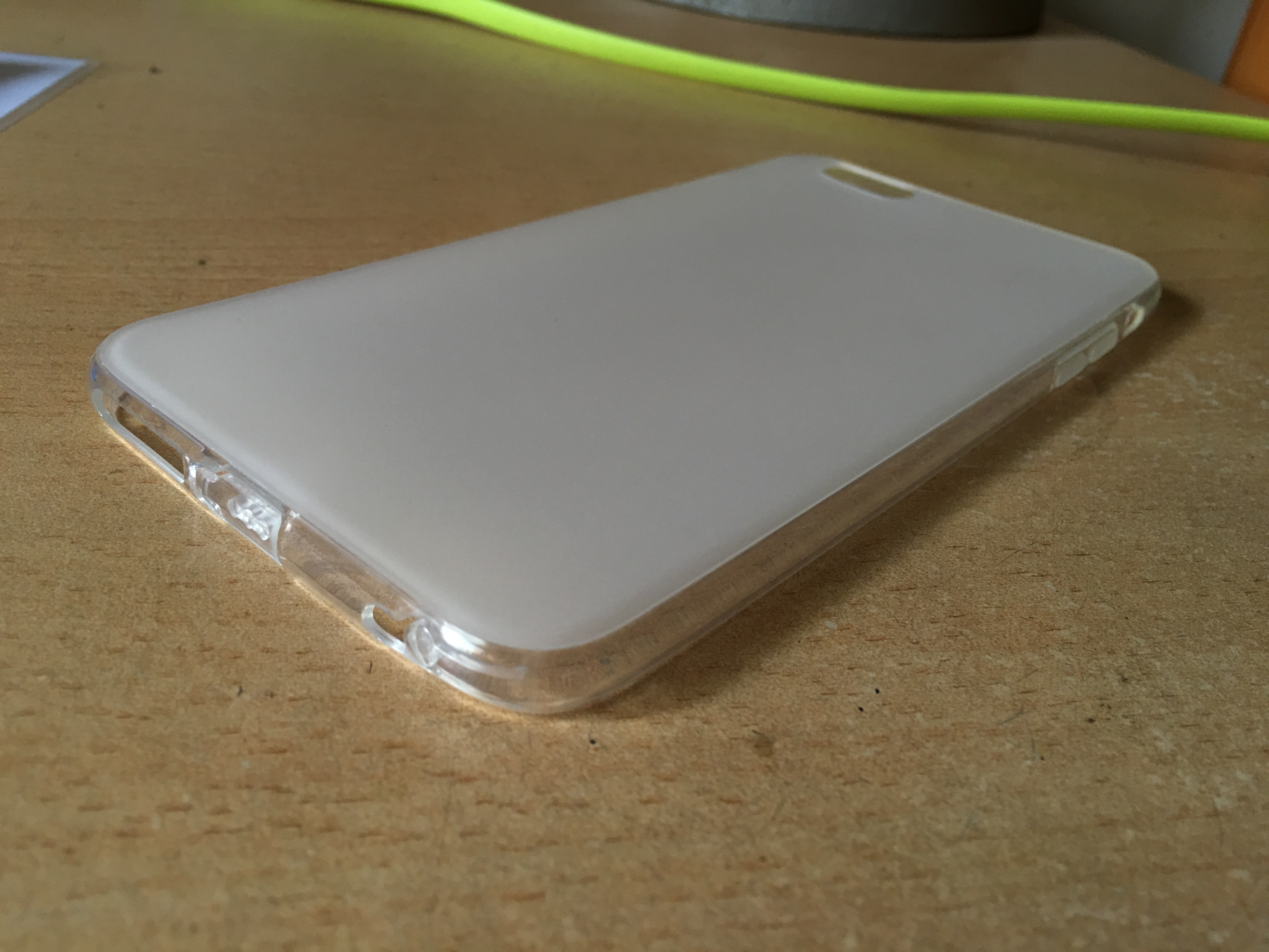

Thanks. Is that soft tpu, or a hard plastic around the edges?
It should be ok if it is a soft tpu, but if it is a hard plastic you might want to avoid that case. Not that it definitely causes damage, but those are never good for phones.
Given that you use both films and a case,you are probably a very careful person with your phone, and take good care of it.
It's soft TPU at the sides. Yes, I'm generally quite a careful person. The iPhone costs a bomb, naturally I'll be careful with it. Haha

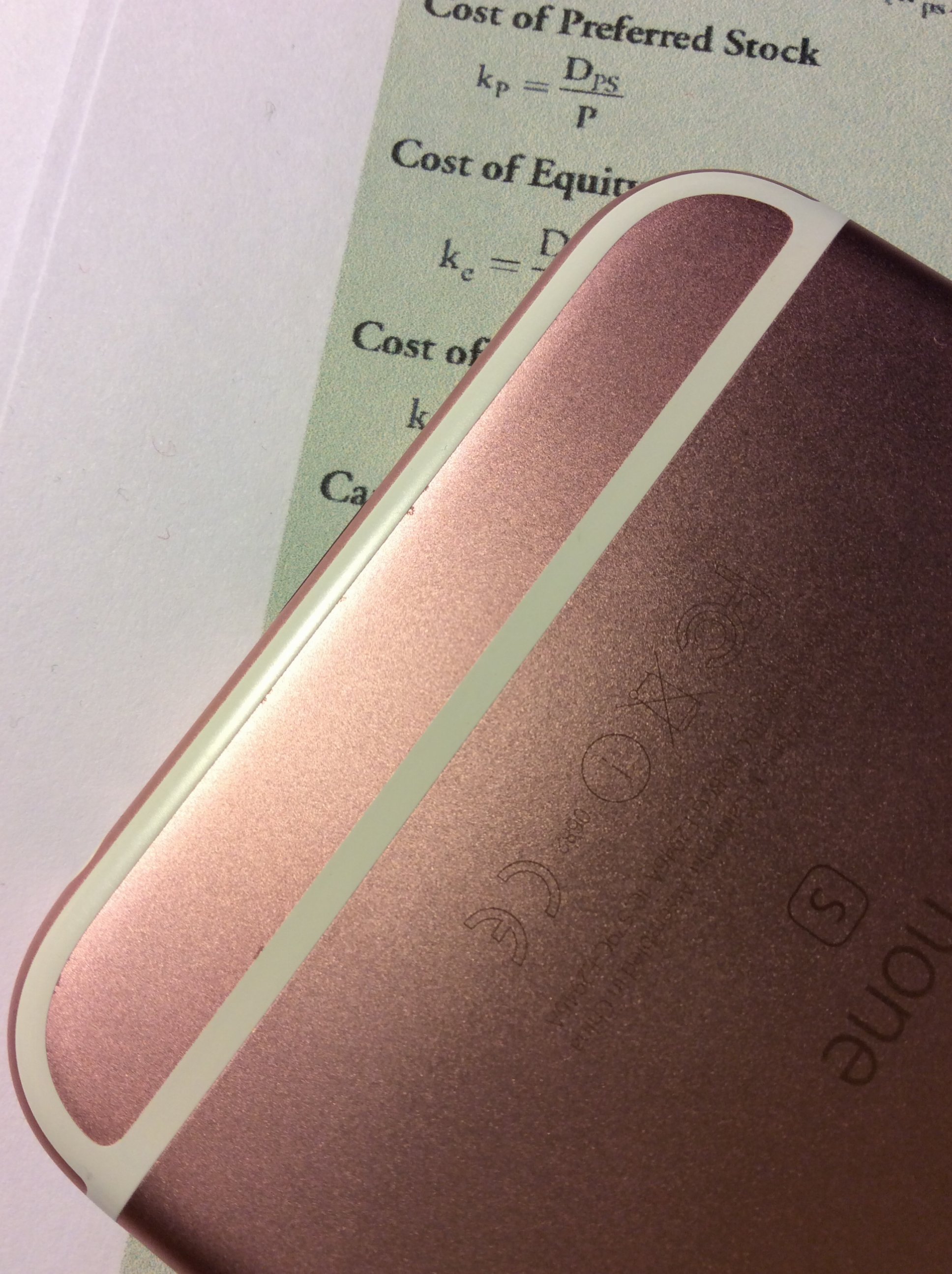

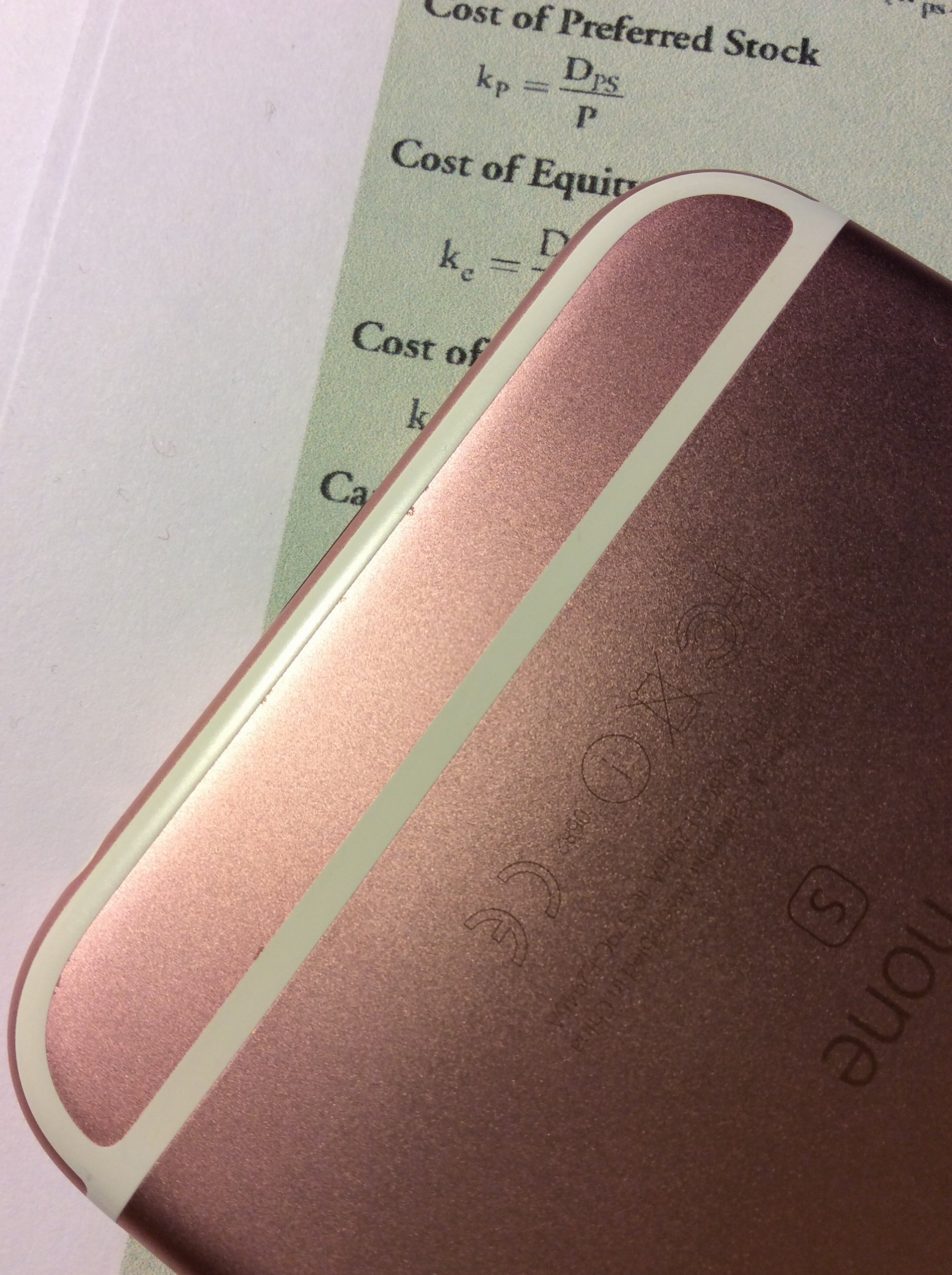

Having some experience with castings, forging and anodized parts the pits or voids seen are not caused by sweat or induced by a case. Those are most probably porosity breakouts from tiny bubbles in the metal. Edges would be particularly prone to this. A microscopic examination would provide definitive proof along with cross section cuts through affected areas. The other less likely cause is some failure in anodization process, although the pits look deeper than what the anodizing would go based on the limited pictures.
Pour temperature of initial castings, and the first casts are always rejected due to stabilization of molds, liquid aluminum temperature and any potential contaminant. Manufacturing stresses around drilled holes, and milled or ground surfaces will tend to cause these voids to break out more readily in those areas. Edges are particularly susceptible because there is no supporting metal on three quarters of surface when looking at it in cross section.
No question this is a manufacturing defect that got through quality control. These porosity voids can be just below the surface and not break out immediately. Therefore can get past inspection. As phone is handled the lack of material will cause the surface piece covering the void to break out. Unless you x-Ray every part, there is no way to detect these hidden defects. The lack of wide spread occurrence shows Apple has a hand on the process and excludes these defective early molds properly on each casting run.
These things will occur on a 70 million part production run. Neither Apple or the consumer is at fault here. It is the way physics and real world works regardless of marketing, lawyers, fanboys, or nay sayers. Since Apple exchanged the phone without even a second thought, the Apple system is working. The consumer is happy and further bellowing by non manufacturing experienced people on here is simply dogs howling at the moon.

Different metal, so solidification and porosity formation would be different. I would expect this problem to disappear as modifications are made to the mixture, temperature of the pour process. It could also have resulted in some initial metal mix composition variability. Also refined over time. The fact we have seen so few of these is indication that the foundry producing these cases has the process under control as so few slipped through.
I have seen castings that were good for years with only one or two percent porosity, suddenly show 30 percent if ovens are changed, molds modified, mixtures of metals varying. This is as much an art as a science. Any time something changes like going from one type of aluminum to another, their will be teething problems. Based on the numbers and the easy exchange Apple made, this is really a non issue to be concerned about.
Additionally, who is to say that this didn't happen on the iPhone 6. You do realize what a small percentage of iPhone users are on these forums. It is quite likely that somewhere around the world someone got a similar problem with their iPhone 6 and exchanged it. Only Apple would know for sure and no manufacturer I ever heard of would publish such information. This stuff is highly proprietory.
