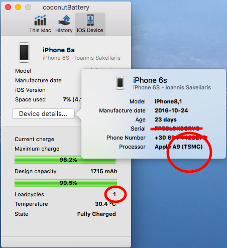

After two weeks in the Apple reseller in Greece they told me that the iphone went to Apple Netherlands and there was a change to a brand new with TSMC chip
I think Apple CHANGING silently the models with Samsung chip with new with TSMC chip
I restore now from cloud
I will return with news when I finish.

Somebody already posted on here that same thing is happening with TSMC chip.
