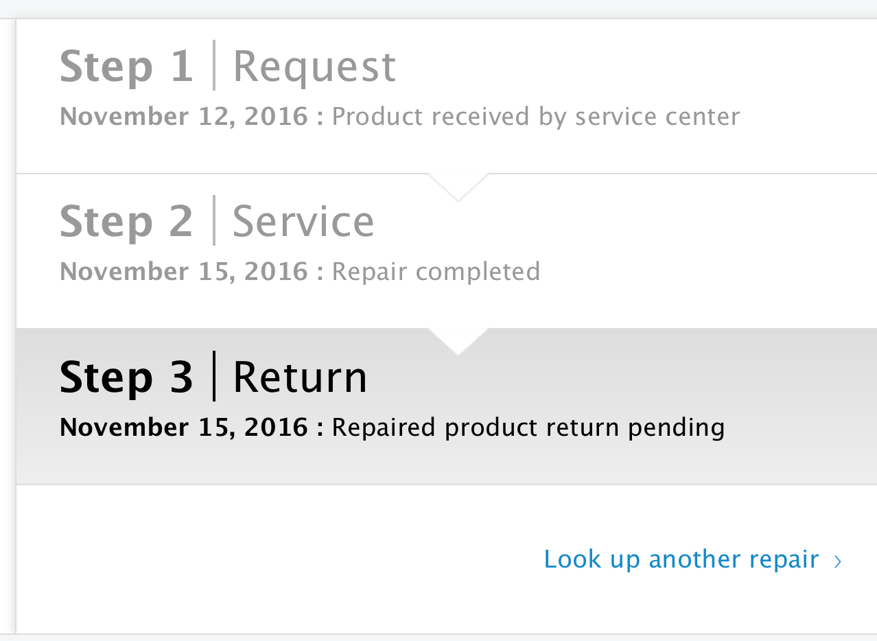

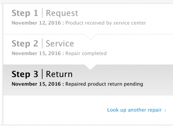

I think I’m getting my phone back in a couple of days. I wonder what the repair summary is though.
