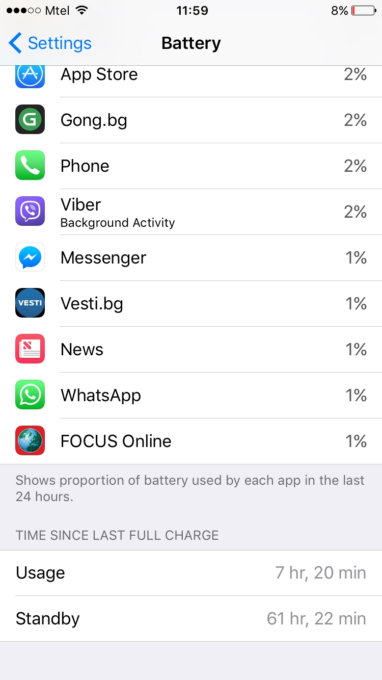

I've had my replacement phone for a while now, and the problem has gone away completely. Battery performance is MUCH better overall.
Same here, went several times all the way to 0%:
