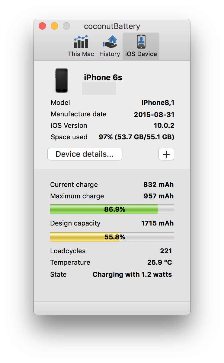

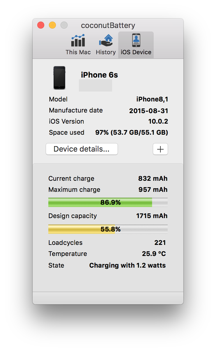

Interesting to see this.
I came looking around here, since this started happening to me 3 weeks ago and has been an issue ever since.
According to coconutBattery my iPhones battery must be seriously degraded.
Did the calibration, but to no avail. (I can't even let the device run down to 1% as it'd usually shut down somewhere between 10-30%).

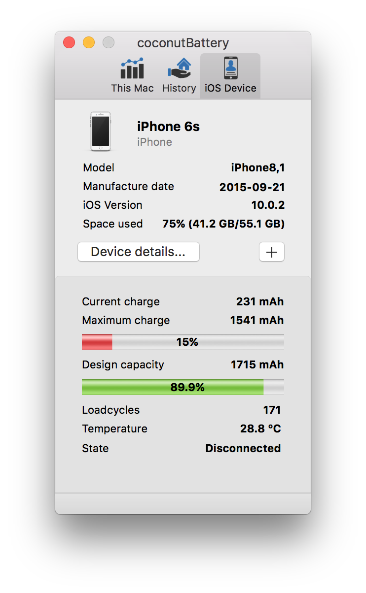

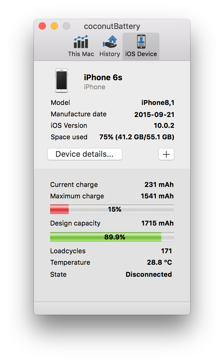

Here is my screenshot. The battery does not seem to be corrupt.
I calibrated my 6s on Sunday, at first everything seemed to be going well but today it died at 30% 🙁 As always, after that happened I plugged it in for a minute and switched the low power mode on. It worked for several hours after that and I plugged it in again when the battery indicator reached 1%. I have then tried to reset all settings but am not sure if it helped. I definitely wasted some time setting it again the way I’m used to, so please let us know if restoring as new does any good.
