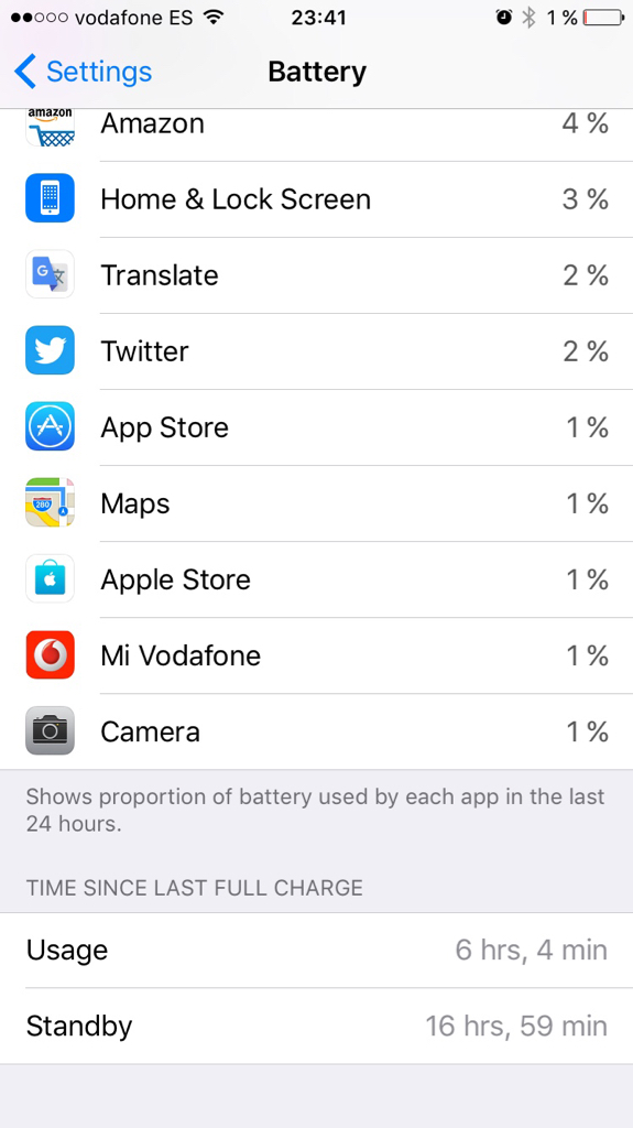

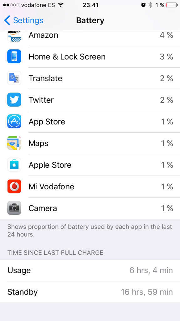

In my case, I'm really confused because two nights ago I updated to 10.1 and 24 hours later, my battery was extraordinarily good. It's use was the following (see the pic) and I wanted to see how long the iPhone was working with 1%. I did a lot of things in order to waste it like play games, watch videos on YouTube and all typical things you know dry the battery and it worked and worked and worked. I'm very surprised but I don't want to be happy till several checks.

Good news, maybe with this update the issue is resolved! Me and my wife have iPhone 6s (mine with Samsung chip and the other with Tsmc), but they have 9.3.5 because i'm afraid to update for this problem. Do you have Samsung or Tsmc chip?
That’s just how it started for me. After the 10.1 update I thought I saw an overall improvement in battery life, then I ran it down to 18% and it shut down.
This is what happened to me as well. It stayed at 1% for about an hour of usage and 8 hours of standby. Super weird.
Now it's back up, reported "Capacity" seems to be higher again, too. I'll wait and see how this pans out, going to let it run out of battery again which will hopefully - fingers crossed - at 1% this time around and not 20.
