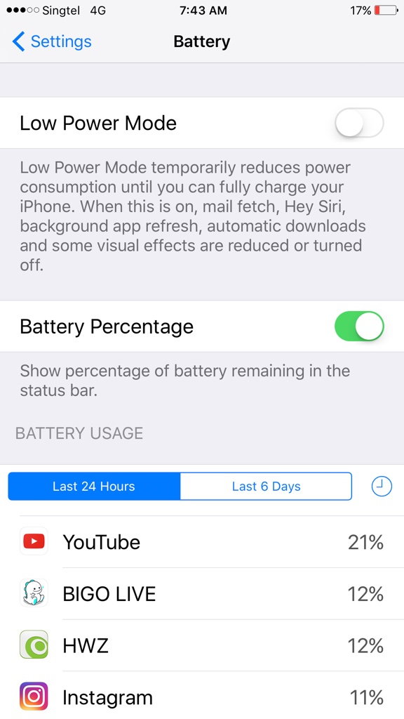

This is a good test considering I watch videos a lot, game like hack slash mmorpg, various social media app and manga reading.....
BIGO Live use a lot battery power.

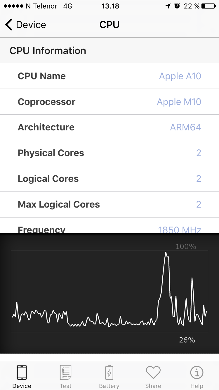

My own iPhone 7 drains around 2% per hour on standby with pretty much everything possible turned off. We have another iPhone 7 here set up the same with the same ios10.1 but that only drains around 1% every 2 or 3 hours on standby.
The phone that drains was set up from a iCloud backup of a 5s and the phone that doesn't was set up as new. So assuming it was down to this I thought I'd bite the bullet and do a full DFU restore yesterday and set up as new phone. Well this has made absolutely no difference at all it still drains 2% every hour on standby and I don't see how this can be software when it has a complete pure clean reinstall of all software/firmware via DFU mode set up as a new phone without most of my old apps installed on it yet. The phone that doesn't drain is running the same software/firmware, is the same hardware (intel version iPhone 7) and actually has more apps installed and more background stuff switched on.
My conclusion is that if a DFU restore and set up as new phone doesn't fix the standby drain problem it's a faulty phone and needs replacing. I wonder is Apple will accept this and swap it?
Edit: Just to add if anyone with an iPhone 7 with no standby battery drain issues could check cpu usage on the battery life app with all other apps closed via app switcher first .. here's mine on the iPhone 7 that suffers 2% battery drain per hour ..

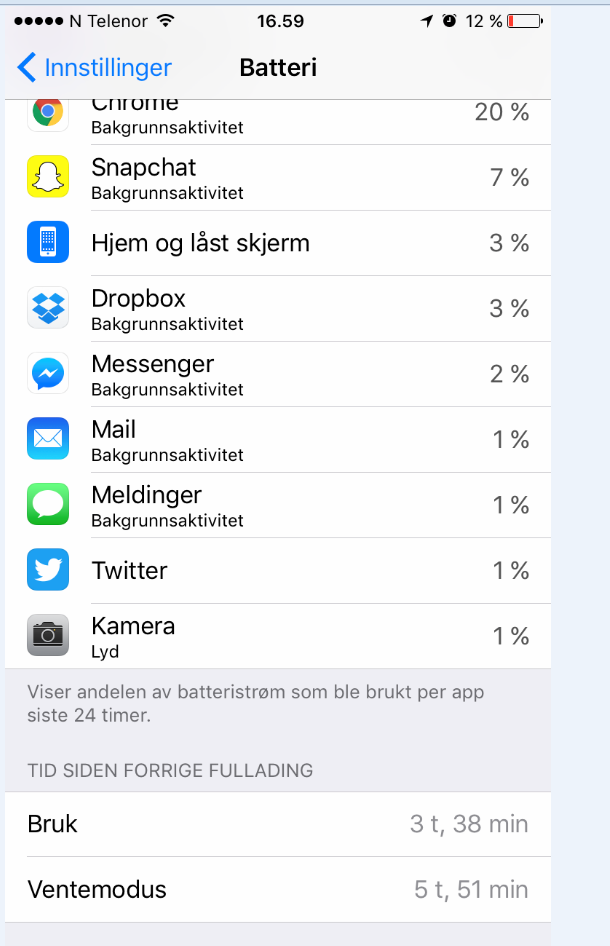

Been AFK from this group ever since upgrading to the 7+ (Much better battery) but I've noticed something funny with my 7.
Wiped it over the weekend, put it on charge and once it hit 100% took it off and put it away. Turned it back on a day later, it's on 10%.

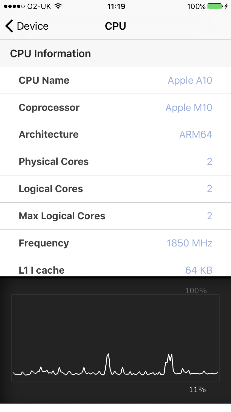

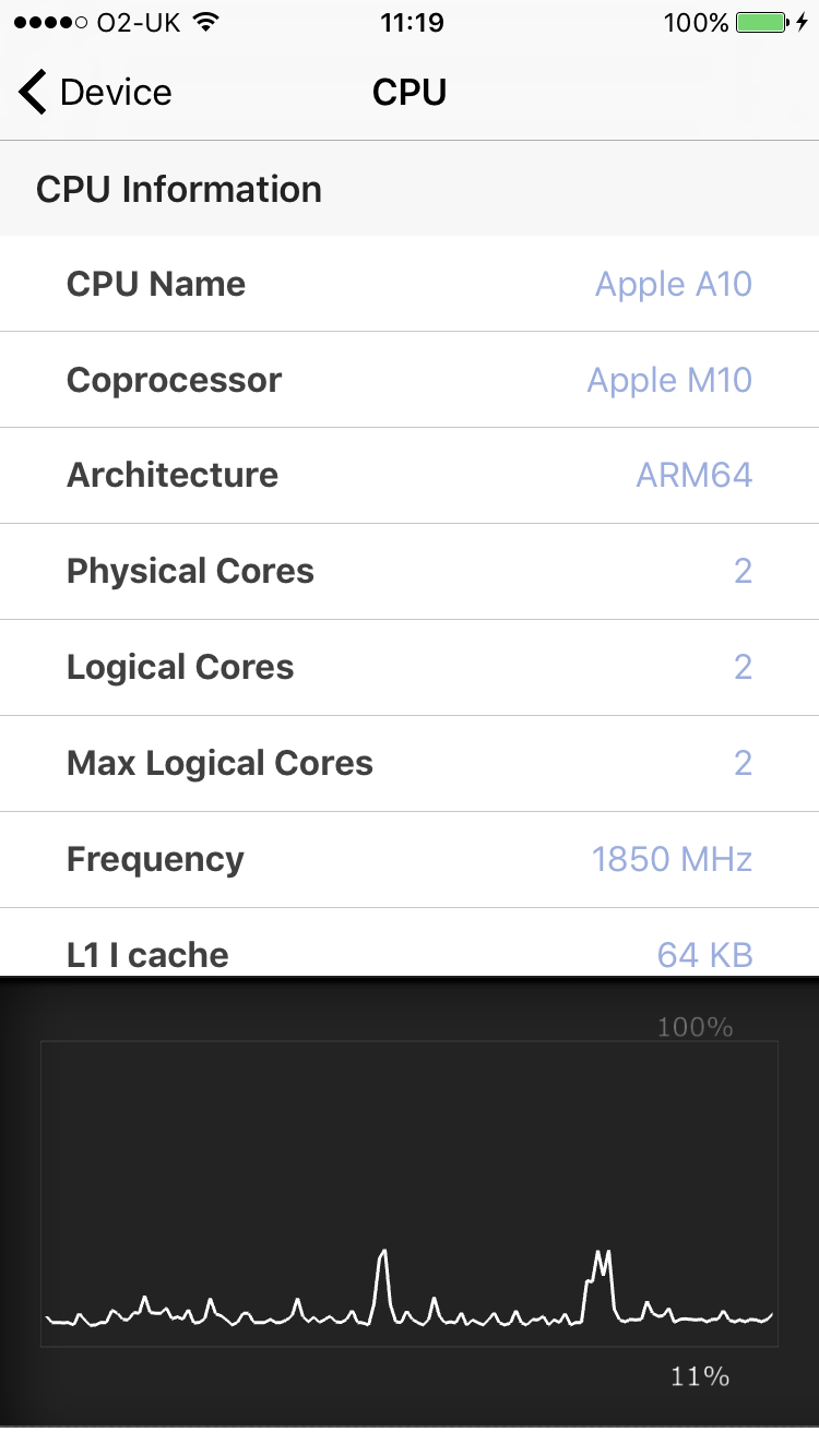

So how does that look on the non-drain phone?
It flutters between 5 and 20 percent here all the time.
Where do I check that on the phone?
Unfortunately I won't have access to the non drain one again untill Saturday now.
Mine that drains fluctuates mainly between 8% and 12% with occasional higher spikes, so your 5% minimum is a little better .., the lowest I've seen is 7% on mine.

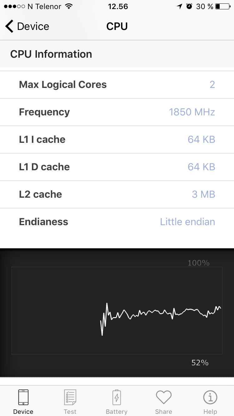

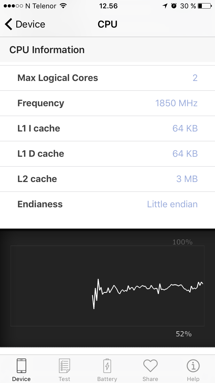

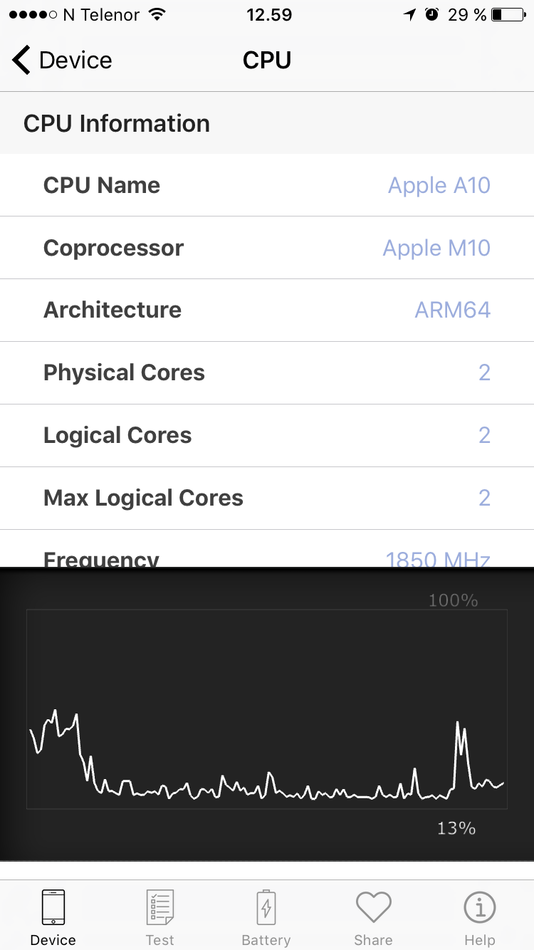

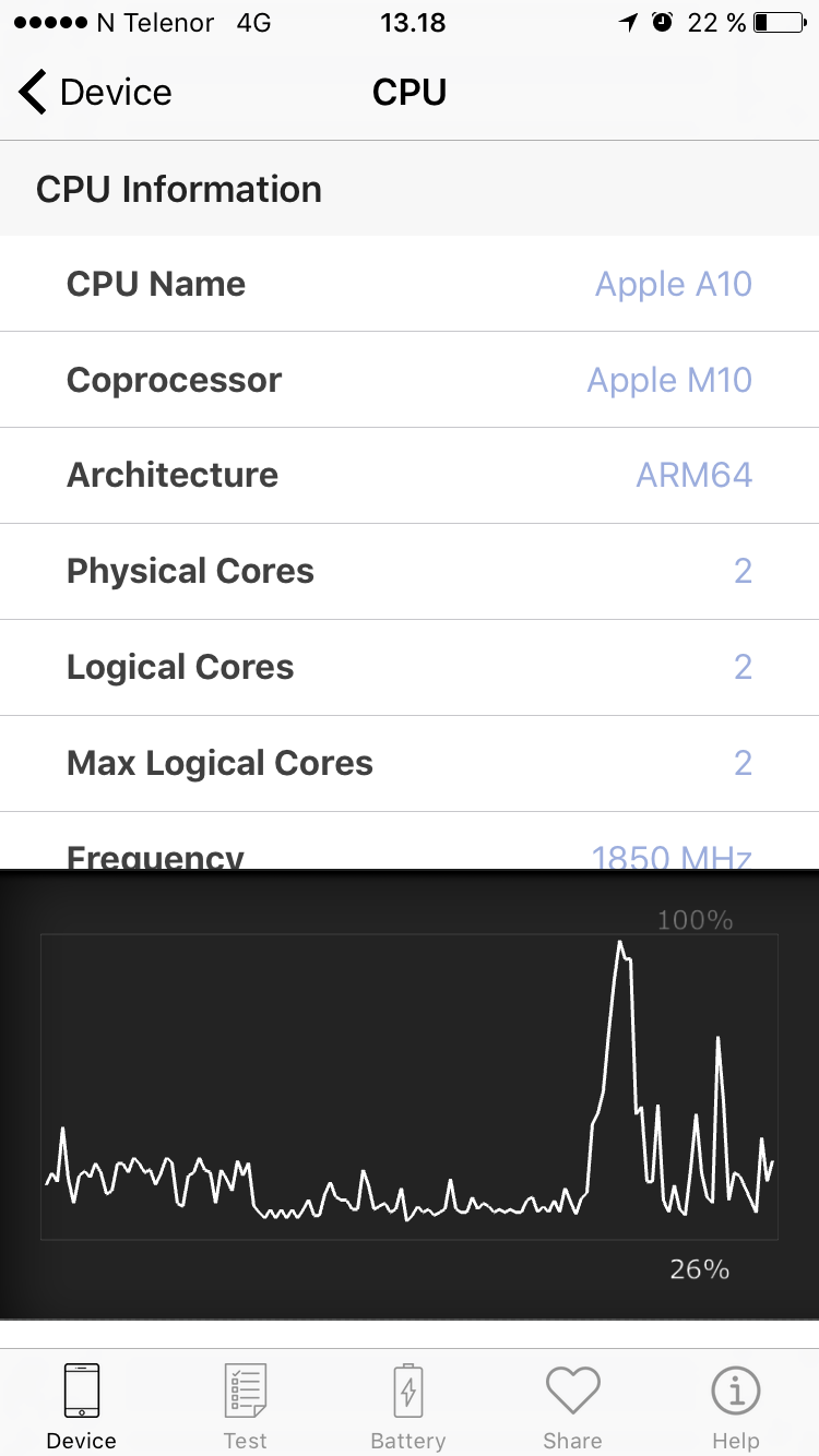

Hmm, mine is never under 40%?
Closed all other apps...

I honestly think that's normal. I will open that app on my GF's SE tomorrow; she has OUTSTANDING battery life (like 4 days outstanding with normal usage count).
Alright; just tried running the battery app while on power; on power (plugged in) it doesn't go under 10 percent, sometimes 7 as you said. When I take the charger out and wait for a bit it settles at 5-10. I guess this is normal behaviour; the phone is allowed to use more cpu-time when powered.
Also interesting; I put the phone in airplane mode and checked my usage times; they where at 4:40 at the start. After 10 minutes is was at 4:45. After another 10 minutes it was at 4:45, then after another 10 minutes; 4:45. Interestingly; the "drain" seems to be a process that needs to finish a task of some kind and doesn't repeat itself without a connection.
My battery is still rated at 2020MaH, which is more than the 1960 the battery is rated at, so NO hardware fault here. Maybe I'll try using xcode to take a look at things later, but the activity monitor seems to be taking up the most cpu time when I tried that before with other processes not being very interesting at all.

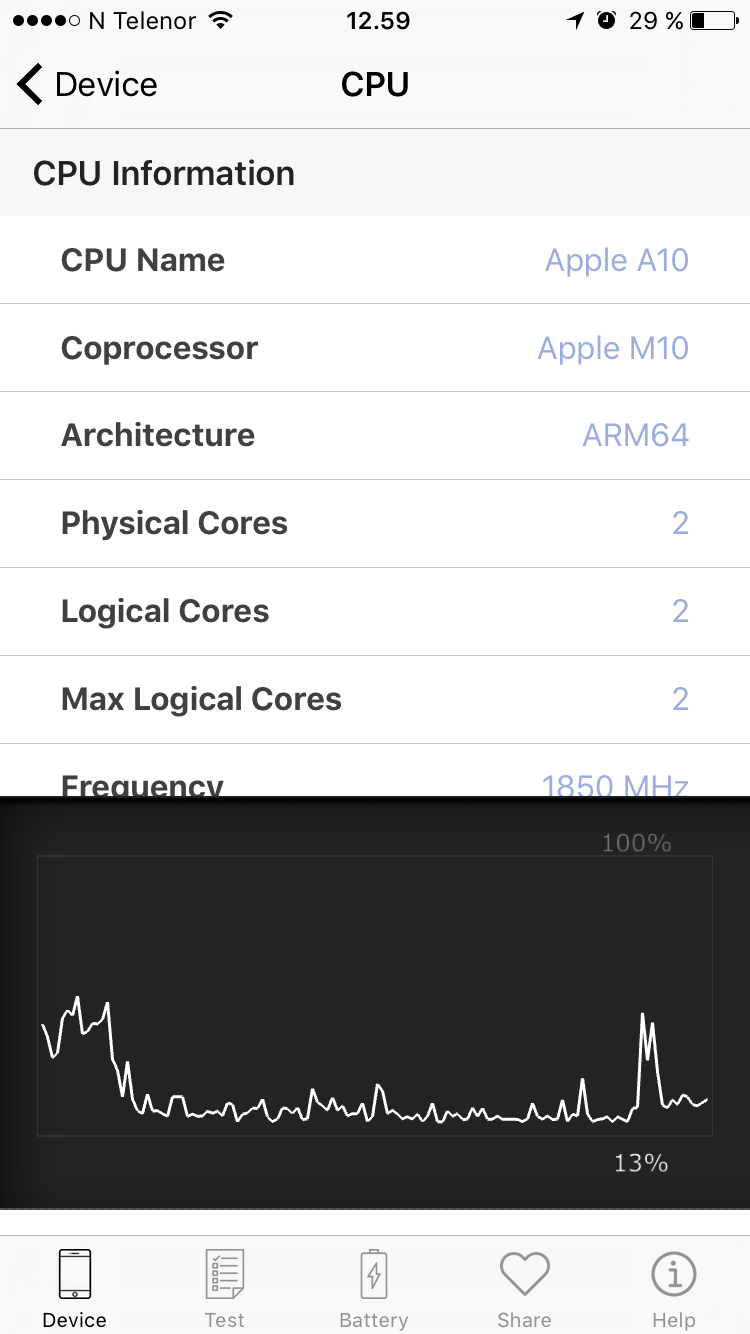

Here is what I get straight after an reboot and closed all apps.
This is sick stuff to watch at, no wonder my Battery time sucks...
Its never under 10% and spikey as hell.
[doublepost=1477916801][/doublepost]Since I started This testing now my phone has used between 15-20% of the battery....
Check under memory now ..how much is being used with all apps closed? Might take a few mins to settle after a reboot as well

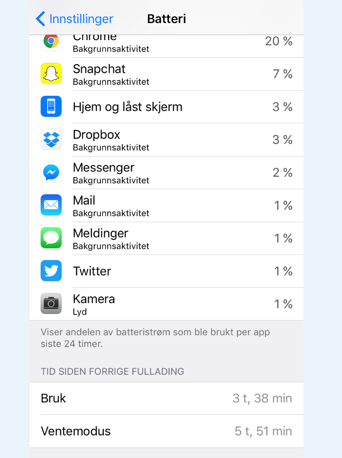

I have the same problem with nothing showing unusual under usage .. Usage doesnt increase with the standby drain on mine either so no clues there unfortunately
