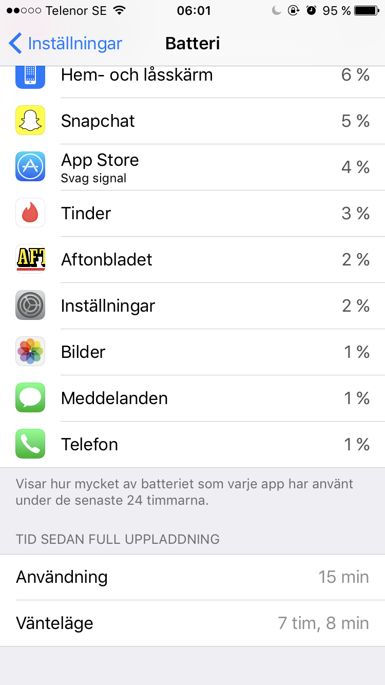

I disabled Siri last night, did no full charge (phone was at 99 from the idling before) and left it.
After 7,5 hours of sleep the usage stat said 8 minutes now, instead of the 23+ minutes it normally consumes. Battery was still at 99.
This probably doubled my standby time. But I'll test it throughout the week. It sucks to not have Siri though. But if that means no charging throughout the day I'm fine with it.

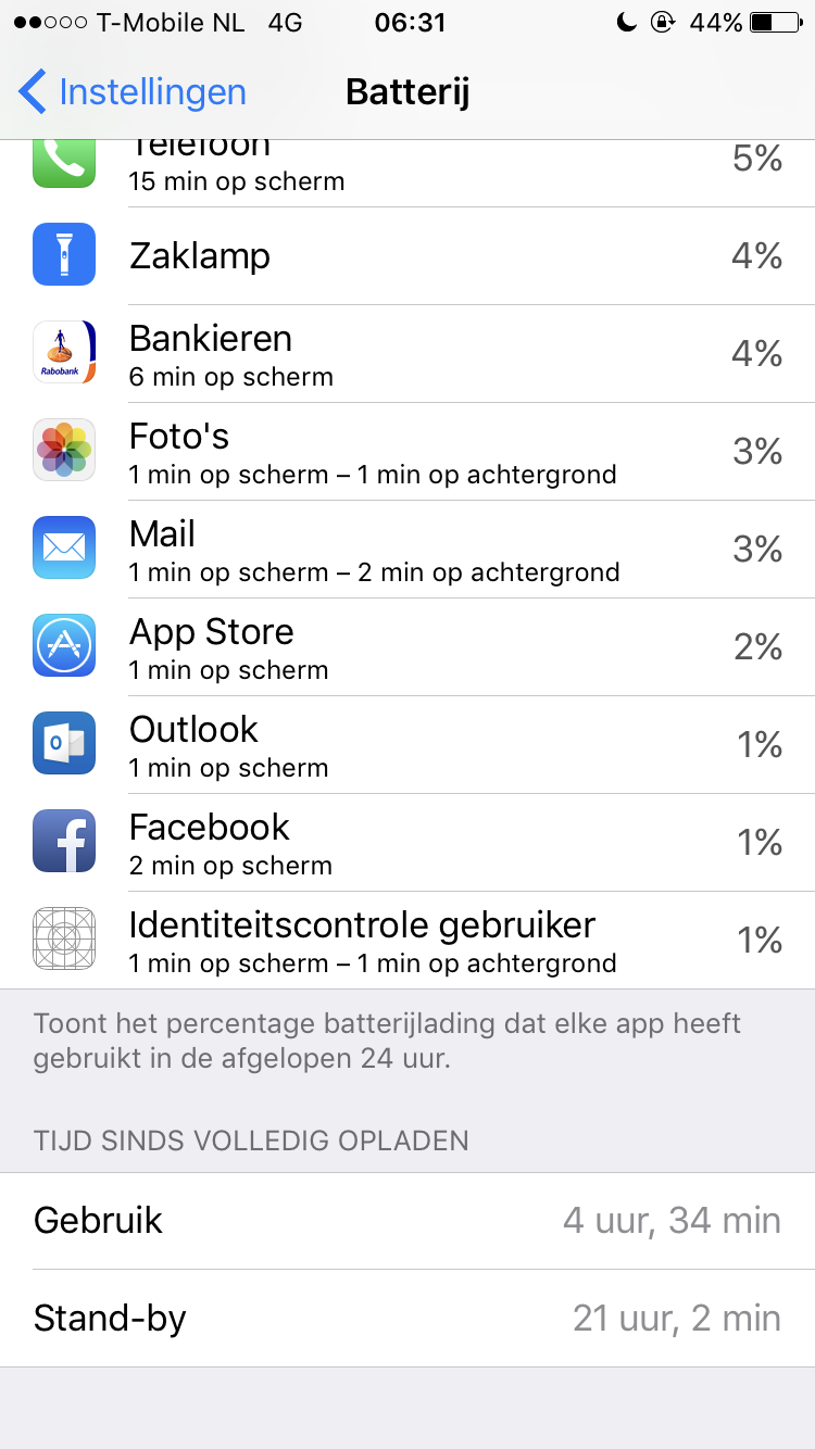

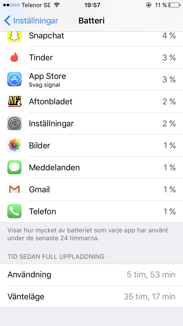

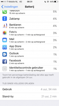

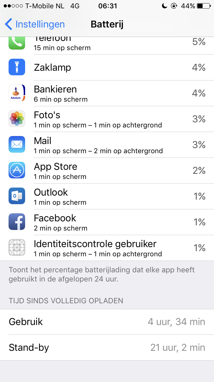

Guys!
I found the solution to my problem. I have to disable Siri!!!
Having Siri enabled racks up 1,5 hours of usage during 20 standby hours and drains with 1-2 percent an hour in standby. I had to charge around the evening everyday. I disabled Siri yesterday morning and woke up today with 44 percent remaining from the charge from the day before. Overnight I only dropped from 46 to 44.
The usage stats are now also correct, no padding at all. 4,5 hours of usage on 21 hours of standby at the moment. I used it more than than normal! No more 6-8hours "usage" by doing not much at all.
Today I'm going to fully charge and enable Siri to make comparison screenshots at around the 21 hour mark. That way I can show apple what I found out.
I would suggest trying this on your phones as well.

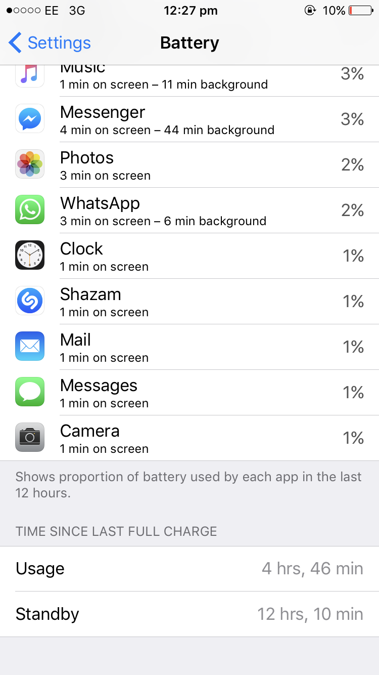

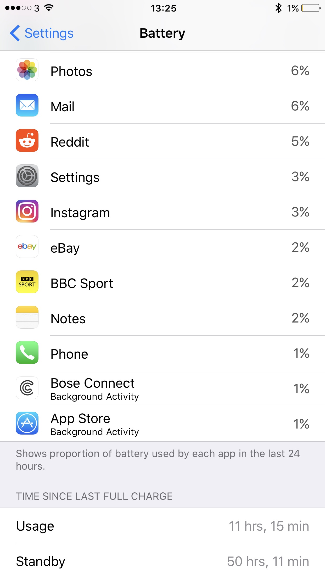

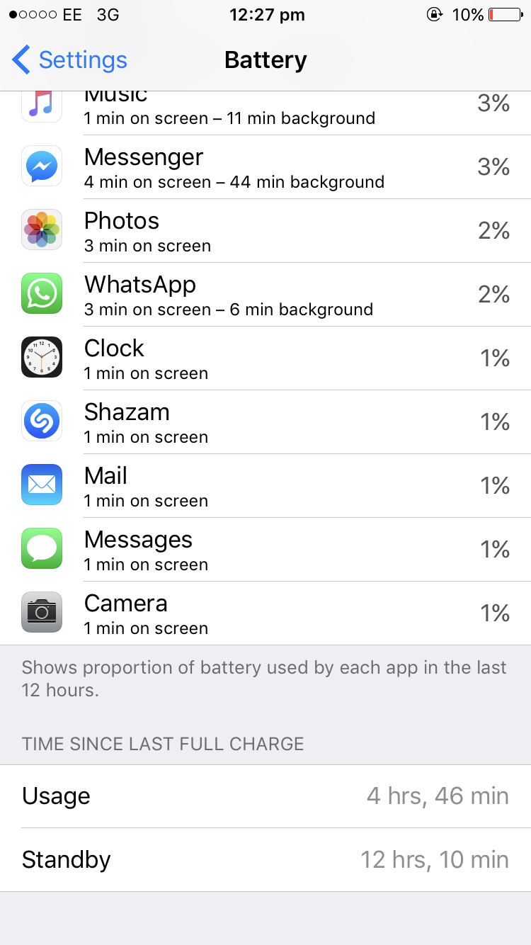

Surely this battery can't be okay? Started using the iPhone 7 yesterday from brand new, backed it up from a previous backup from 5s, noticed the battery was draining quite fast, set it back to factory settings blah blah blah, getting this amount of usage and standby time? Is this normal? Am i being too picky? Surely we shouldn't have to disable most features the iPhone 7 offers?
Any Opinions???
Any Opinions???
During the first few days, your phone will spend a lot of energy on indexing all the data from iCloud, apps, etc., which of course has an impact on battery life.
On top of that, I presume the battery isn't fully charged when you start your new phone the first time.
We're you in a similar situation?
Yes when i booted the phone originally i had 70%, i charged it fully to 100%, used it until near death charged it to full again and that's when I screenshoted the usage etc.
I thought so. Normally, this should improve after a few days. If it doesn't, you can go to an Apple Store?
Ah great thanks for the advice! Do I have to let apple/the store know before the 14 day return policy? Or does that not count for a faulty phone?
Give it a week or so and a number or charges to stabilize. As far as Apple, if you just got the device you might be under the extended holiday return period so you might have even more time (you should check your receipt to make sure).

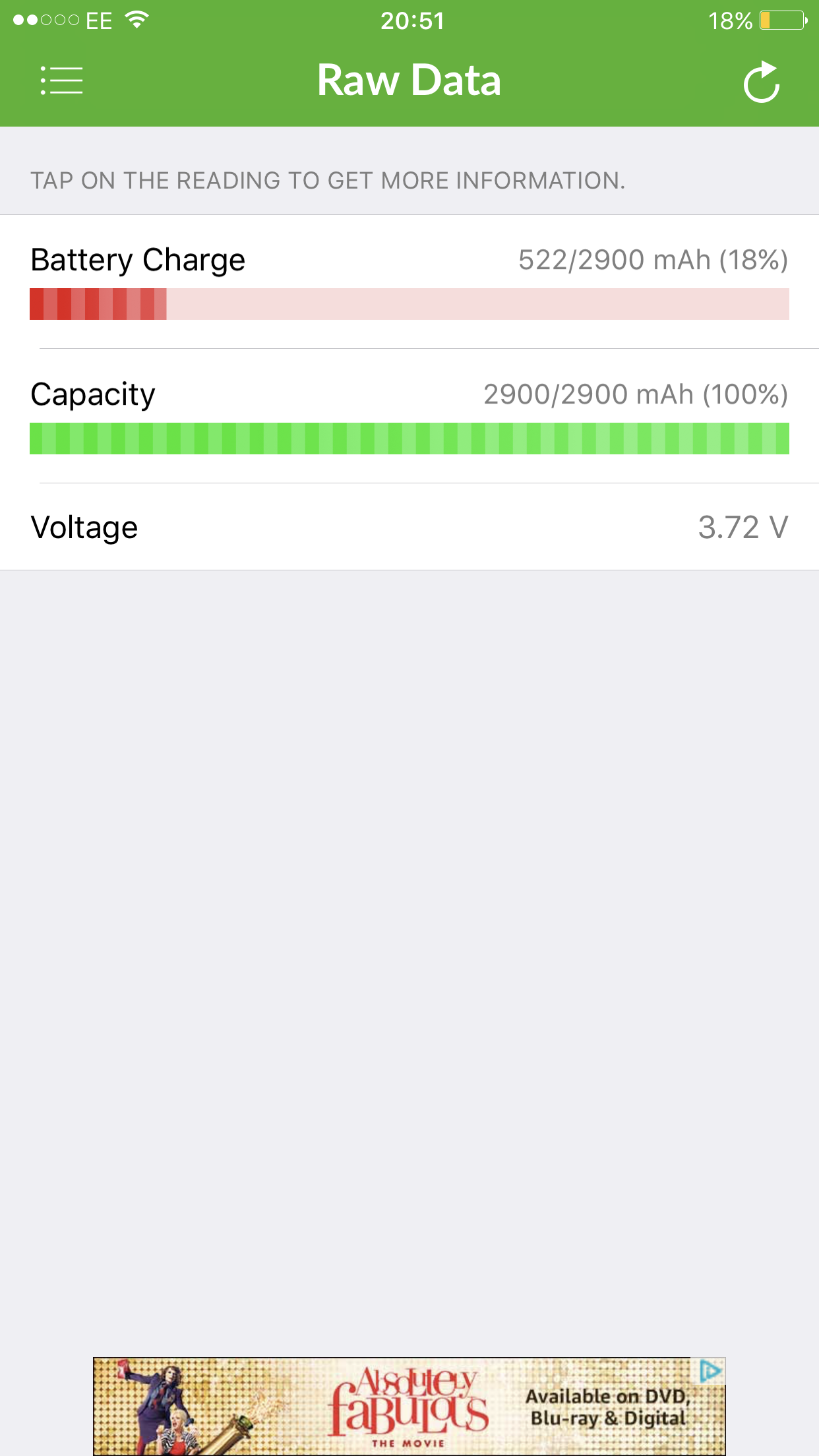

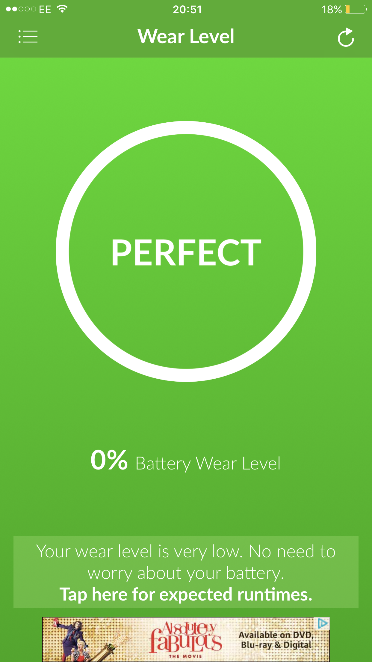

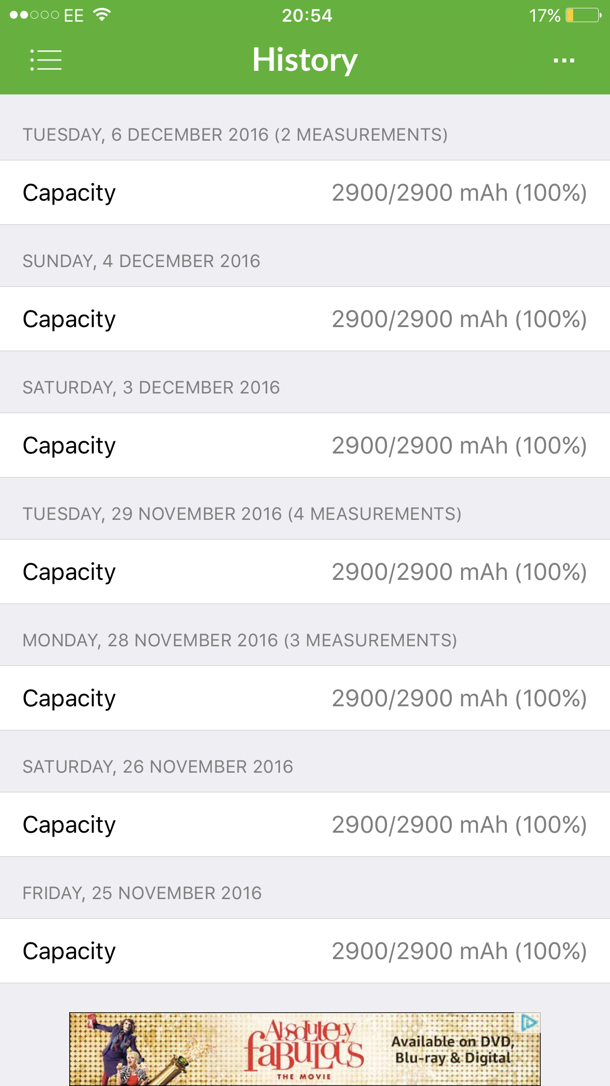

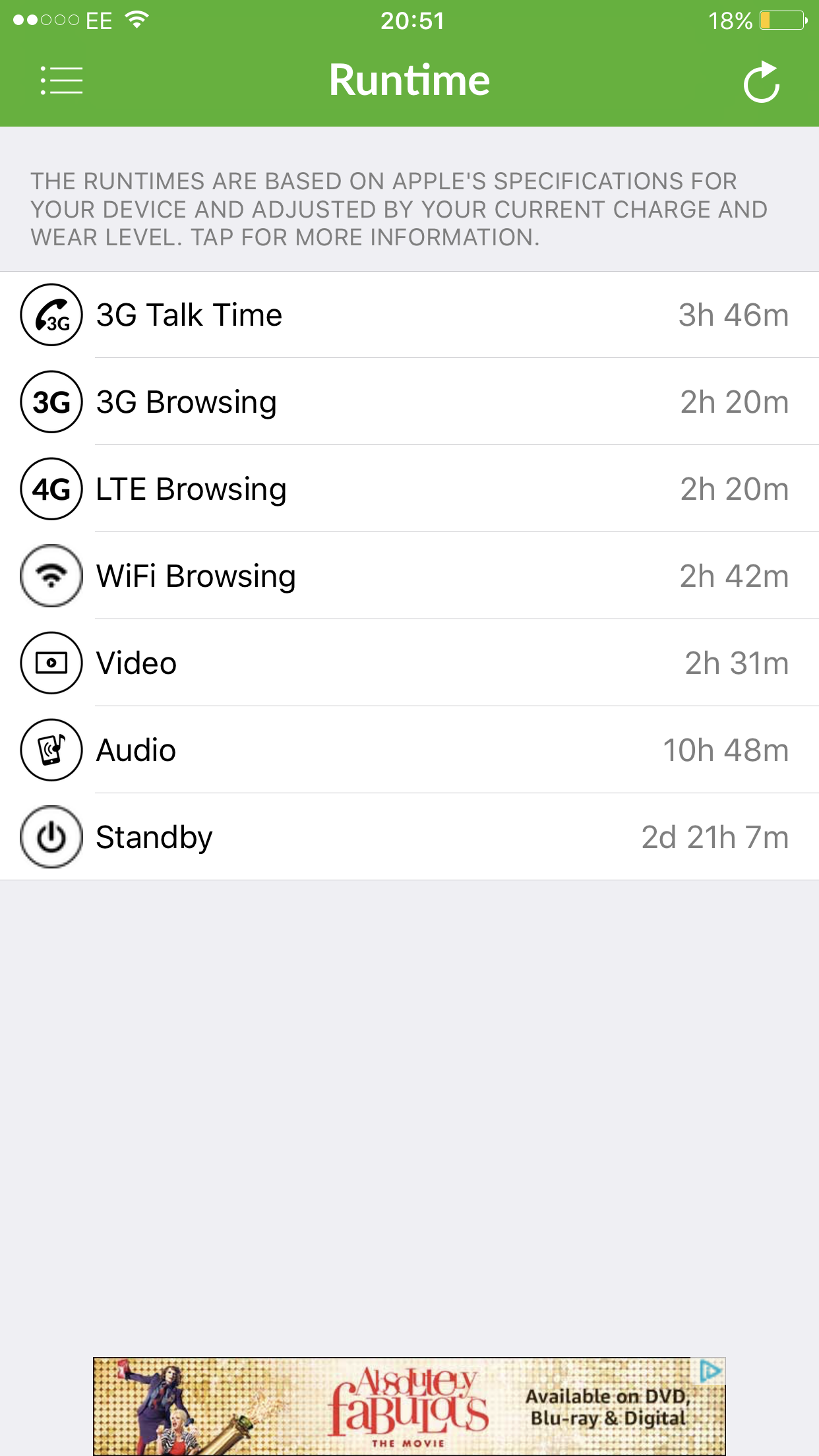

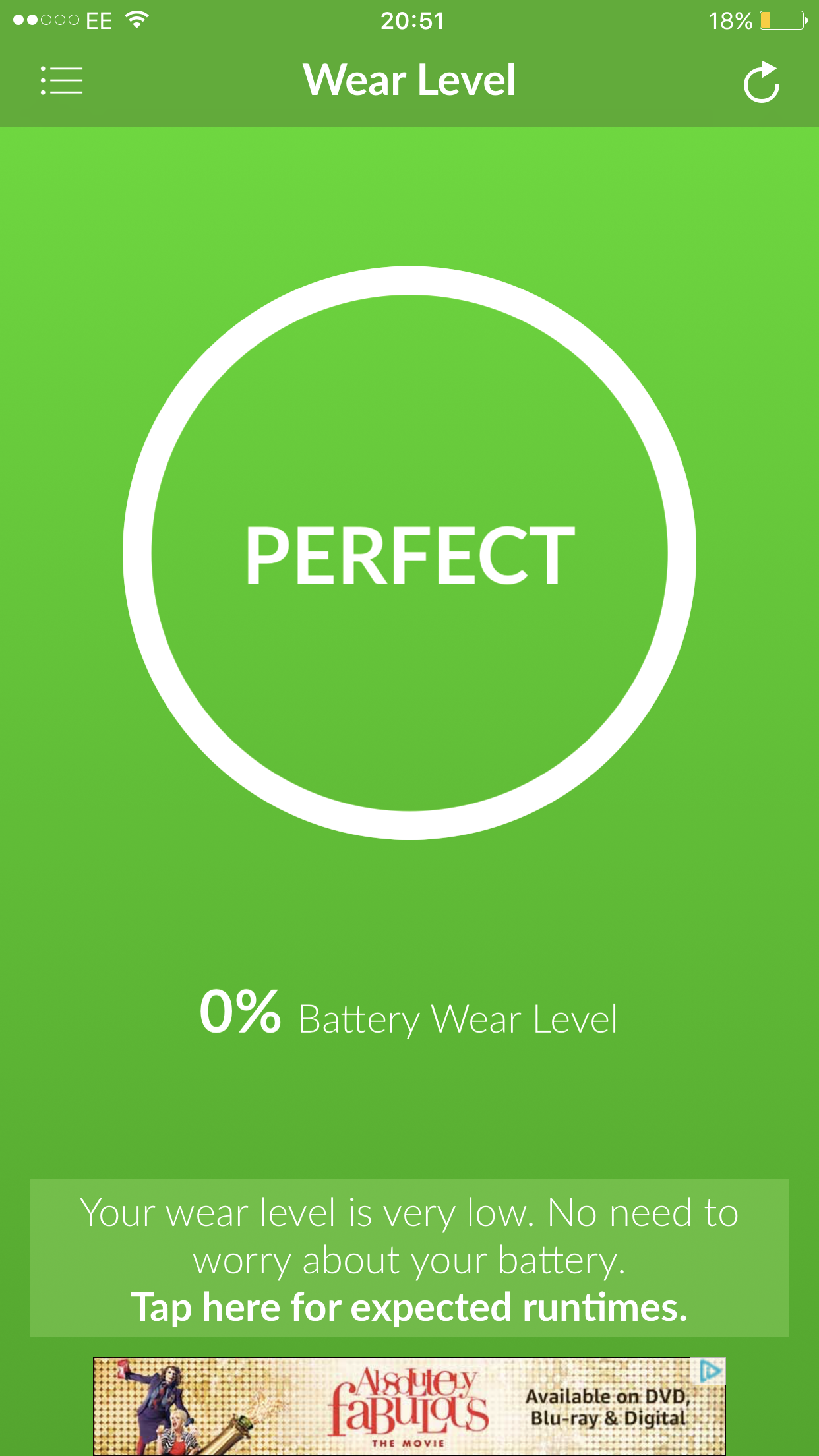

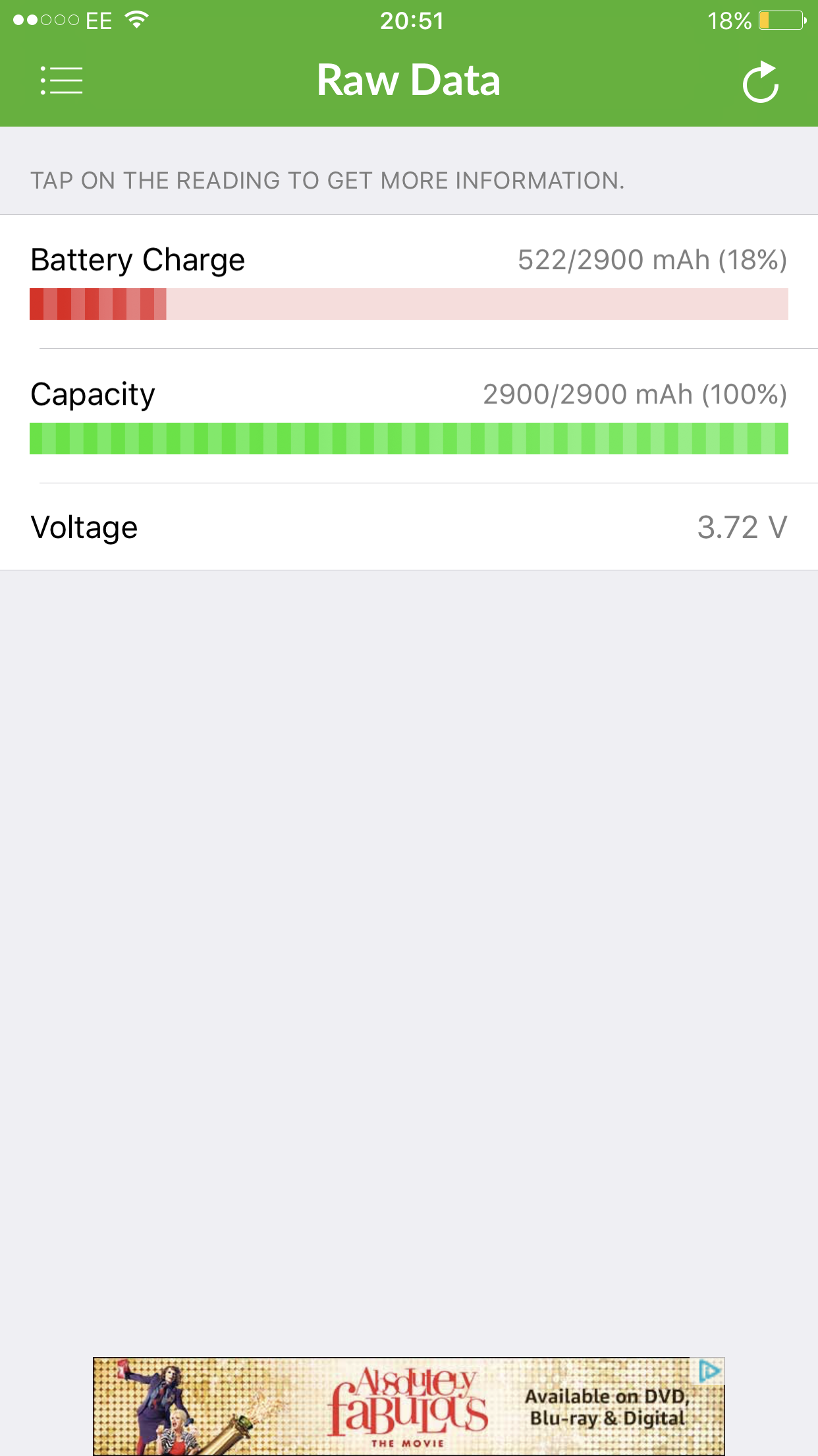

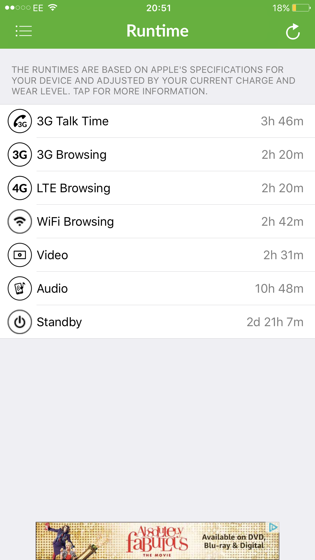

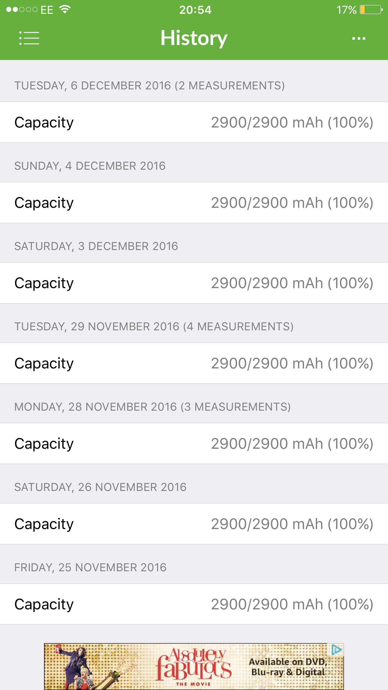

Here are my latest stats for my phone using the battery life app.
Had my 7 Plus 256GB for 2 and a half months and never once had my phone die at random percentage. Must be doing something right.

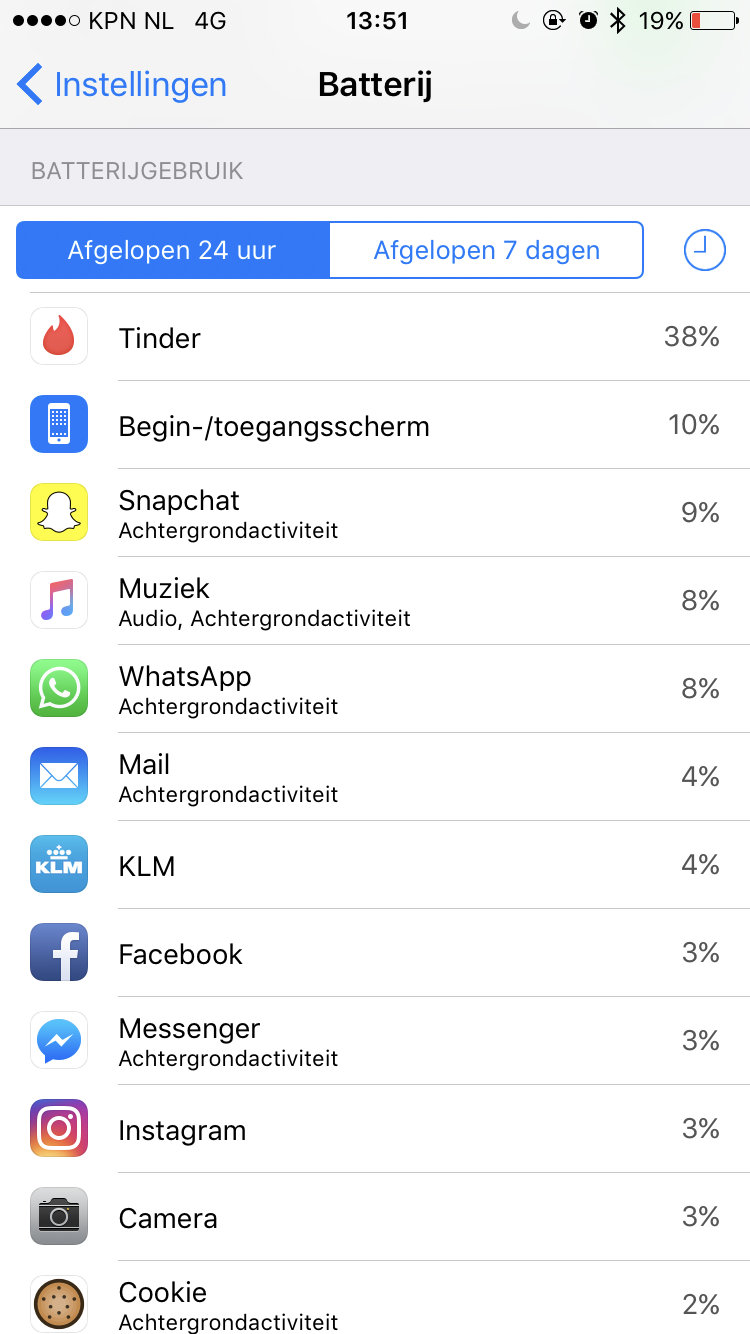

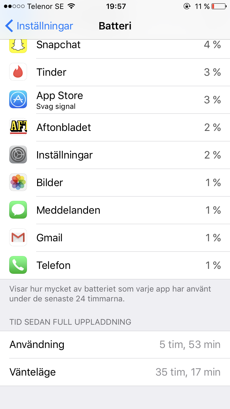

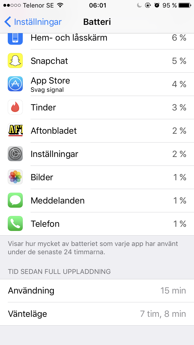

This is my biggest problem with the battery life. The standby time. Around eleven i unplugged my Iphone fully charged and only used it a couple of minute (wifi-browsing, checking Instagram etc). I lost five procent on seven hours. Is this really normal?
Seems okay if you didnt start at 100. Otherwise it's not okay.
