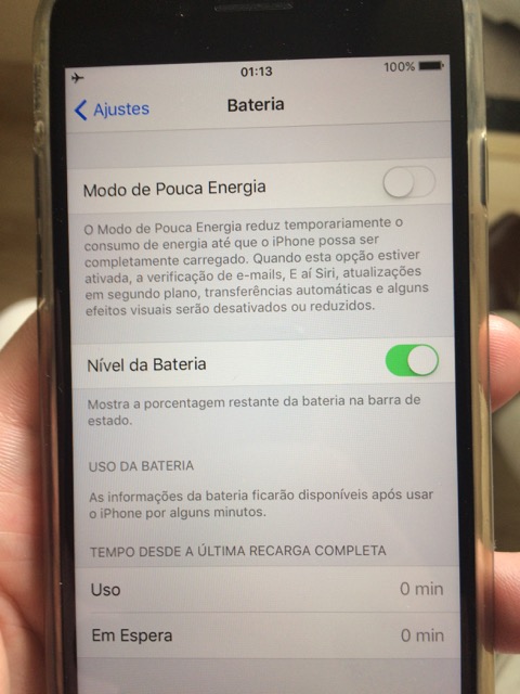

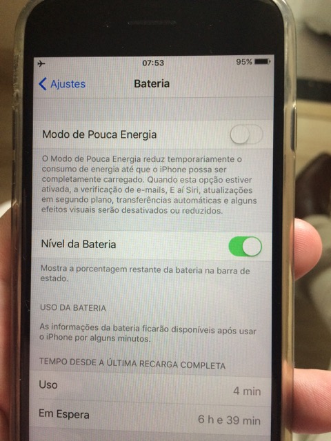

Hi.
Recently I bought a iPhone 7 with 10.1 iOS version and I realized that it had a very weird battery consumption.
The first thing I did was update iOS to 10.2 and did reset all settings, but the battery behavior not changed.
Yesterday I did a long test and I would like to hear an opinion from you if you find it normal or really the consumption is weird.
How I tested:
Did a DFU restore and reinstall 10.2;
Restored it as new;
Not logged in iCloud;
Not restored old backup;
Not installed any apps (i. e. only native apps installed);
Charged up to 100%;
I turned off Raise to Wake and Auto Brightness;
Put the phone in airplane mode;
Unplugged charger;
And went to sleep;
Result:
- After 6h 39minutes (standby time)(see attach)
- 4 minutes In Use (see attach)
- Battery decrease 5%
In my humble option this is too much for a device that stayed 100% standby with all the default settings, no icloud sync and only standard application installed.
For comparison purposes I did the same test with iPhone 6s (iOS 10.2), 6 (IOS 10.2) and iPhone 5 (iOS 10.2) and all of them got 100% battery.

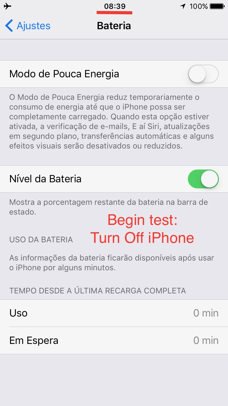

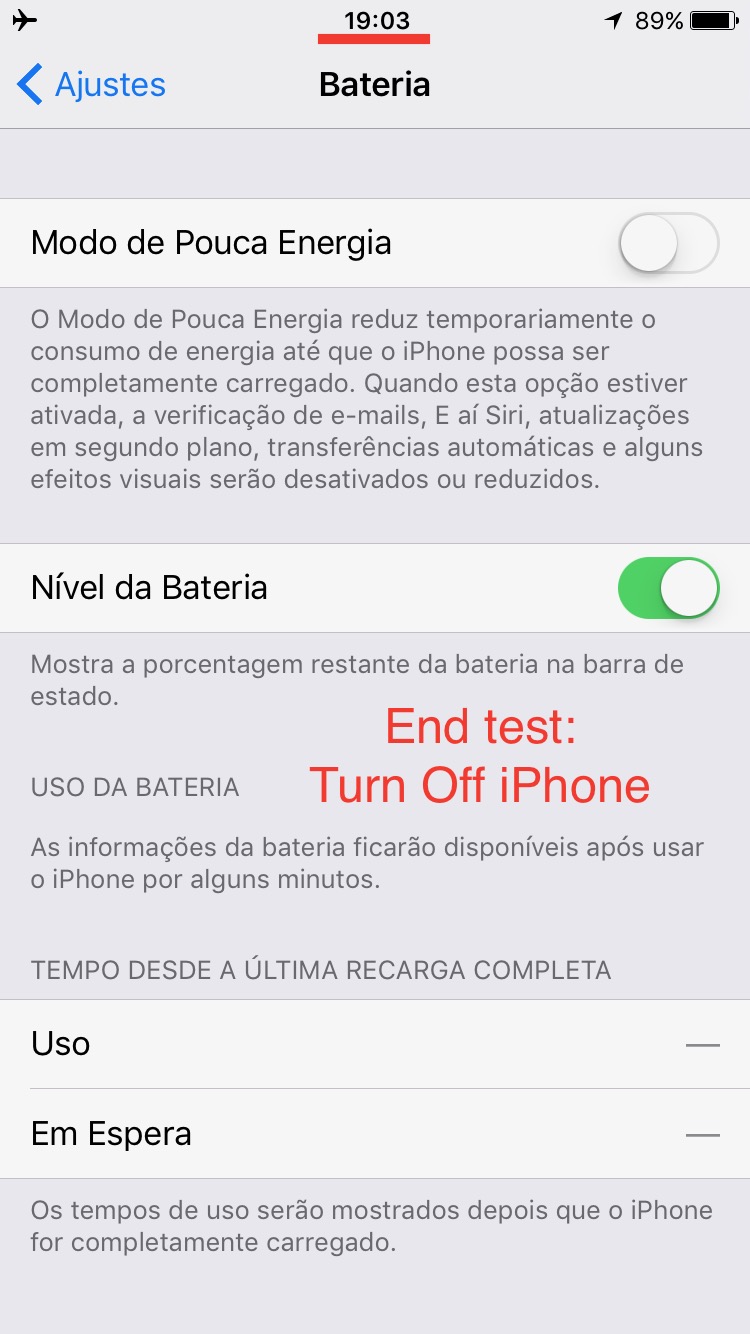

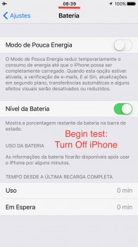

Update:
OMG!!!
After 10 hours, 24 minutes completely off my iPhone lost 11% battery... again.. completely off!!! (before turn off I put it in Airplane Mode)
IMG_0010.jpg: take screenshot before turn off
IMG_0011.jpg: take screenshot
Update:
OMG!!!

But in this case the device has been turned off all time, i.e, theoretically all features/service should be turned off.
The purpose of this test is to see the battery life with all the default settings and the device turned off.

Right, I understand that part. Perhaps something's off with the battery itself?
If it's draining 1% per hour switched off there's some kind of hardware fault. I would take it to an Apple Store and explain your phone has excessive standby drain and it also drains while switched off so it's not a software or app issue. They should give you a replacement if the battery shows ok on their diagnostics due to them not knowing how to fix the issue (could be any internal part draining it if nothing shows on diagnostics).
