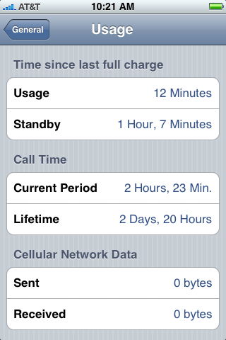

Hi Guys,
I just found out a solution for this problem, that many people including myself have been having with the 3g and 2g iphones.
I was sick and tired of trying out many different "fixes" with no prevail.
I started studying my iphone to see if I could seperate the problem, and I noticed that the iphone, told me it was going into this deep sleep mode when the and usage time found in settings marked approximately nothing, I will post a photo later of my screenshot so that you can see what I mean.

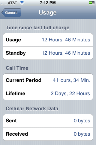

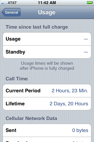

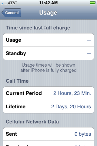

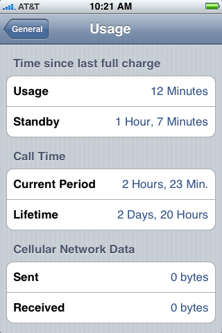

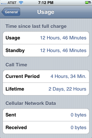

As You Can See : the screenshots are in order
1st is normal
2nd is when problem starts to occur and after, so on so fourth
3rd is after changing the file names, kinda found out that it lasts about 24 hrs or an hour more give or take because the phone doesn't go into standby, but once again its better...
