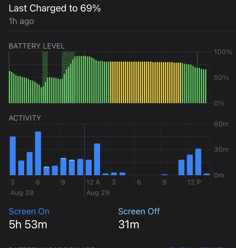

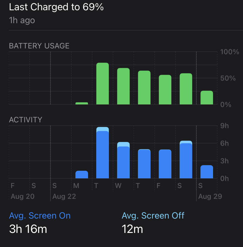

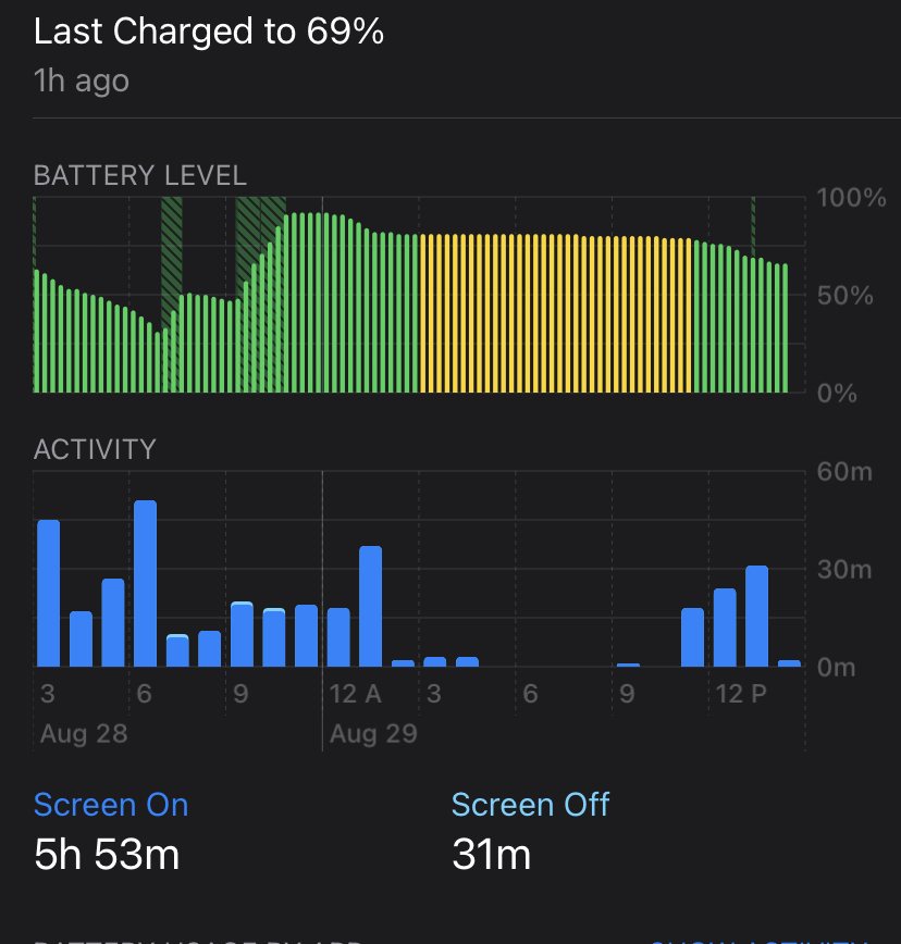

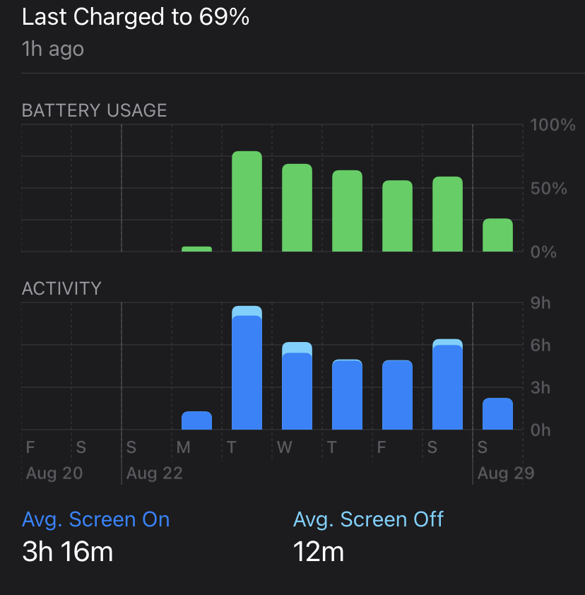

here are my battery usage graphs. i think the phone age is more than a year.
do you think about the graphs?
so you think that the battery shouldn't be at that percentage and it might be a scam. guys I'm so lost now.
They were making a joke. Your battery is fine. All you should be concerned about is the current capacity (health).
Cycle count isn't a meaningful metric by itself. It's only qualitative. In determining how well a battery is made. By comparing wear, to cycle count, charging habits, age and battery care. The only time to worry is if you have abnormally high wear, to cycle count. Based on your battery care habits.
You have relatively low wear compared to your cycle count. That just means you're doing something right in you charging and storage routine.
OK, making a lot of assumptions, but this what I gather. Looks/sounds like you bought used and have only owned for ~week, so you don’t know how the previous owner (‘PO’) cycled the phone. 98% is very good for a year but easily attainable if PO took care of batt, ie, unplugged before 100% charge - IIRC my XR stayed @ 100% for 14-15mo. Cycling 80-20, for example, can greatly extended a Li-ion’s cycle life…. from 500 cycles to 1500 cycles per Batt Univ.
Your 24hr graph shows a lot of intermediate plug-ins, but you can sort of extrapolate the first 4hrs as ~33%/2.4hrs, or ~13%/hr, or ~8hrs SOT on a full batt. That’s about half of Apple’s 15-16hrs SOT ‘up to’ spec for internet-video on the XR, but 50% Apple spec is pretty common from what I’ve seen of most users. FWIW, Apple‘s XR spec is perfectly feasible if you optimize the apps, settings, and charging - but you pretty much need to be a batt/runtime geek for that.
Anyways… just my $0.02
Reactions: zach159

Okey, also i just wanna know why i get 5~6 hrs SOT on ~70% i found it very low for a 98% battery health, why it can't it hit the 14 or 15hrs SOT on a 100%.
That’s a deep rabbit hole, and everyone’s priorities are different. Apple’s default settings tend to be set-up more for ‘features’ than ‘runtime’ - if you want to shift that default priority, then you need go through all the settings and turn-off the ‘features’ you don’t use, or don’t care about, and that includes turning-off antennas (cellular, blue-tooth, wifi, gps) when you are not using them. Every feature has a cost/benefit - you have to decide what’s worth it to you.
Just a few settings off the top of my head: use fetch email; turn off background refresh (and/or force close apps); use low screen brightness; manually adjust brightness (turns off light sensor?); minimize haptic feedback; turn-off cellular and use wifi-calling while at home; turn-off constant microphone monitoring ‘hey Siri’; turn-off constant accelerometer use (fitness app step counter, lift-to-wake); use 2.4g wifi; etc, etc. Surfing on wifi uses less batt than surfing on cellular. Reading/writing text uses less batt than gaming, video streaming, or surfing photos/images, etc. etc.
Then there’re the apps, I’m primarily a text surfer (mostly wifi - this is also my ‘home computer’) of enthusiast forums - Apollo (for Reddit) is my most efficient app <5%/hr; Tapatalk for other enthusiast forums (like this one) is next most efficient. Then Apples Safari/News apps are in the 8%/hr range. From the 24hr/10d battery graphs, if you toggle the apps between %-battery <> hours-usage, you can get an excellent feel for the relative efficiency between your top apps. Also, if you know your average runtime and relative app efficiency, then it’s easy to spot excessive batt drain from rogue apps and/or stuck processing loops. I had a few from the the official Reddit app.
Hope that helps.
