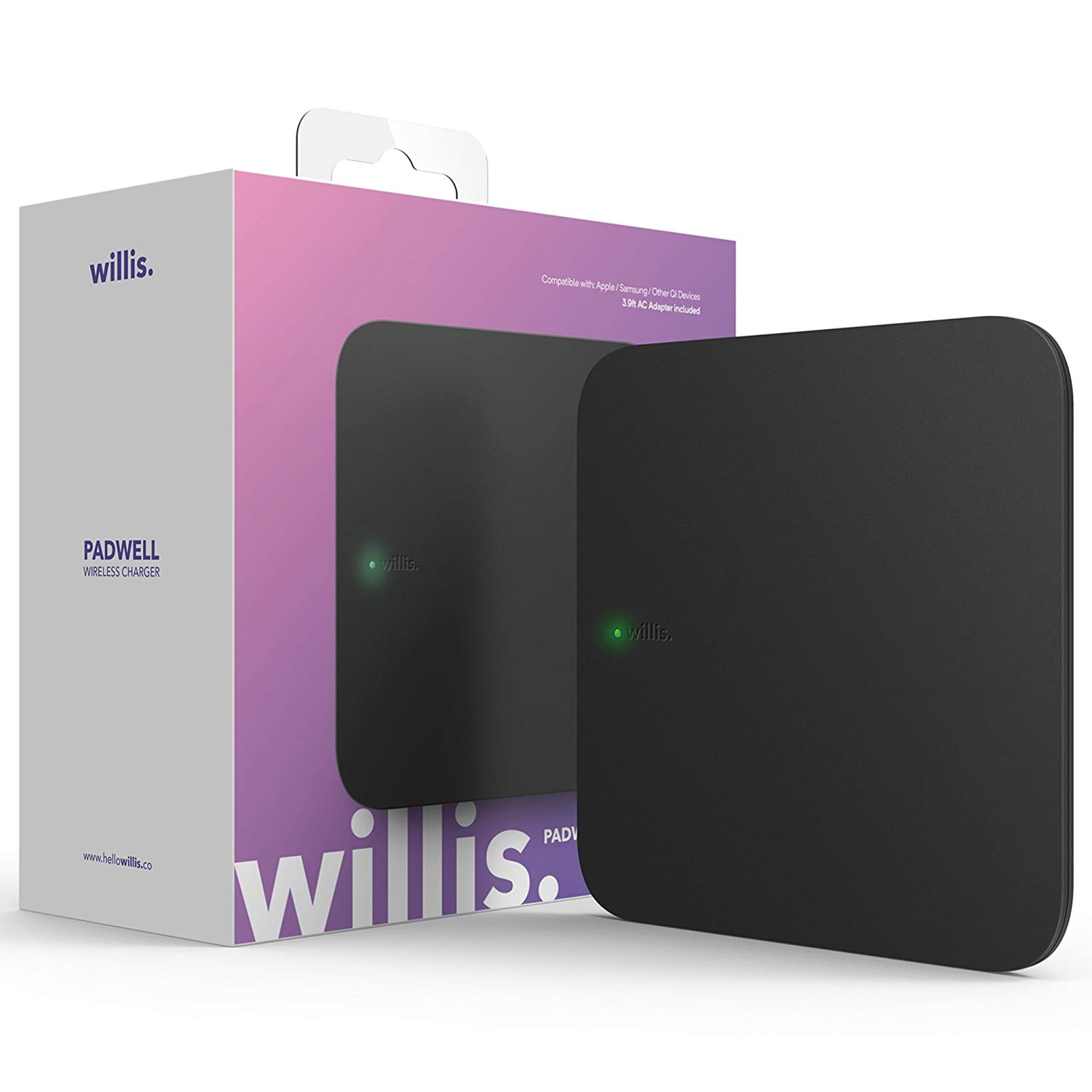

I picked this wireless fast charger 7.5W/10W for half price on Amazon using the coupon codes from the SavetoCart FB Page:
Item on Amazon:
https://amzn.to/2xQKOMB
Coupon Codes:
http://promos.mybreadcrumbs.co/iphone-xs-x-series-c.html
