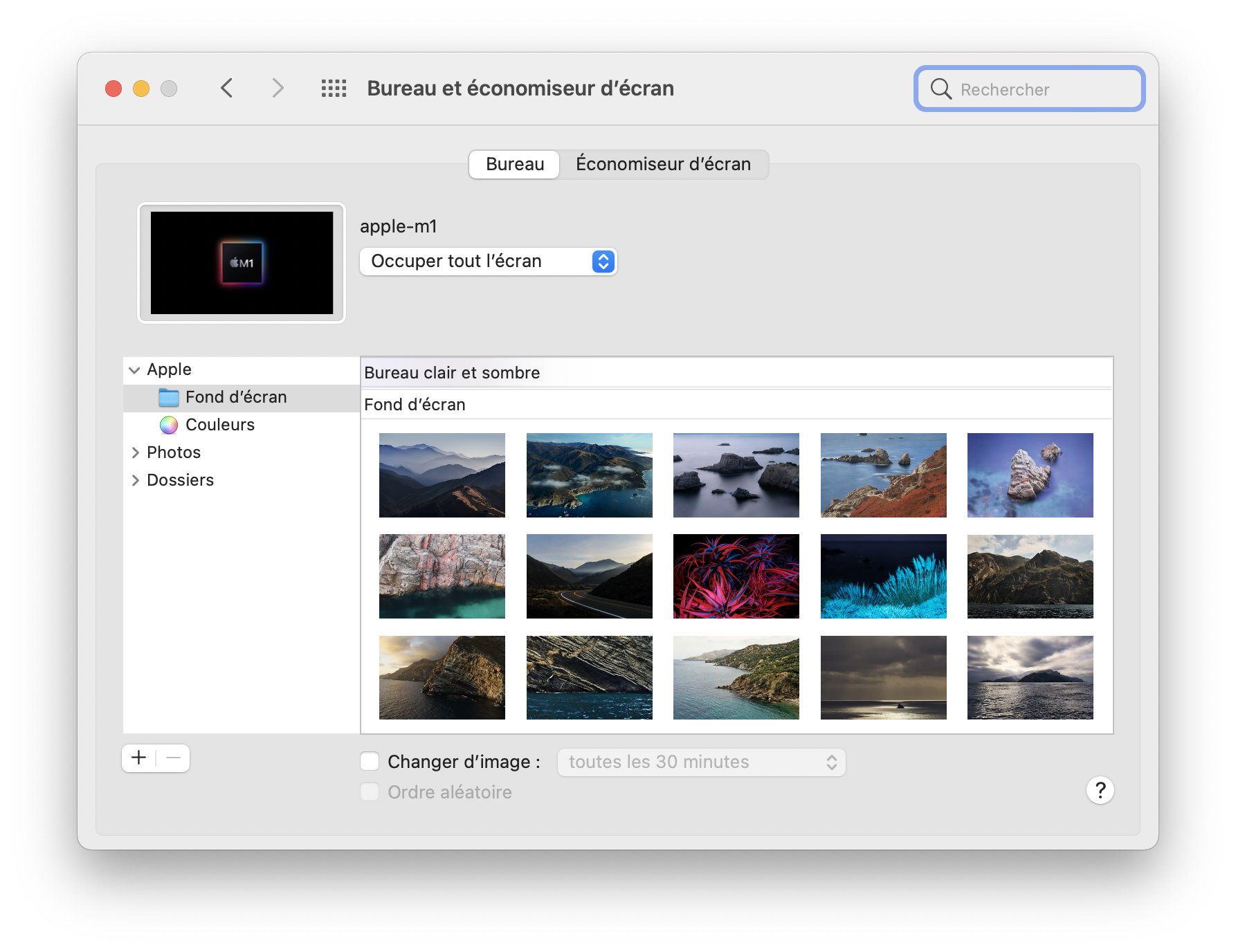

How long is the cable? What wallpaper do you use. Please post a screenshot of your settings and display resolution.
cable length 0.8 meter
personalized wallpaper or Big Sur on no dynamic

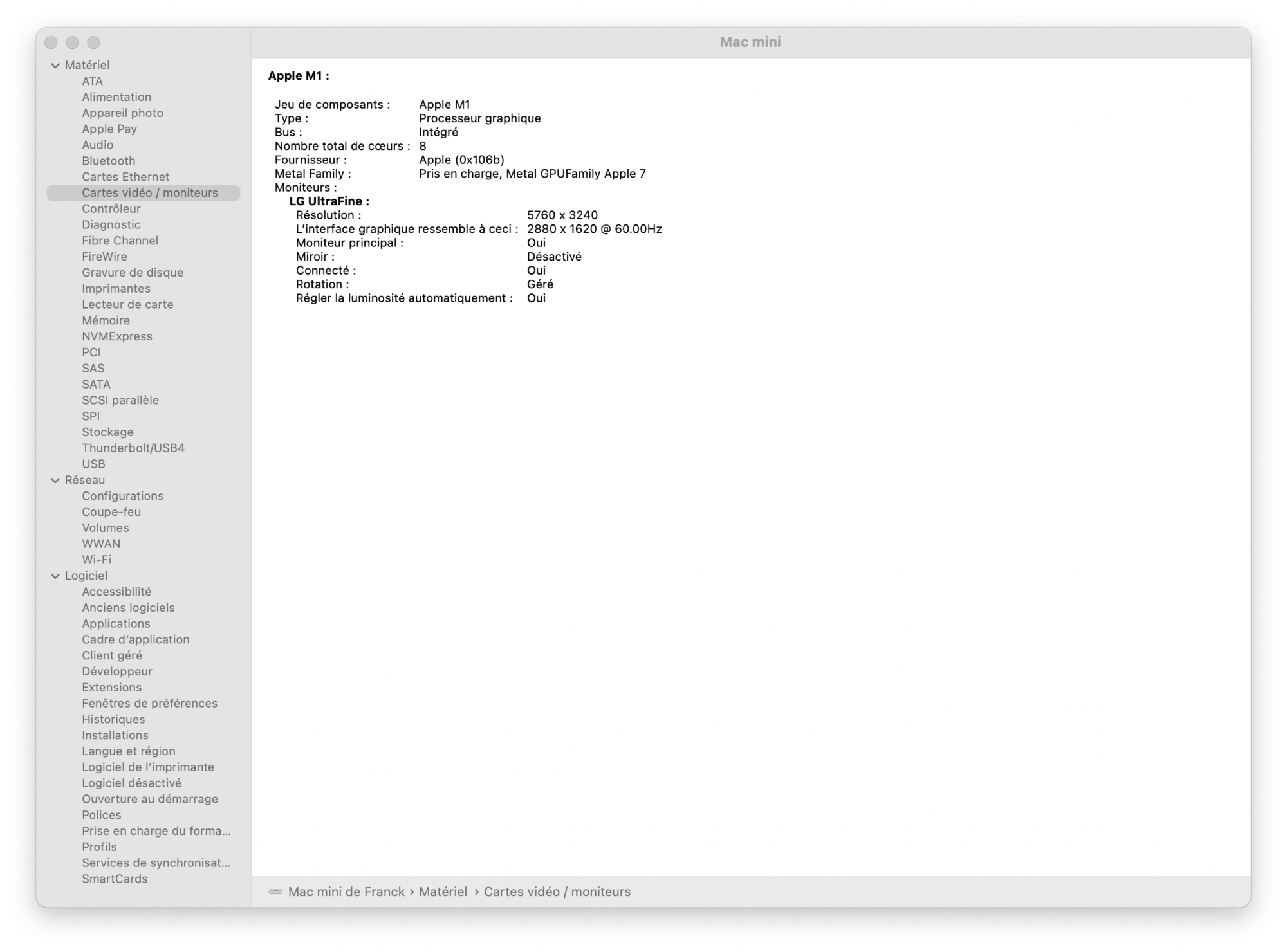

Thank you! And you do not have any issues anymore now? No pixel shift or brightness change after wake up? And how do you disable dynamic in Big Sur?
I rarely have pixel shifts , No brightness change after wake up

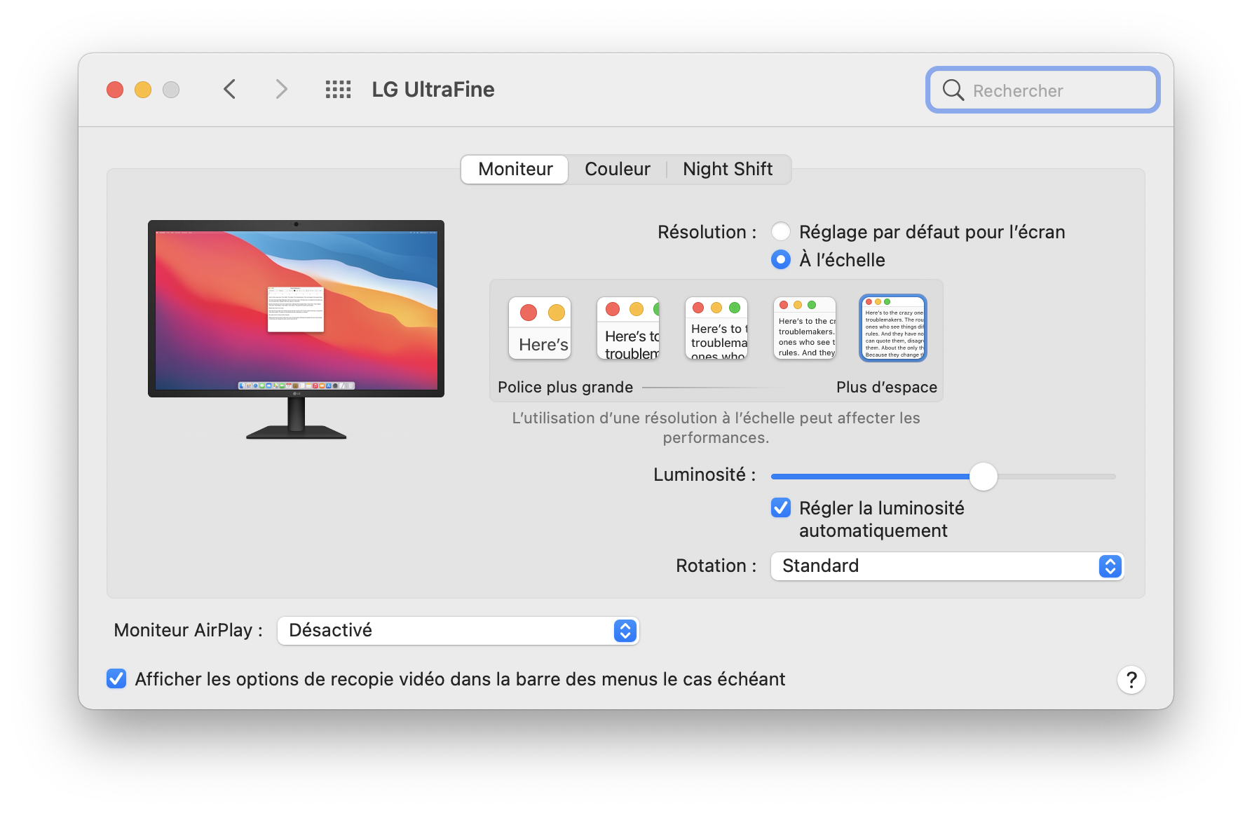

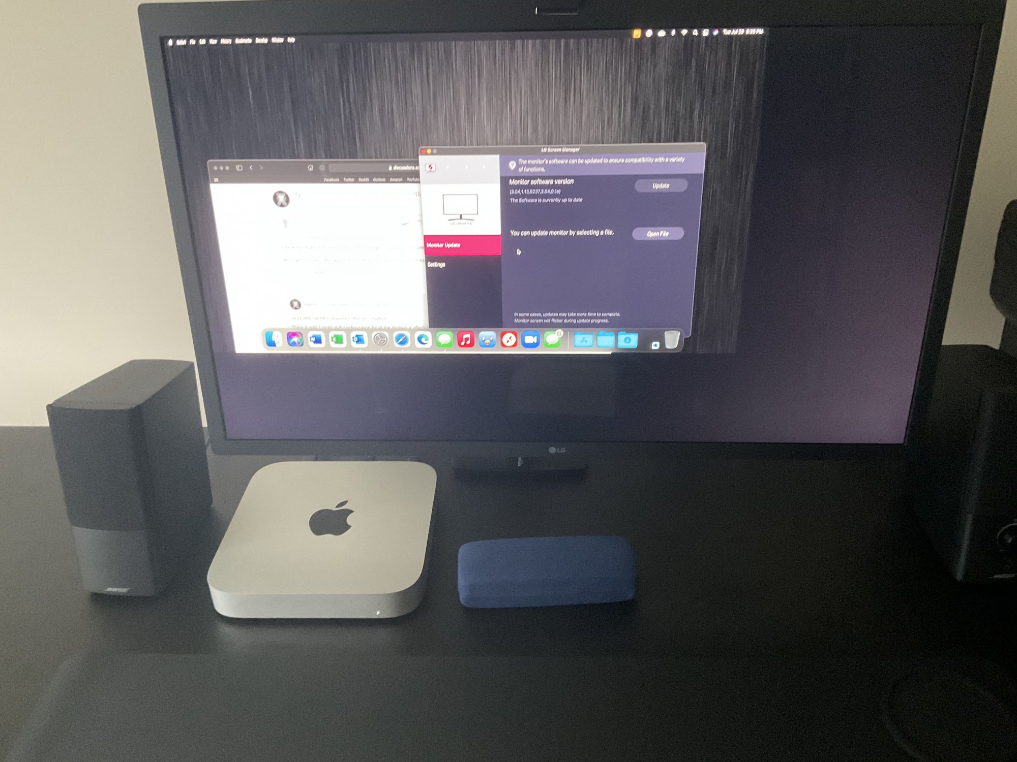

Does anyone have this problem with their setup? I tried replacing the cable but it does not fix the problem. Do people seem to think this is a Mac Mini problem or an LG problem? FYI my Mac Mini M1 16GB was part of the first refurb available for it earlier this year.
problem solved for me with 11.5 ! six months to resolve Big Sur problem with this screen
the problem came from Apple and not LG
unbelievable
