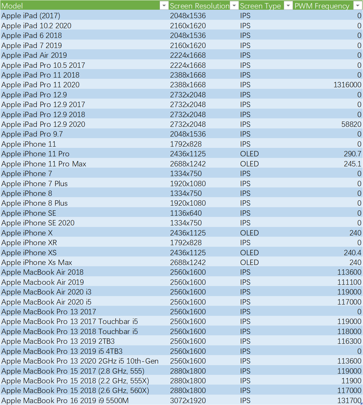

So yes. Every TV, Every phone panel - no matter the brand, Every light bulb, and every light emitting source that uses PWM dimming below a frequency of 300Hz Currently, and for the past ten years, Samsung favors the 240Hz range which is disastrous for those who perceive it. iPhone 11 sat around 290Hz, which is significantly better in terms of population affected, but it still sucks. The higher above 300Hz, the better; numbers like 20,000Hz - which is Phillips Hue, Apple iPad, et al.. are imperceptible to everyone.

I have no issues with my TVs or light bulbs. With my tv, It has a much higher refresh rate and it’s not 6-12”’ from my eyes. With the lightbulbs, I’m not staring at them. I think the low refresh rate (Apple’s standard not equivalent to android OLED) combined with proximity to the eye is the issue.
