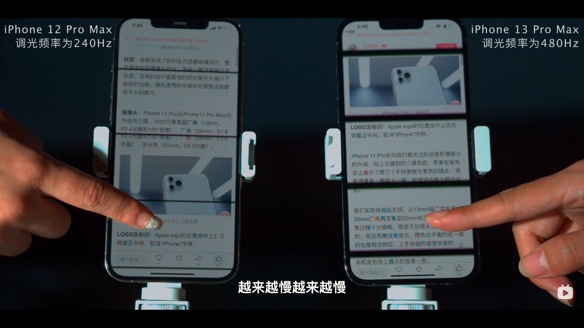

iPhone 13 Pro is using 480hz PWM dimming at all brightness, worse than iPhone 12 series
It’s worse because it uses PWM at all brightness levels instead of below a certain brightness level? Because the frequency is higher than the 12's ~250Hz which should make it less noticeable, no?
In iPhone 12 series, we can set a high brighness using DC dimming, and then use Reduce White Point to stimulate brightness adjust to avoid PWM flicker. But with 13 pro, there's no DC dimming at all.

Aaron from zollotech showed the screen at 240fps slow mo and in the video there is no flicker compared to the iPhone 12 or 13 OLED screen.
Well, this certainly could be promising! I wish he’d done the 13 pro and 13 pro max at the same time like he did the mini and regular 13. I have a pro coming and am curious if there’s a difference between the two pros.
