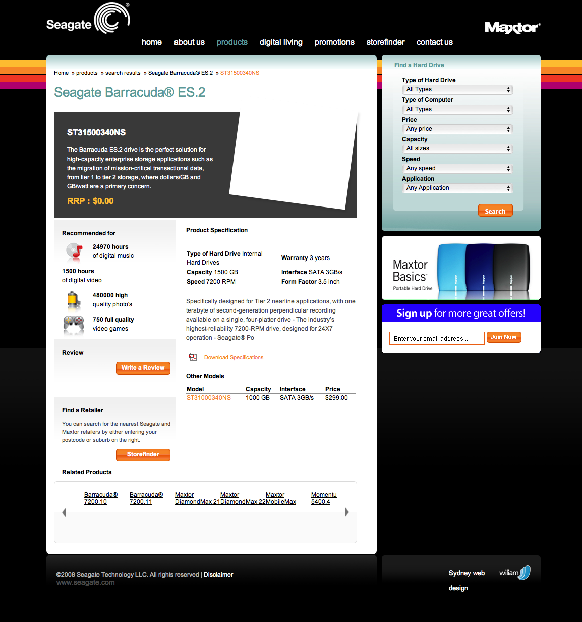

I would wait for the NS version of the drives before putting them in a Mac Pro. They are much more reliable than the AS versions generally and I wouldn't trust my data to such a new advancement. I googled the NS version since seagate has made no mention of it and found this australian seagate page about it.
Now let's see how long it will take for them to deliver it. 😉 😛
