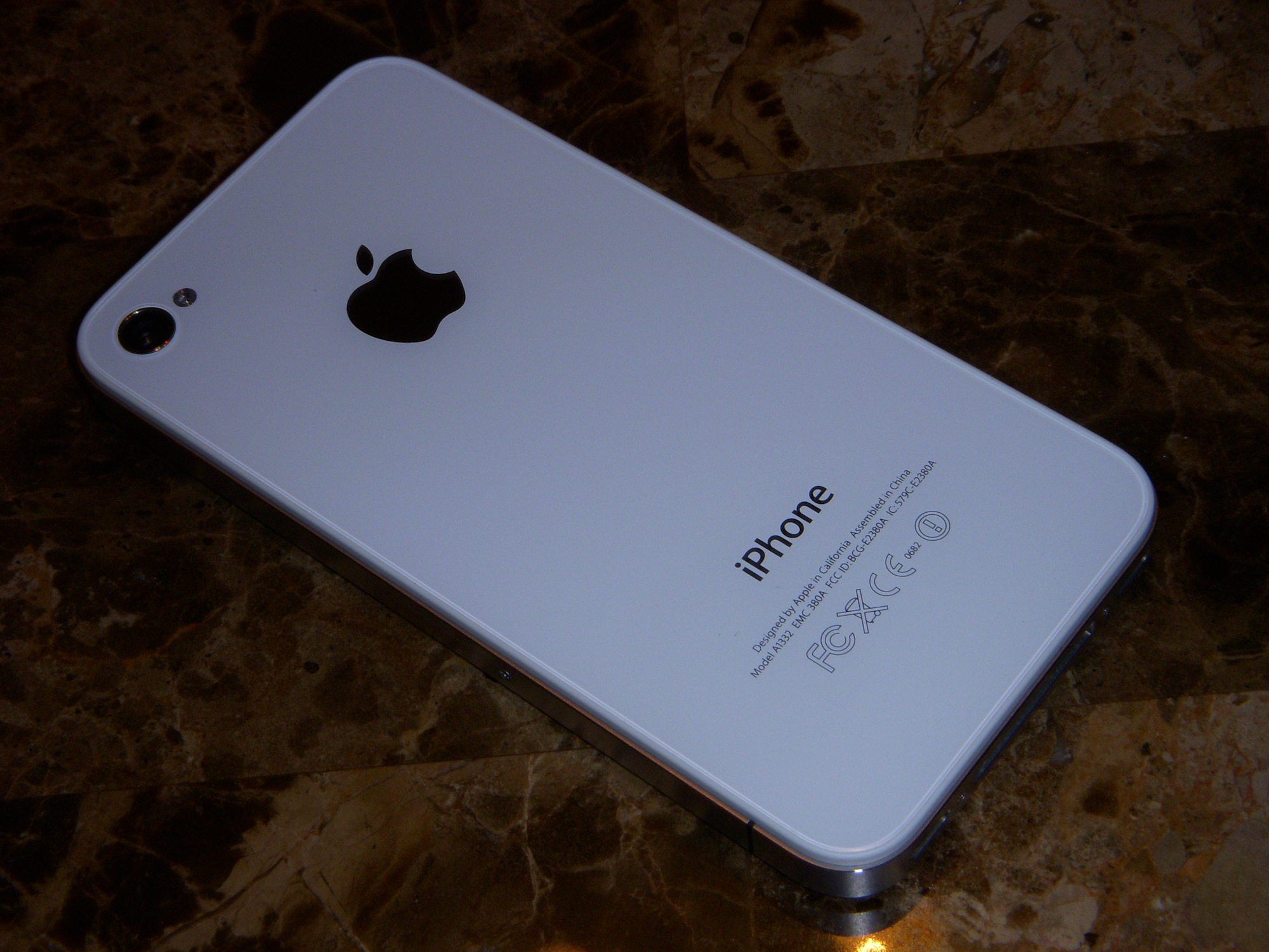

i received my "oem white back with diffuser" on saturday, installed it, and did some testing. visually the diffuser appears identical to the true oem on my black back, but ultimately the combination of the white back's light bleed issue (see my previously posted images) combined with the apparent focus of the diffuser causes substantial problems.
attached are two random pictures captured in a pitch black room with the flash engaged. the first image is with the white back + diffuser installed. every flash picture taken with this assembly exhibits the same blue tint and haze. the second image is my reinstalled white back without the diffuser assembly.
disappointing results. when the led is turned on with the diffuser back installed the light appears in two distinct concentric rings. i am guessing that when the flash engages the second ring overlaps and saturates the lens with light.

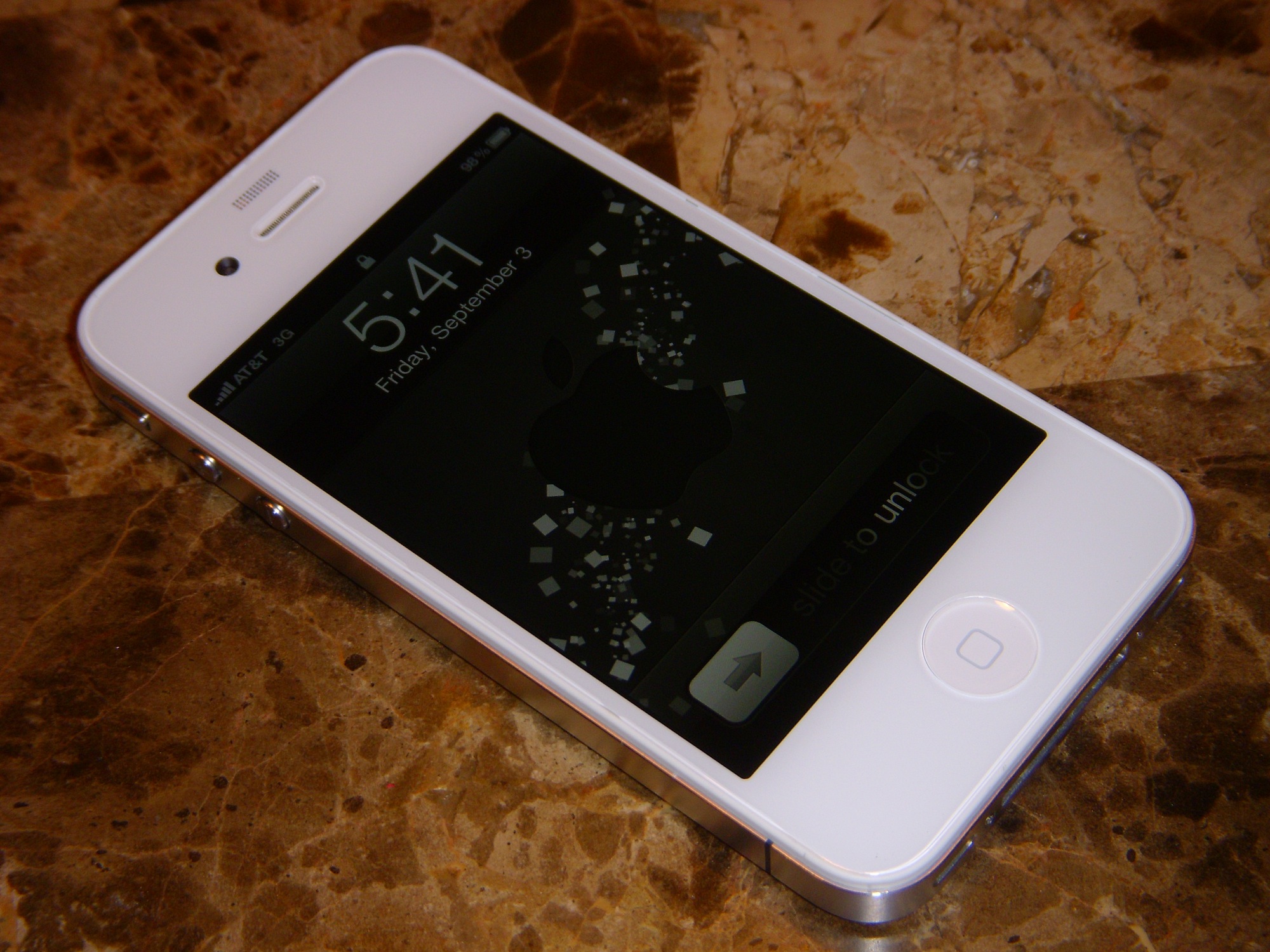

Been meaning to post this since last week but the long holiday weekend held me up a bit. I got the full white replacement from iResQ with dual overnight shipping and have to say I absolutely love the look, but definitely have some issues which I am not too pleased about. I hated having to send my phone in to someone else, but I'm not going to play games with the front and home button. The whole process left me away from my iPhone for about 36 hours total which was absolutely fantastic speed that came with some shortcomings I would quickly realize.
First thing I did when I got it back was give it a very thorough examination and immediately noticed both cameras now had prints and scratches on the inside of the lens and around the flash there was very slight paint chipping, although the flash did have a diffuser. These scratches noticeably degrade the picture quality and you can tell by just holding a second iPhone4 next to mine pointed at the same thing. The macro just cannot focus on anything.

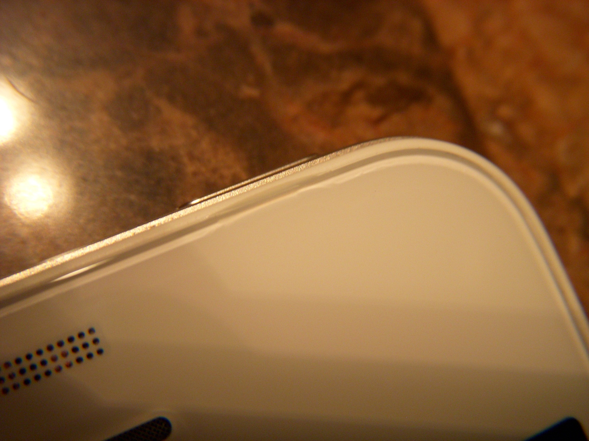

Second issue is there is a pretty obvious flaw/defect in the front glass which I have included a picture of. It may be a bit difficult to really see it but in person you can tell near the corner the glass is a little warped/melted area or something. With a bumper on you can't see it but it is still unacceptable.
