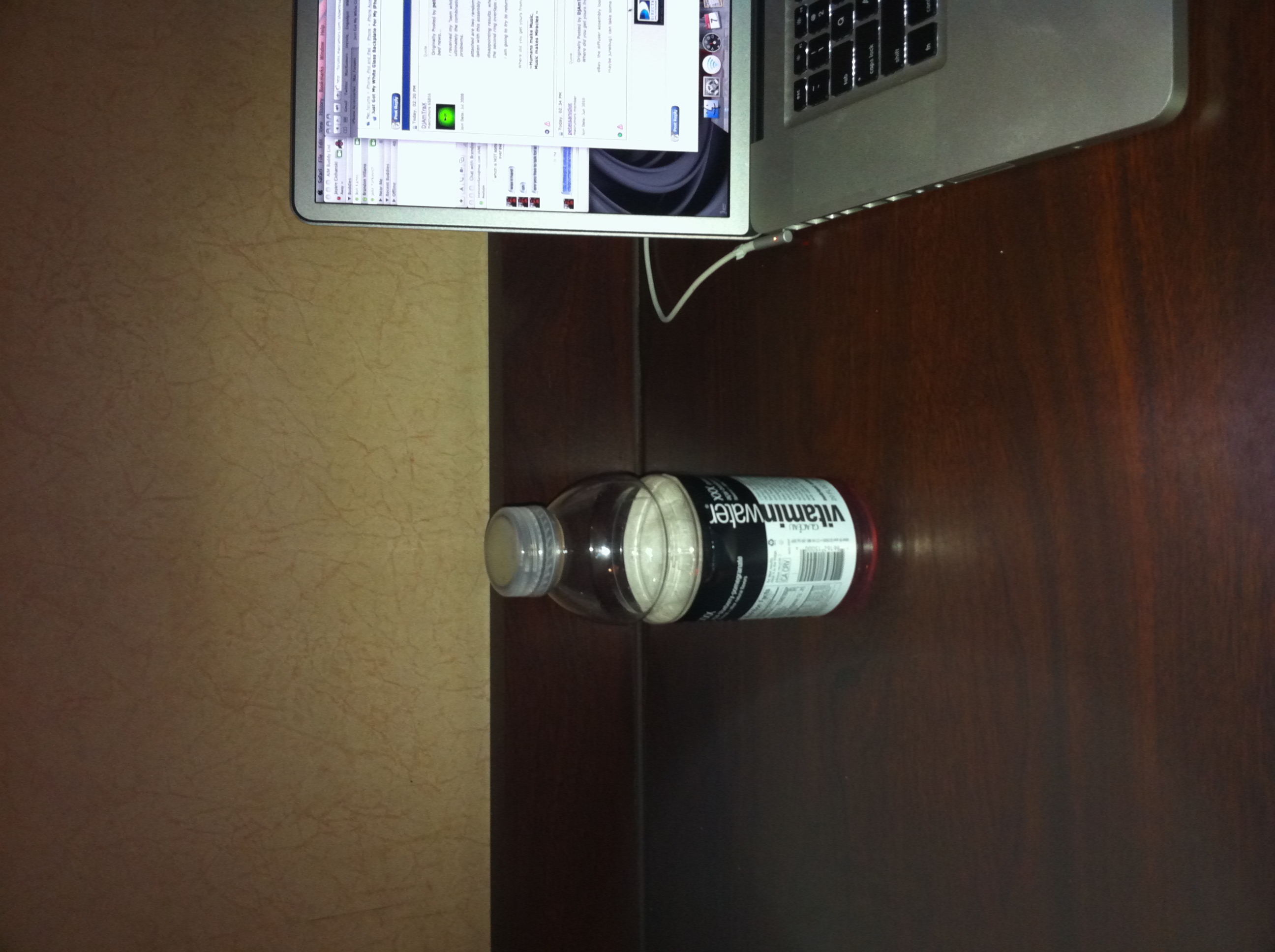

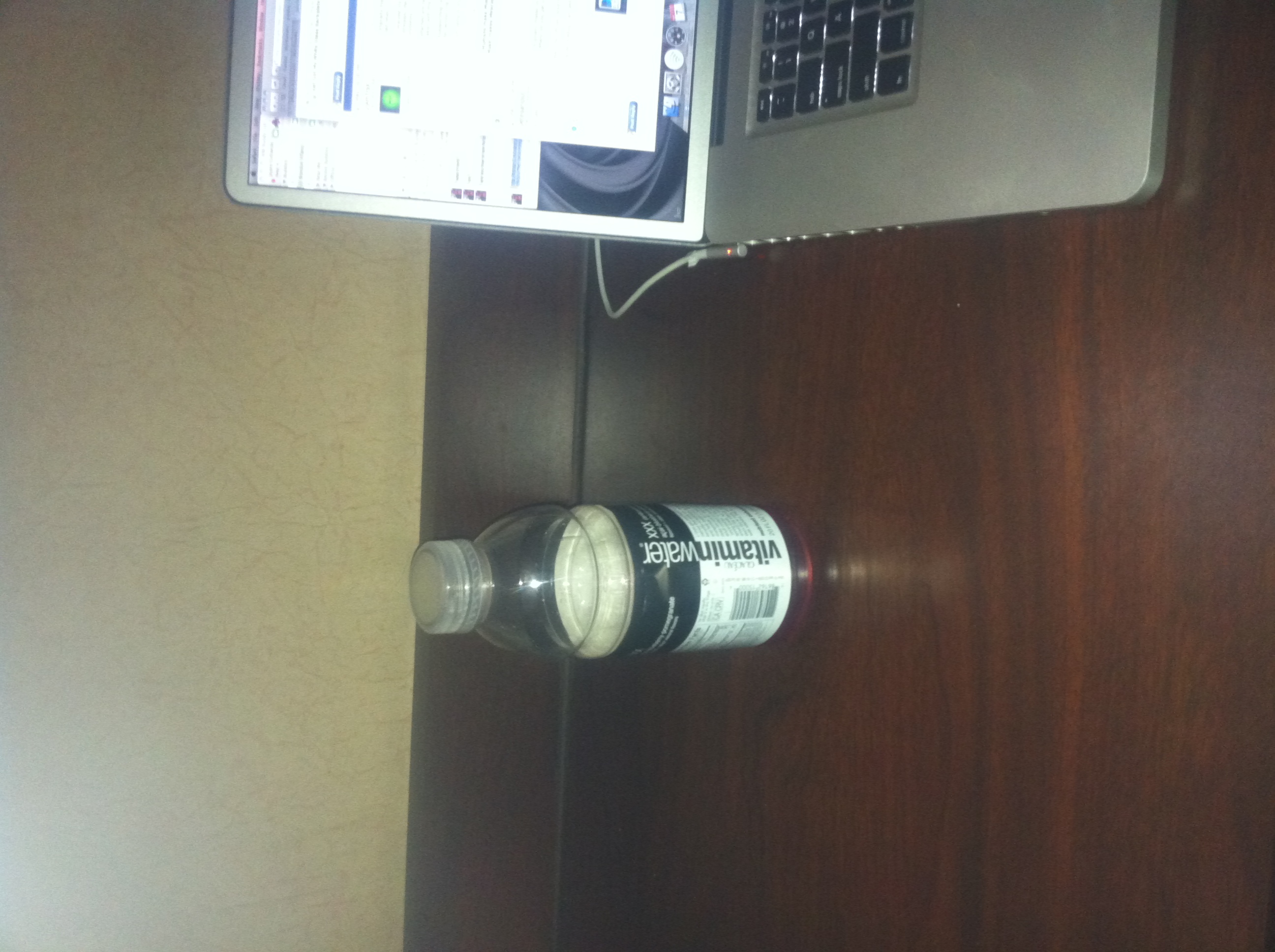

i received my "oem white back with diffuser" on saturday, installed it, and did some testing. visually the diffuser appears identical to the true oem on my black back, but ultimately the combination of the white back's light bleed issue (see my previously posted images) combined with the apparent focus of the diffuser causes substantial problems.
attached are two random pictures captured in a pitch black room with the flash engaged. the first image is with the white back + diffuser installed. every flash picture taken with this assembly exhibits the same blue tint and haze. the second image is my reinstalled white back without the diffuser assembly.
disappointing results. when the led is turned on with the diffuser back installed the light appears in two distinct concentric rings. i am guessing that when the flash engages the second ring overlaps and saturates the lens with light.

eBay. the diffuser assembly looks fine and identical to my black OEM but i think when combined with the light bleed issue inherent to the white models problems begin to emerge.

As requested here is a flash picture. The really awful one is from my White iPhone4 and the clean image is from a Black iPhone4. There is a noticeable difference in image quality. See for yourself below.
