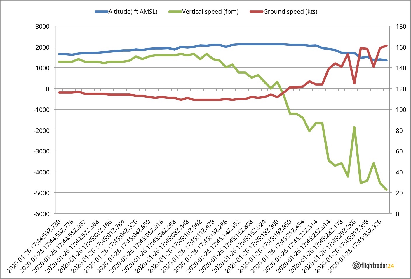

This chart is from ABS-D transpoinder data transmitted by N72EX (helicopter ID):
The last 14 seconds show a rapid decent GREATER THAN 1000 feet per minute (FPM, left side numbers).
There was a brief slowdown of fall 4 seconds before impact, but when impact happened heli was going almost 5000 FPM (about 50mph) straight down.
Controlled Flight into Terrain (CFIT) are almost always level or in a more linear rate. Aircraft descend to for landing rarely more than 3000FPM, typically 2000~2500FPM. They are also usually straight line, but N72EX was turning as it went down.
And that upward peak 3 seconds before impact is typical for an emergency auto-rotation landing.
My OPINION is I now strongly believe a mechanical failure caused this crash.
