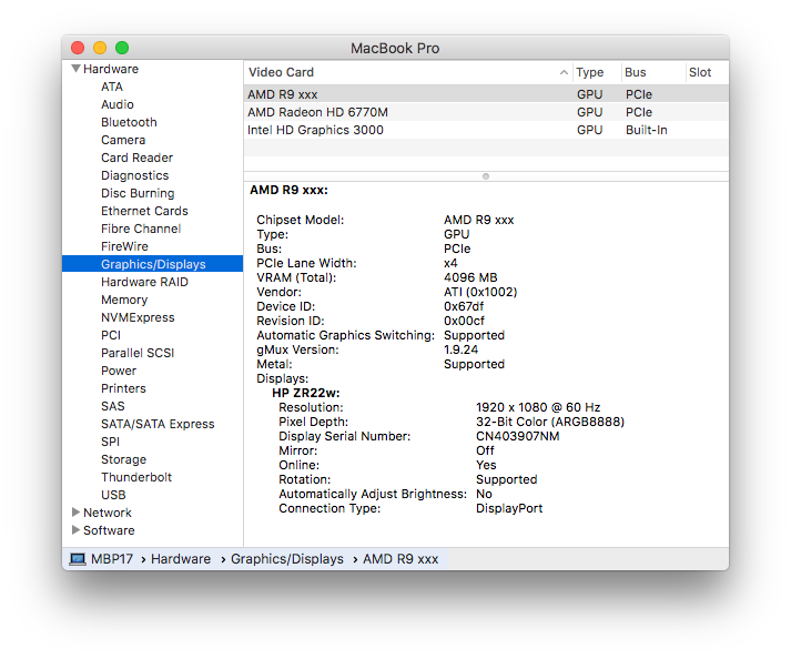

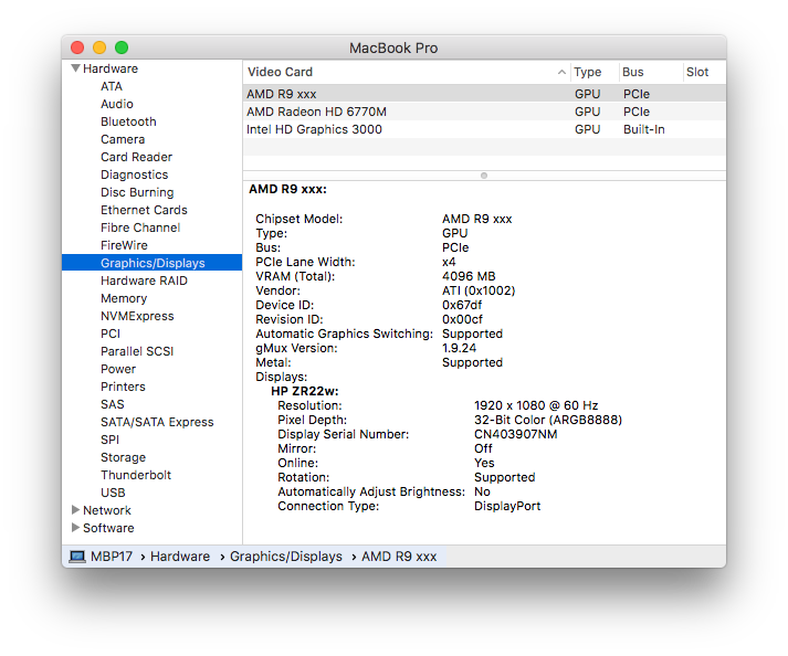

eGPU works on MBP with dGPU. I tried it with my 17" MBP.
What about Windows?
Optimus internal LCD mode is possible with Nvidia GPUs under Windows. I have not personally tried that though.
