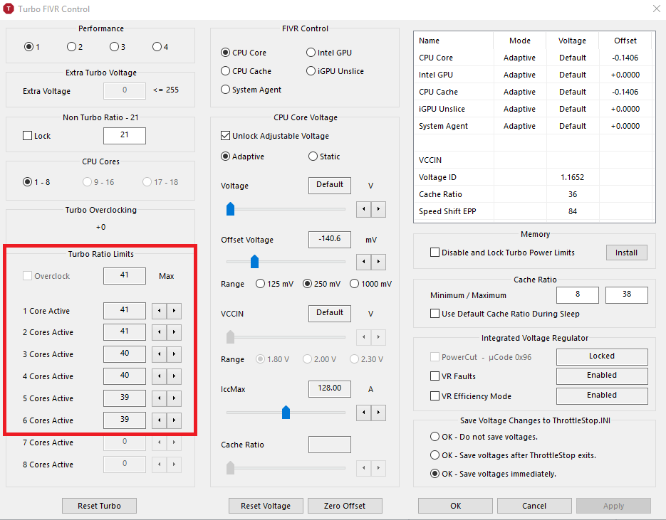

For W10 why don't you use ThrottleStop, undervolt the CPU and reduce the Turbo limits in FIVR, you will then achieve the result your looking for 4k a display with a CPU that is less power hungry.

Thanks. Will try. Why some values are 39 while others are 40 or 41? Are they set arbitrarily or after performing some tests? Seems to be the higher the core number, the less the max limit? Is there a relationship between the two?

Basically more cores that are fully loaded, the slower the CPU runs to maintain temp. Mine are set to default for the 2.2 8750H. As you reduce the value it will in turn lower the Turbo boost and reduce operating temperature.
Just be mindful as you reduce the Turbo your also reducing performance, you can also set up a low power profile with ThrottleStop. Just need a little trial & error, if anything goes awry just close TS, delete the TS .ini file and fully shutdown the notebook (hold shift down)
nb. don't run ThrottleStop & XTU at the same time or you'll have problems as they will clash to control the CPU.
