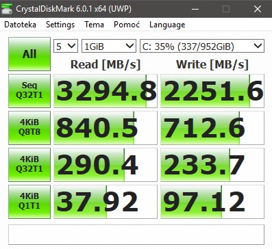

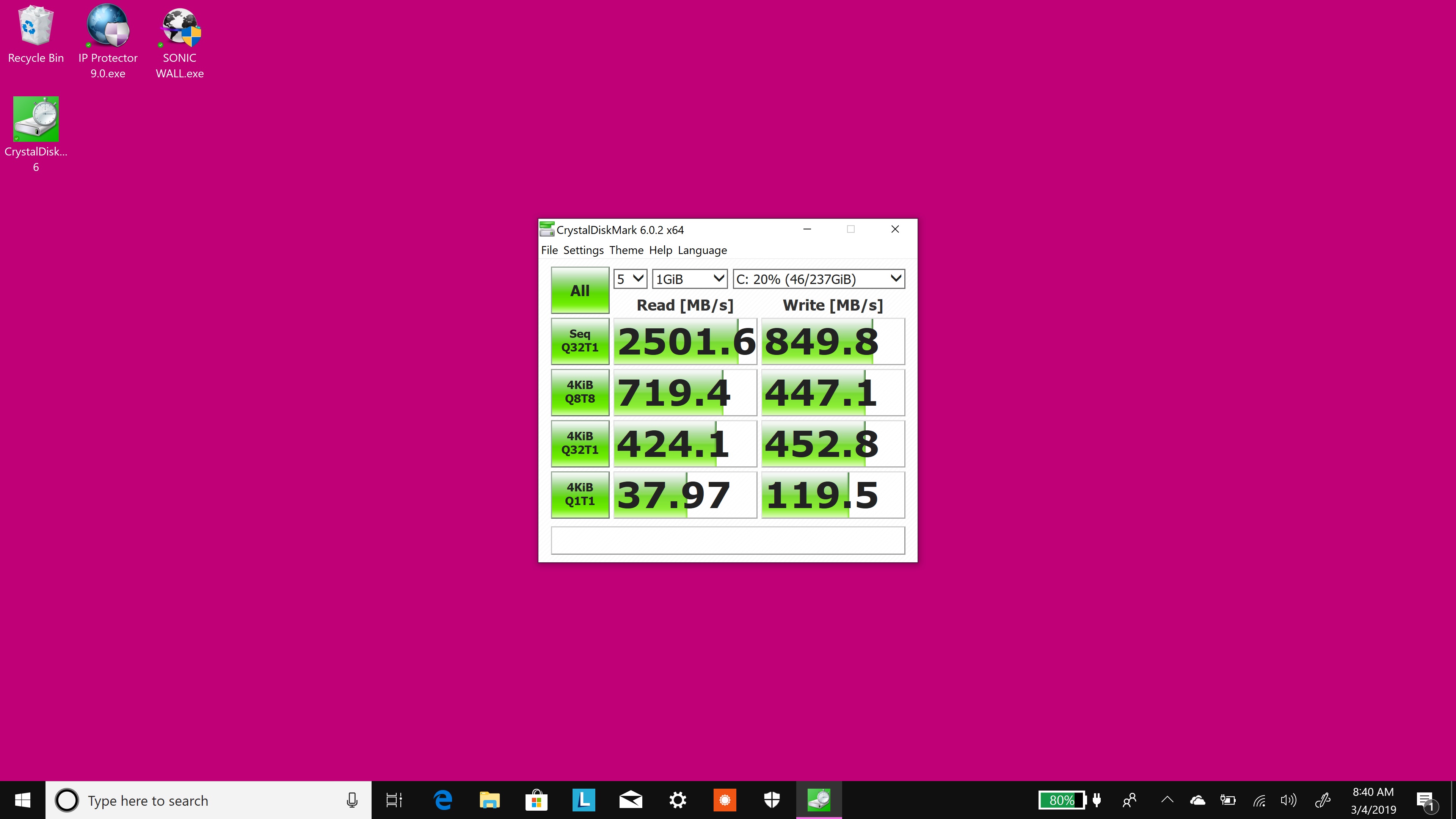

This is what I get with a (1)256 GB stick. Not too good, but passable. Looking at getting the Samsung 512 GB 970 Pro version. What are you seeing with yours ?

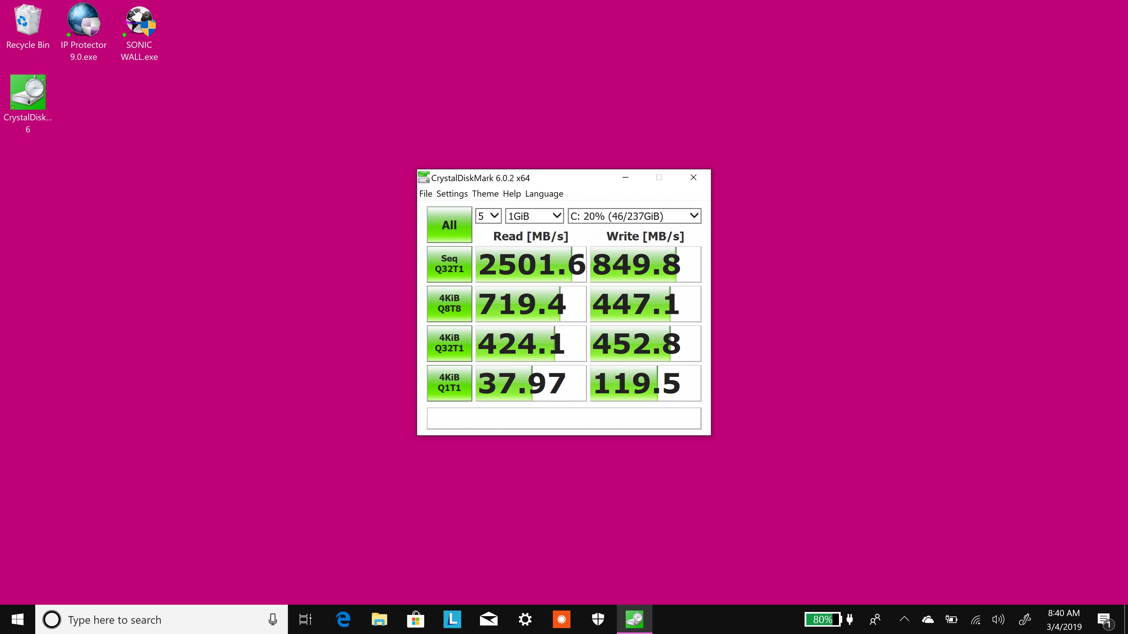

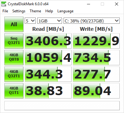

What's the current drive? I've a different notebook (Asus ROG GL703GS) with a 256 Samsung PM961
Might just need a driver update from the OEM directly.
Q-6
Samsung NVMe driver used to introduce system crashes, it was maybe two years ago, not sure how that looks like now. I'm using only what Microsoft supplies ever since.
Same, as the performance was never an issue for me, maybe at best a couple of hundred points more. So the old adage applies "don't fix, what isn't broken" 🙂 Although backing up and trying cost nothing, well barring one's time.

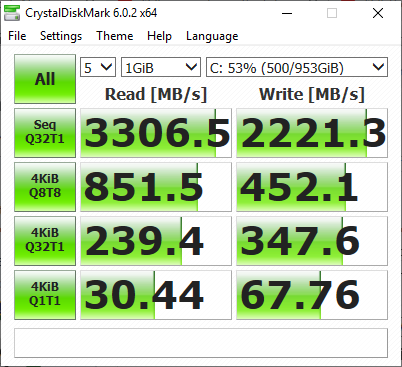

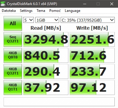

Well, here are my results. But bare in mind, I have more then 10 apps open at the moment, don't really want to close them off. And my unit comes with 1TB of storage (P981).

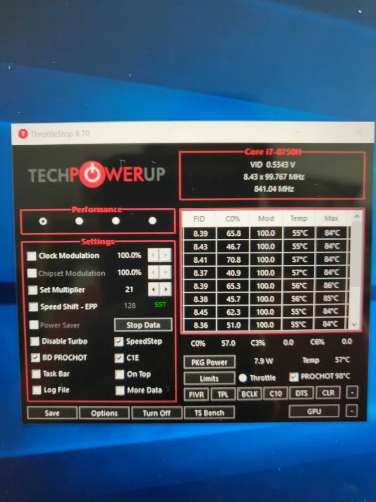

its hovering around 80c atm 🙁 not tried undervolting yet. i ave like 10 chrome tabs open, android studo open, franz messanger and other file window explorer opened. not unning a build as of yet but unzipping a compressed file, thats it. yes im on lates bios version

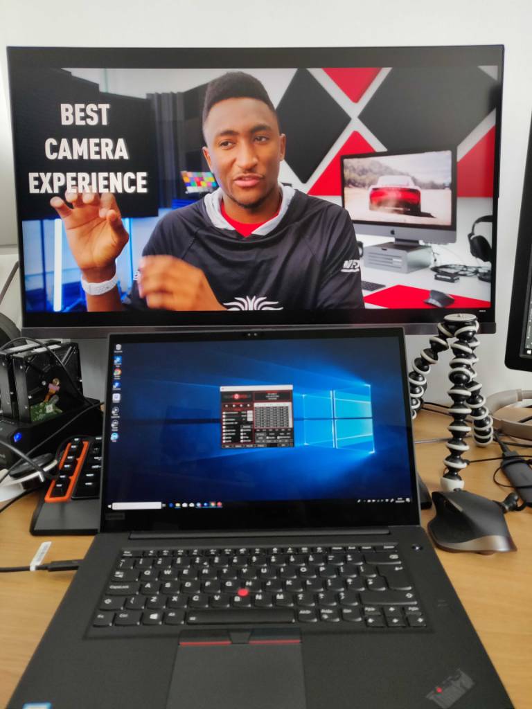

I also have my x1e connected to a 4k display using usb c thunderbold 3.
edit: just tried undervolding to around -130v and temps only went down slightly from 80's to mid 70's.
I've been fairly stable with -140mV on both the cpu and cpu cache.

I am gunna give that a go above and report back. incidently i just come back from gym and resumed my laptop but instead plugged everything off of it and posting this now running just the x1e on battery and temps are hovering at 50s!!!
Does using 4k monitor strain the cpu or something?
edit: hovering between 60-70 sometimes! im gunna try see what happens when i watch a youtube video
also: did you edit the cpu cache in throttlestop? i diddnt and just did the cpu only.
Ok after attaching my monitor again the temps jumped 70-80 again
@hajime I think noted a similar phenominom, i can't say for sure, but the GPU may be working harder to drive the 4k monitor and the internal display. I can't say for sure but if you're seeing temps in the 60s w/o the monitor and 70-80 with it. I think its pretty conclusive.
Take it off the mains and see what happens to the temps when driving a 4k monitor on battery. If the temps are better, then there may be relief in the form of other configuration changes.
Ok it's off the mains and it's quiet now. Watching a 4k YouTube video. Mind you my thunderbolt 3 USB c is charging the laptop lol.
