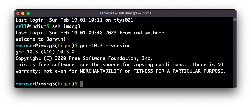

Finally, gcc-10.3.0!
Thanks to @barracuda156 for the pointers, iains for the porting work, and the MacPorts team for a few patches!
A few ./configure details of note:
Code:
    --enable-languages=c,c++,objc,obj-c++,fortran \
    --enable-lto \
Additionally, I created a mechanism to just install the just run-time libraries without actually installing the compilers, so that users who just want to install something which was built with a recent compiler don't have to pull in the entire toolchain.
So now, instead of installing gcc-10.3.0 (or gcc-4.9.4), you can instead install gcc-libs-10.3.0 (or gcc-libs-4.9.4).

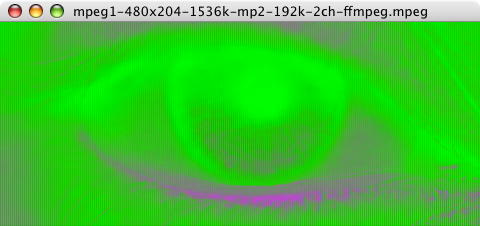

I'm still wading my way through building dependencies for ffmpeg, but in the mean time you can install the work-in-progress version which doesn't quite have all of the codecs yet:
leopard.sh ffmpeg-5.1.2
unfortunately, the colors are all jacked up when using ffplay, so perhaps this is only useful for encoding / transcoding video.
in other news, I've started working on a "secret" project 🙂 https://github.com/Tyrrrz/YoutubeExplode/discussions/691#discussioncomment-5199045
This used to happen with FFPlay in PPCMC7 - the solution from @alex_free was to add this script at playback:
Code:
-vf scale=in_color_matrix=yuva420p,format=rgb32
I've just discovered this is no longer needed with the last version in PPCMC7 and not using it brings FFPlay in line with the efficiency of MPlayer.
Code:
oh thanks! I'll have to take look and see what he changed.
