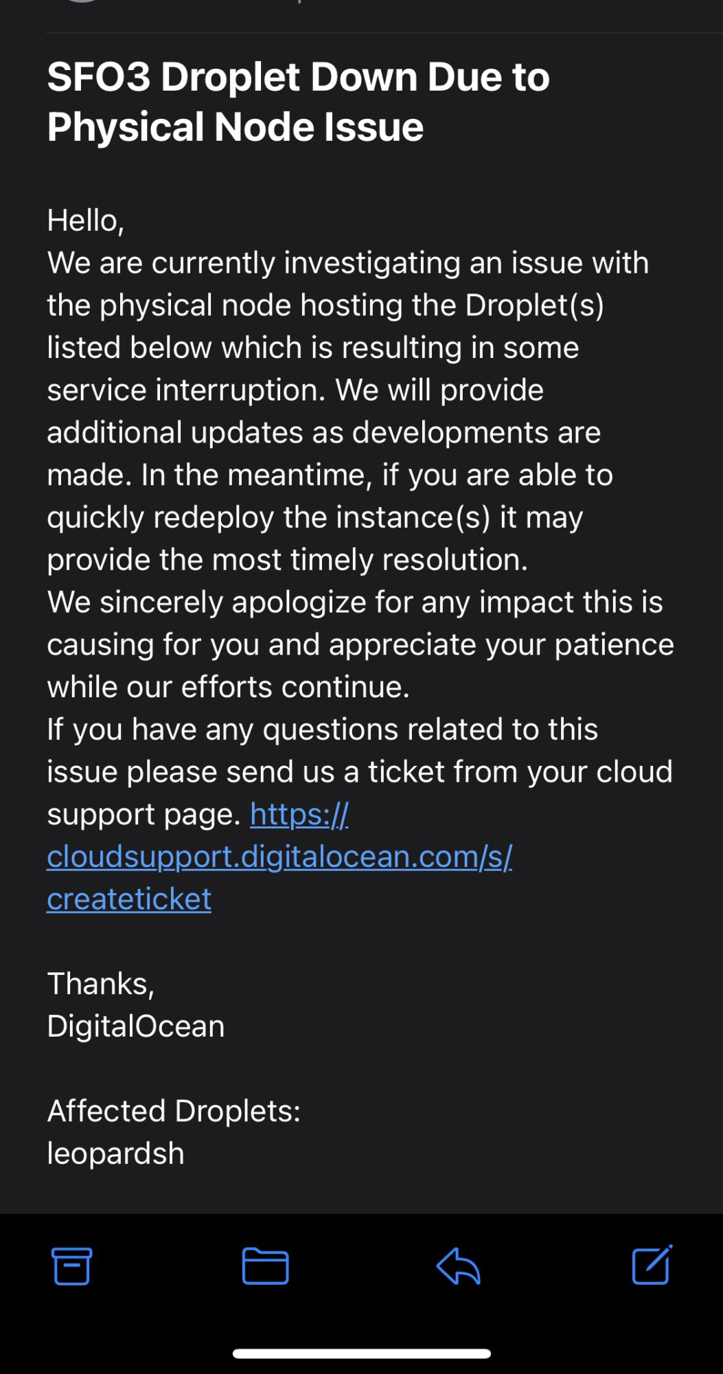

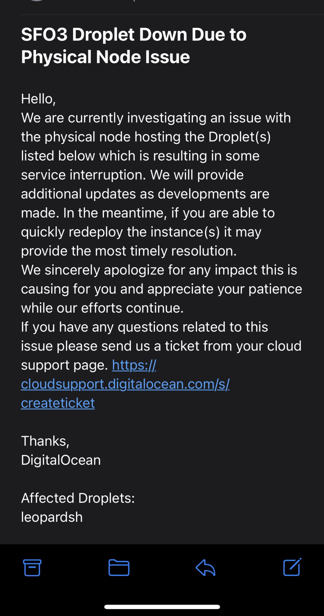

FYI leopard.sh is down.
If DO can’t figure this out, this isn’t a big deal. Deploying a new node would just mean reconfiguring Apache and DNS and then rsyncing all of the files to it. There are no files at risk of being lost.
EDIT: looks like it is back online

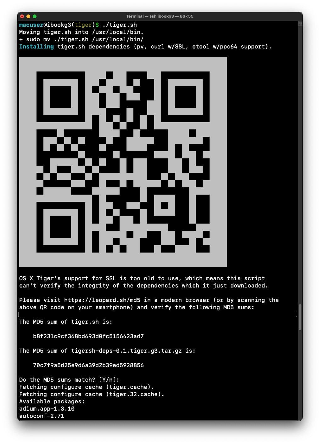

I'm having an issue installing tiger.sh. OSX Tiger curl is old and can't handle newer SSL.
Code:
MacOSX-LT:~ Alexandre$ curl -O http://leopard.sh/tiger.sh
  % Total    % Received % Xferd  Average Speed   Time    Time     Time  Current
                                 Dload  Upload   Total   Spent    Left  Speed
100 43355  100 43355    0     0  47512      0 --:--:-- --:--:-- --:--:--  101k
MacOSX-LT:~ Alexandre$ chmod +x tiger.sh
MacOSX-LT:~ Alexandre$ ./tiger.sh
Moving tiger.sh into /usr/local/bin.
+ sudo mv ./tiger.sh /usr/local/bin/
Fetching configure cache (tiger.cache).
curl: (35) error:1407742E:SSL routines:SSL23_GET_SERVER_HELLO:tlsv1 alert protocol version
Does anyone know a way around this?
Hmm, it should install a newer curl the first time you run it, which should be fetched over plain http. Something must be going wrong.
I’ll fire up a Tiger box and take a look.

I took another look at the script, and the part just before "Fetching configure cache" (which is the part which is failing in your case) should be installing the dependencies (i.e. the newer curl), but for some reason it appears thats not happening on your machine.
I just performed a reinstall of tiger.sh and this is the sequence that I see:
Did you see the same?
I recreated the "install from scratch" scenario by running:
rm -rf /usr/local/bin/tiger.sh /opt/tigersh-deps-0.1 /opt/tiger.sh/
Reactions: metallizer
Thanks for replying so promptly!
Installing from scratch solved the issue. I never got the the installing sequence, the curl error happened before it.
Can't tell what went wrong. I've been using this particular Tiger image since the OS got released. I bet it's kind of a mess with all the software in and out over the years.
It also fixed macports, sh was crashing while attempting to rebuild gcc7.
Awesome! Glad you got it working
It may be useful to know what is going wrong on Tiger: MacPorts is supposed to be working out-of-the-box there.
Unlike tiger.sh, macports has been installed in this image for a number of years.
When I tried to build python3 it threw an error requesting to run rev-upgrade first and complained about broken links.
Rev-upgrade ended up rebuilding every package previously installed. Took half a day but reclaimed 8gb of trash that the crashed gcc7 rebuild left behind.

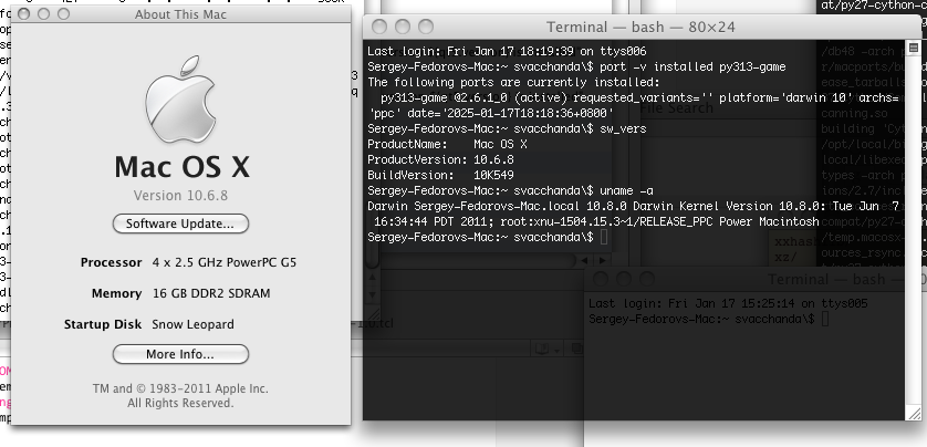

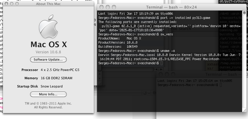

Out of curiosity, with the new tools and Python 3, would it be possible to complie Pygame?
I tried myself but it errored out with no compatible complier found sadly
I also tried manually installing YT-DLP [ python3 -m pip install -U --pre "yt-dlp[default]" ] as i know the PPCMC one works, but that failed with simply did not run successfully
Im on sorbet Leopard on a PowerMac G5 7,3
This one? https://github.com/macports/macports-ports/blob/master/python/py-game/Portfile
Which error did you get? I do not see any problematic requirements for it. (It does not mean it will necessarily build, and if it does, that it will actually work, but chances are it will. At least no obvious stoppers.)
It should be generally assumed that there are only two ways to install something in a way it will work:
1. Build yourself from source manually (i.e. without a package manager and any assumed defaults).
2. Use a distribution system that supports systems in question.
[Okay, in a few, very rare cases, upstream may still support powerpc and provide an installer. If the software in question is standalone, like TenFourFox, that is an exception from the above.]
I would not expect things like Pip, Conda, Homebrew or CRAN to work in a sane manner.
This does not count as a challenge, it builds trivially with default portfile. You may want, however, py27 version (earlier one), which uses SDL1, since SDL2 on powerpc relies on X server and does not support some gaming-relevant features.
To install versions below py313, you may need to add into the portfile this:
Code:
compiler.c_standard 2011
build.cmd-prepend CFLAGS=-Wno-incompatible-pointer-types
The first line should apply to all versions, the second only to py27 block, I guess.
Anyway, py27-game with SDL1 also built fine after these minor fixes.
Mkay!! Sorry for being such a noob lol, im compiling Pygame 313 right now, and im a bit confused what you mean by "py27 version" Which one would i need for that? 😓
