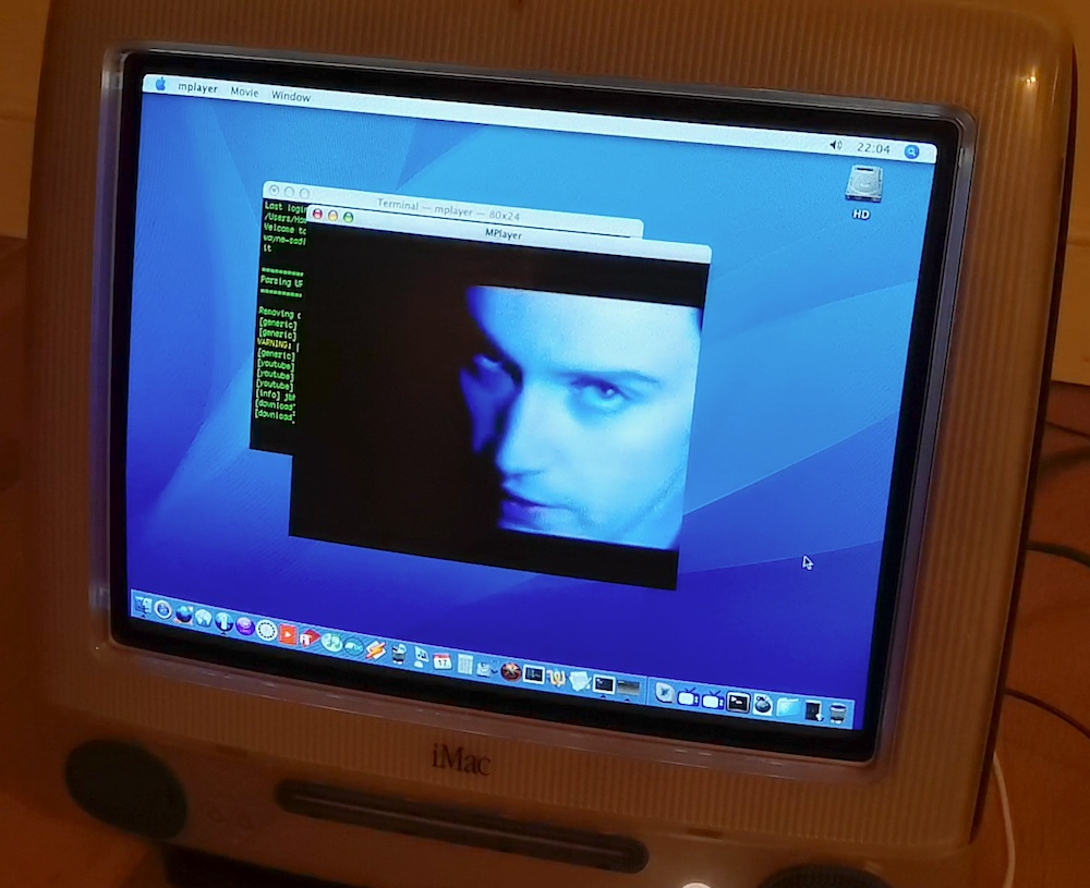

This used to happen with FFPlay in PPCMC7 - the solution from @alex_free was to add this script at playback:
Code:
-vf scale=in_color_matrix=yuva420p,format=rgb32
I've just discovered this is no longer needed with the last version in PPCMC7 and not using it brings FFPlay in line with the efficiency of MPlayer.
Good to know ;) it was required at one point but I think ffmpeg fixed it and I didn’t notice.

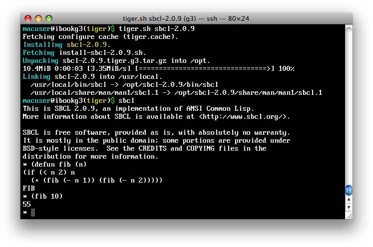

Wanted to write about SBCL 2.0.9 for PPC, then remembered I have already did that in GitHub thread.
P. S. If any experts on SBCL here, we have restored PPC into the current SBCL, but need some help with the build, it freezes at some point.
Thanks for the tip on SBCL 2.0.9, I got it building on Leopard and Tiger (using 1.0.47 as the bootstrap).
