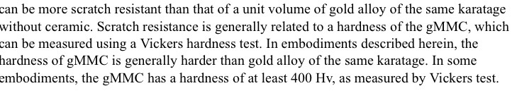

Exclusivity, would come from either owning a patent or having an exclusive license to the patent. And it appears that the patent is for a process to create a much harder and denser gold. I suggest you read Claim 28 in the patent. The process maintains the 18 karatage by mass which is required in order to advertise it as 18 karat gold. But the volume of the gold significantly reduced according to the patent claims.

The claim in the advertisement that I attached said that the gold they developed is "twice as hard as standard gold." The claim embodied in the patent says that the patented gold mixture creates harder gold. See attached. You are conflating hardness with volume density. And I think we both agree that Apple has not stated that the gold in the Edition is not subject to the patent.
