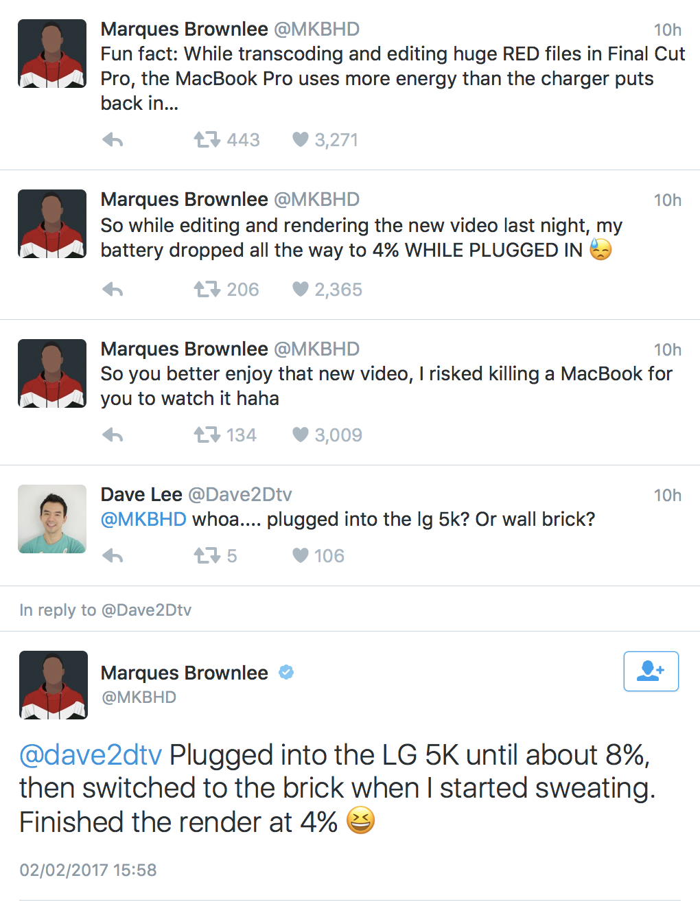

In other UltraFine bug/issue news, Marques claims that the display doesn't actually provide a full 85W as promised and the battery drained while he was encoding video. Apparently his MacBook nearly shut down before finishing the processing. Plugging in the Apple power adapter apparently stopped the drain.
Where does he say that @Brookzy ?
I do enjoy watching their videos but would just call them youtubers or tech youtubers/vloggers.
It drained all the way to 8% while rendering video, so he had to switch to the Apple power brick!
(And this from someone paid to sing the product's praises!)

Hmmm.. why would running out of battery "kill the MacBook"? :/
Maybe he has a faulty 5KLG? Mine seems to charge pretty fast.
Considering the average age of his viewer is probably about 13, I think he was just being playfully puerile with the killing the MacBook thing!
I would have thought it extremely unlikely that he has a faulty unit. As one of only four reviewers who had early access, I have no doubt his was cherry picked and double checked before being given to him.
If you find yourself at a loose end for 20 minutes and fancy investigating it, you could run your MacBook to a state of medium-low charge (anything under 70%) and increase the power consumption to the absolute maximum by simultaneously thrashing it with:
