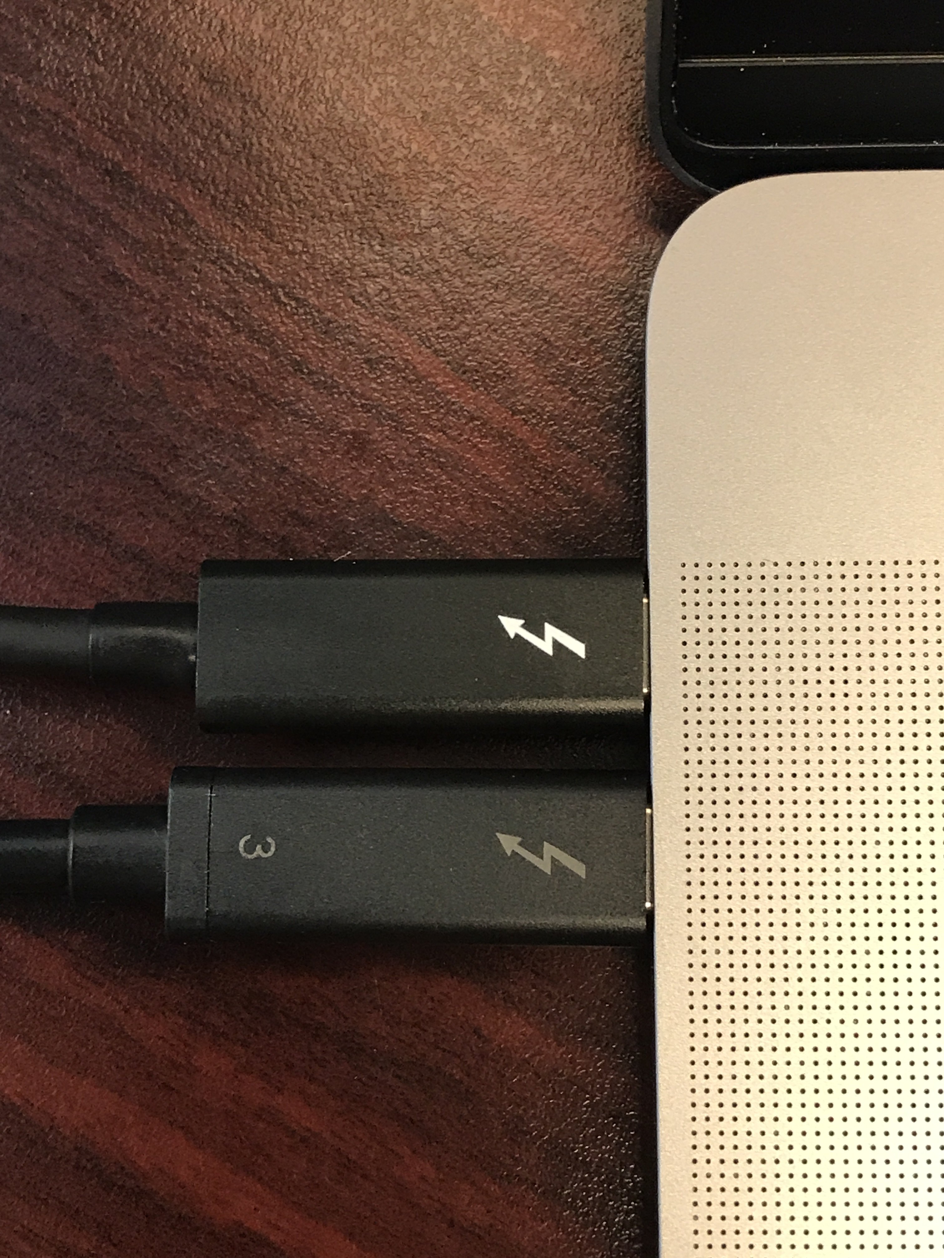

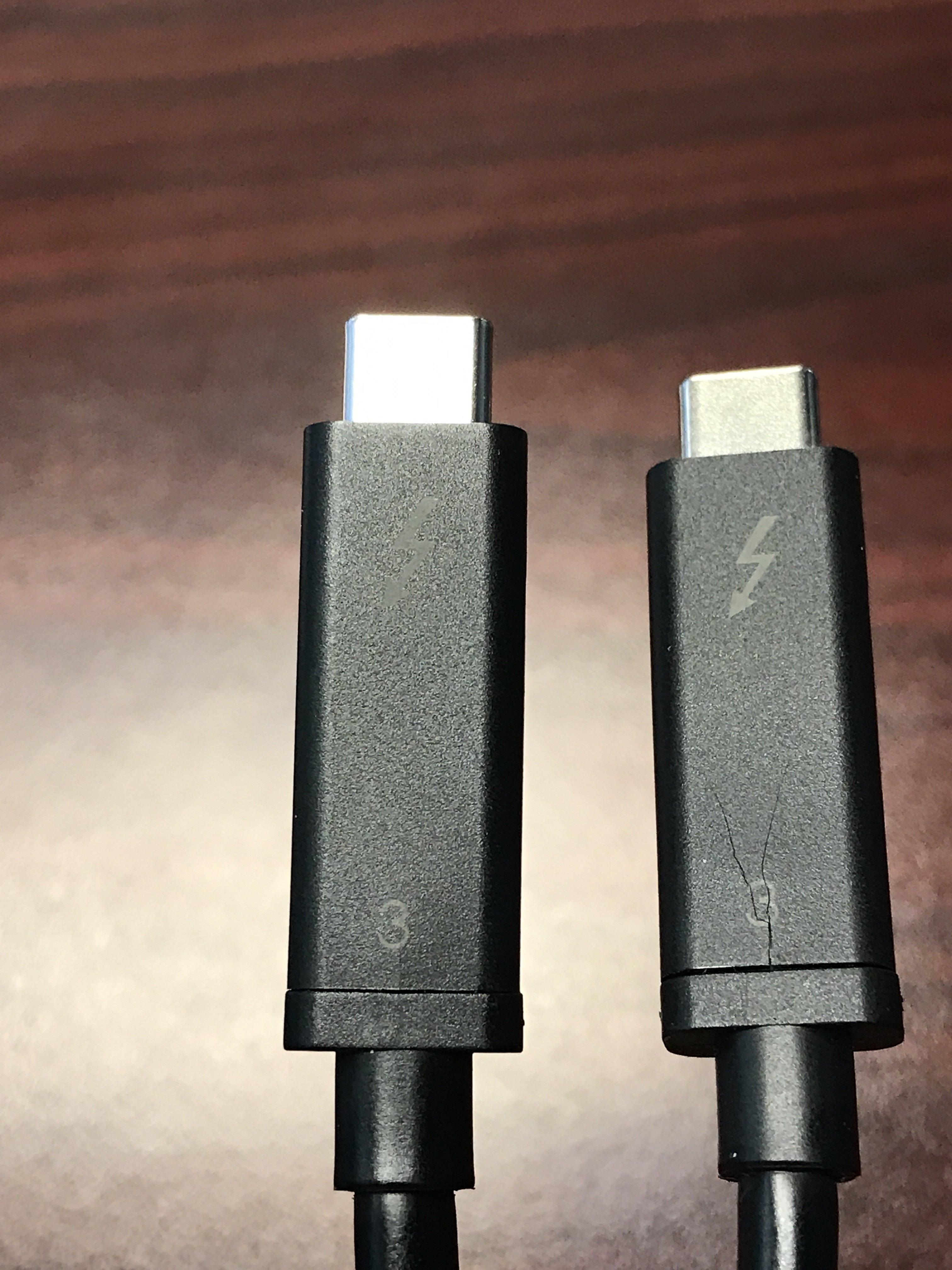

I purchased the 1m CalDigit one and have been using for a week now - just left a review on Amazon.
It functionally works the same as the OEM one that came with the 5k as I confirmed that it is charging my 15" 2016 MBP at 85w and also supports usb devices connected to the hub. Differences is that the connector on the CalDigit one is a few mm longer than OEM, cord is slightly thicker and more rigid (also not the soft-touch feel). The collar on the connector on the CalDigit one at least seems a bit more sturdy than the OEM one. However, on the side that has been plugged into my laptop, the connector housing on the CalDigit one has developed a crack - so i am returning it.
