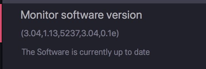

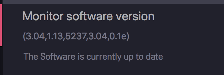

Have any new firmware updates been spotted? This monitor is still bug ridden.
Currently running 3.04,1.13,5237,3.04,0.1e

What version firmware are you seeing?
With the same LG software, I am still seeing the 3.04 version with no update available.
I see the 3.04 version too, but I was on an earlier version before running the updater. So, I guess I should have qualified that there was a Firmware update, but only because I still had the original firmware I got in the first batch of LG 5K's.
