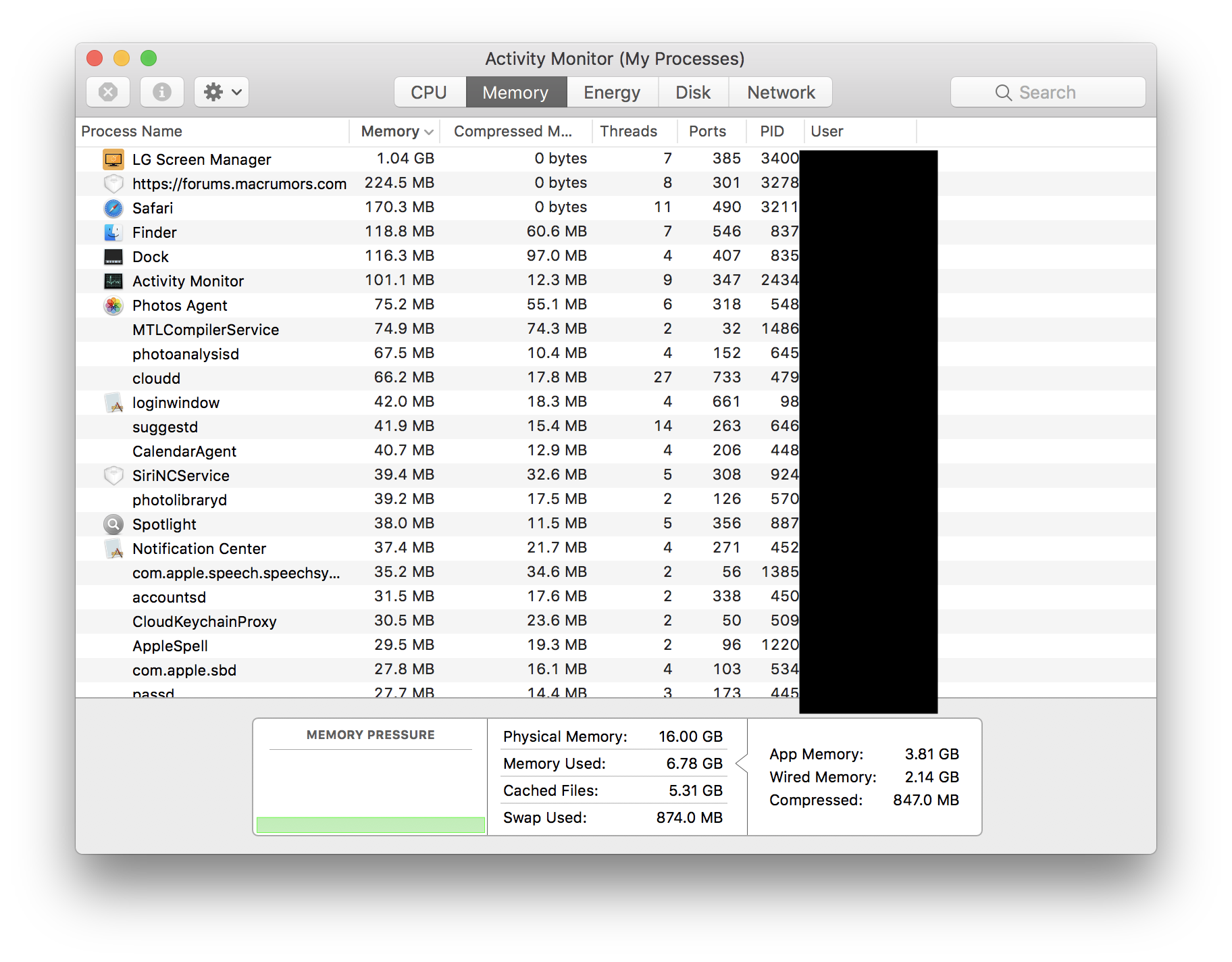

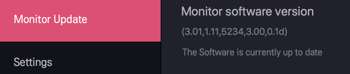

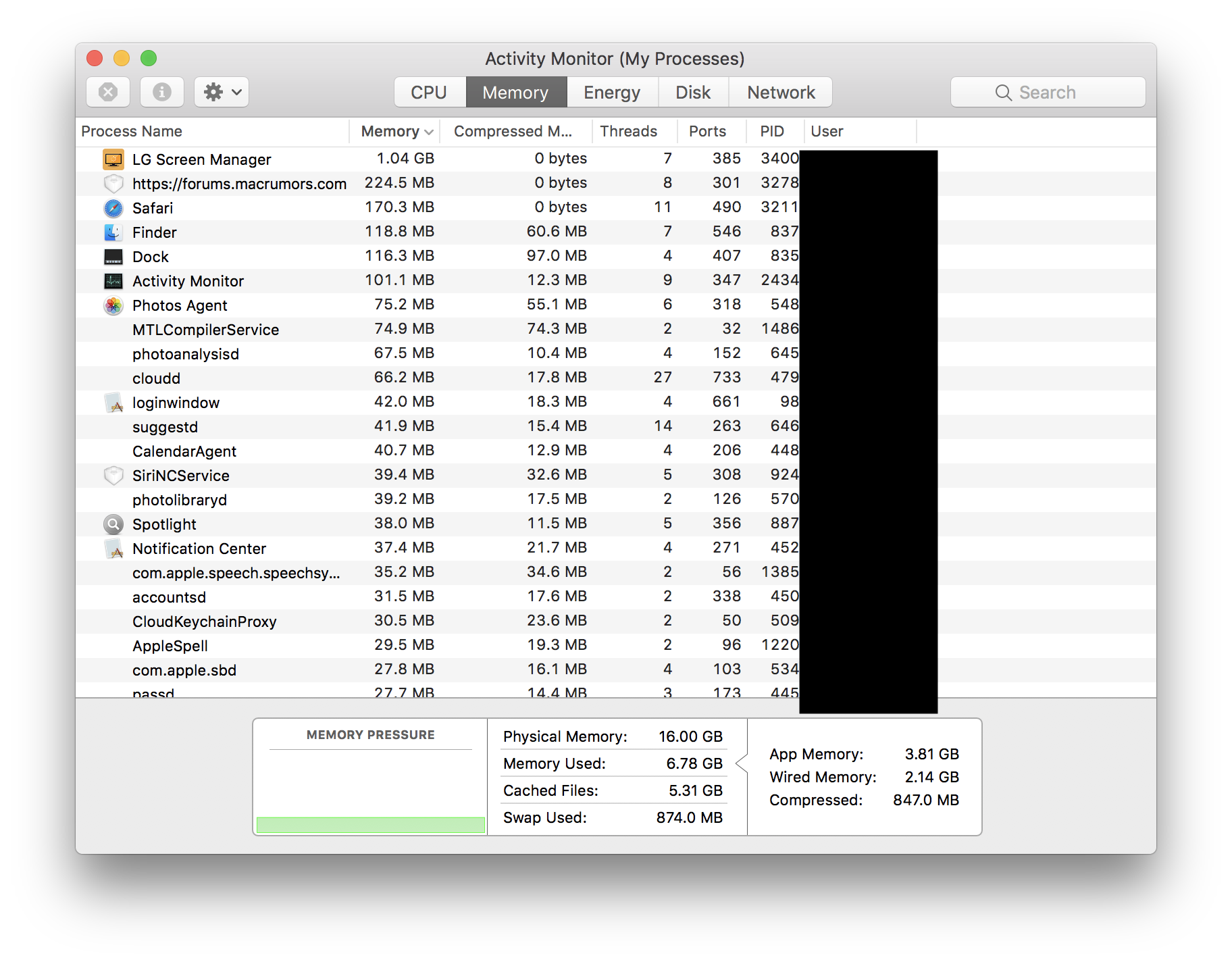

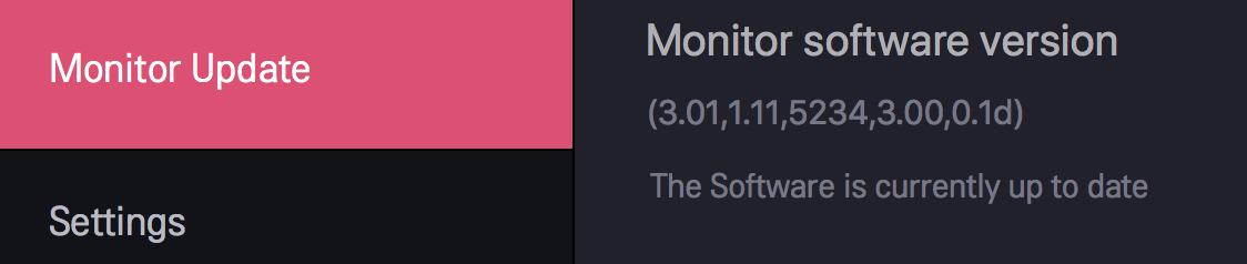

My monitor is still on 3.01 and the utility says my 5k is up to date. No firmware to download from the website. All this app seems to do is use 1 GB of memory (seriously?!) for no damn reason.

Hello everyone, I am still on 3.01,1.11,5234,3.00,0.1d on my 5K with a mbp TB 15 2016 on 10.13. Anyone know of a way to force update it?
