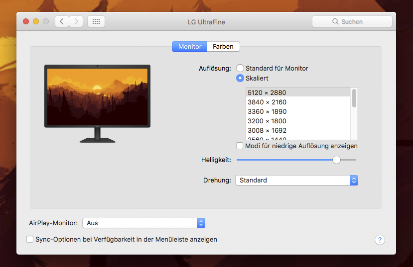

I thought I read somewhere the total bandwidth requirement of the 5k was ~28Gbit ?
You did!
The UltraFine 5K uses:
5120 × 2880 × 60 Hz × 10 bits × 3 colours = 26.5 Gbps
@fischer.vienna your display is likely running at 4K, even if macOS is reporting 5K. The same happened to another user who managed to get macOS to claim 5K was being pushed over a TB3-TB2 adapter which isn't possible.
5K displays definitely need more than 20 Gbps otherwise 5K displays would have been released two years ago alongside Thunderbolt 2.
You did!
Looks fine to me? 🙂
Looks fine to me? 🙂
As I said in my original post, macOS is reporting that resolution but the real image is not 5K. It does the same thing when using a Thunderbolt 3 to Thunderbolt 2 adapter. The interface is being rendered at the size it would be for a display that resolution, but is being displayed as a 4K image. It is simply not possible to push a 5K resolution over 20 Gbps cables, as the maths shows.

not sure what you're not understanding, its basic physics regardless of what the OS is telling you.
