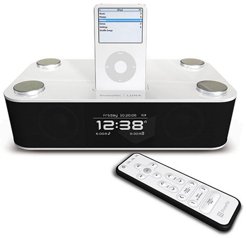

XtremeMac | LUNA
Charge - Yes
Music - Yes
Warning - Yes
